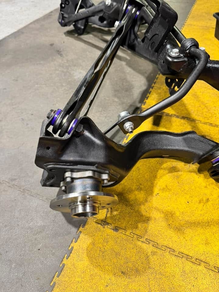

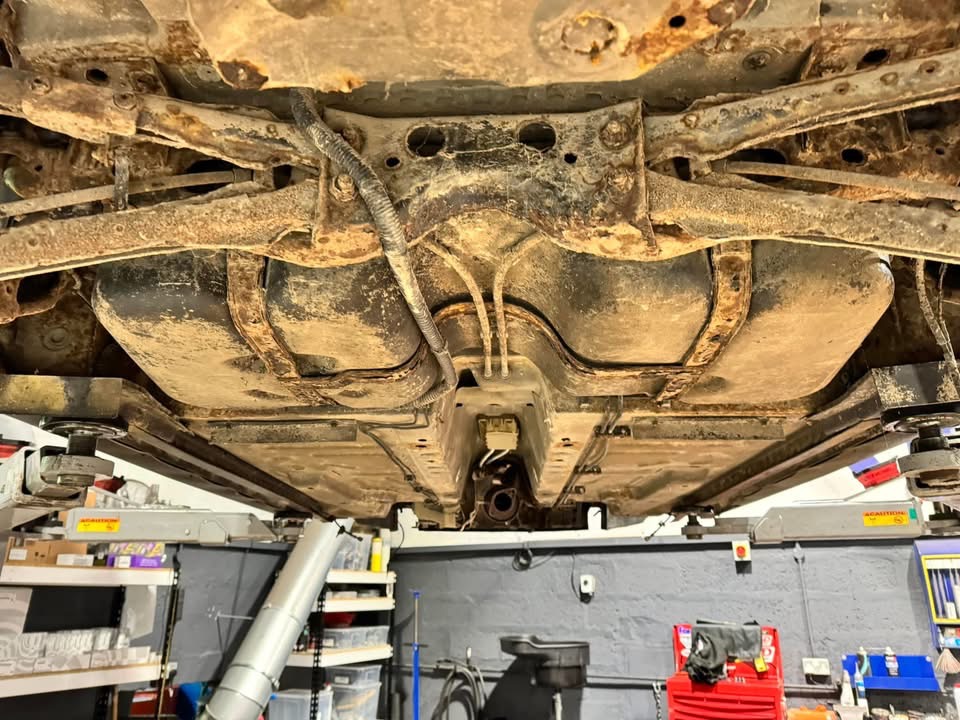

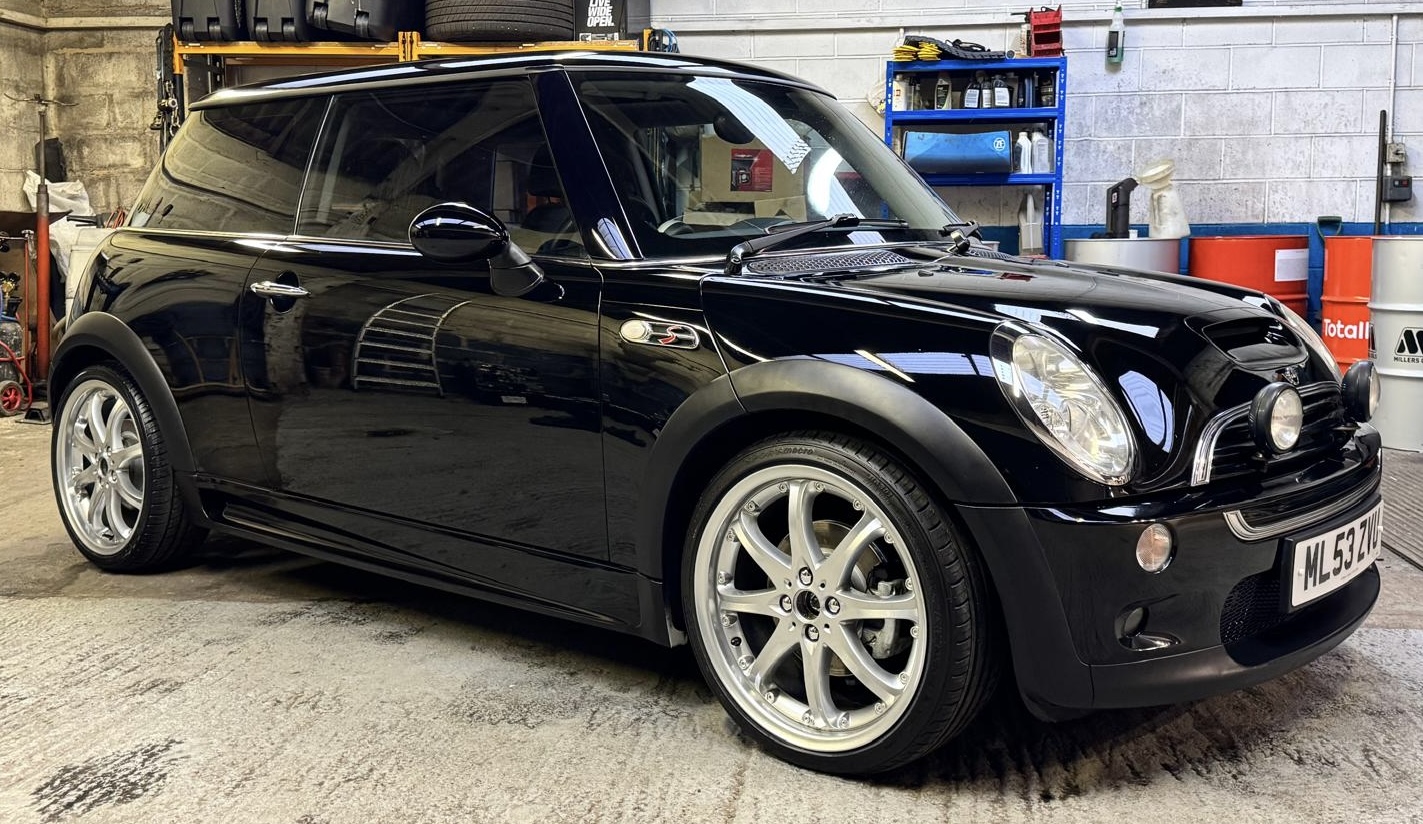

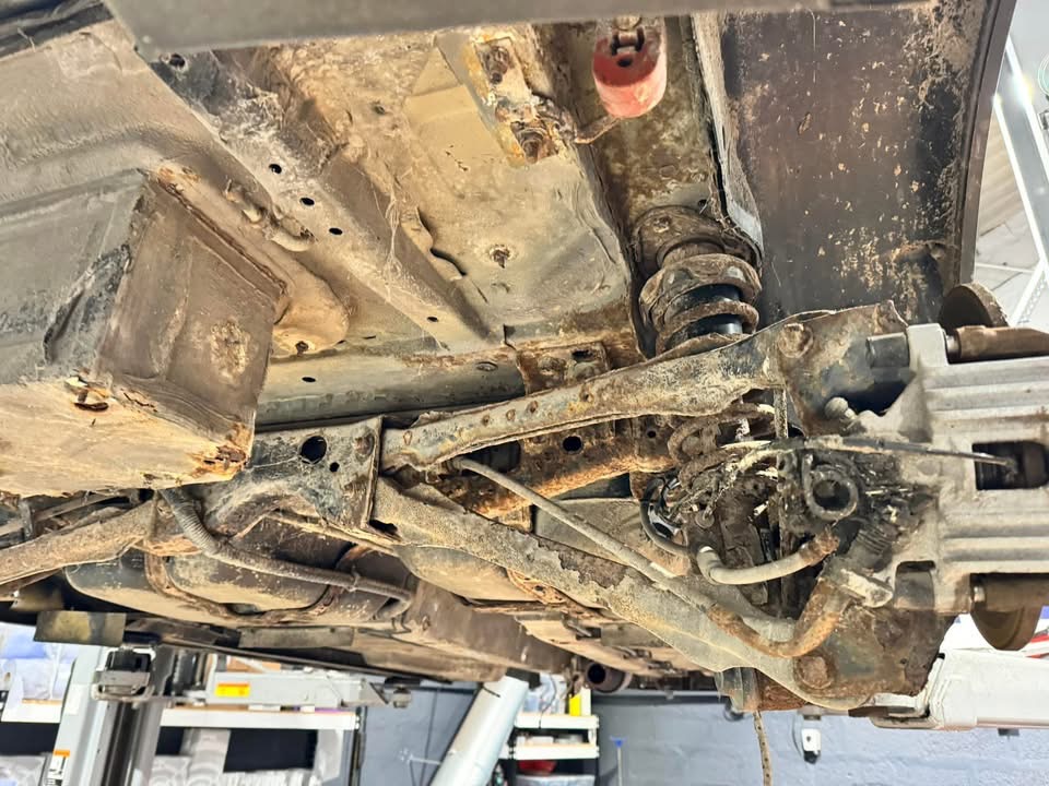

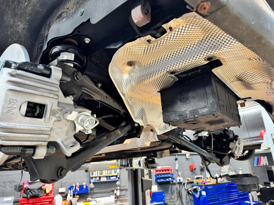

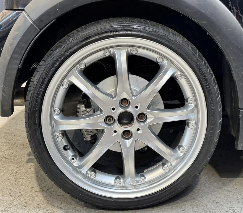

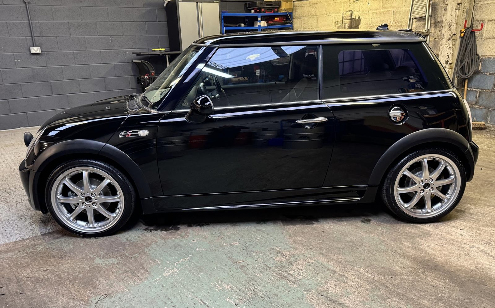

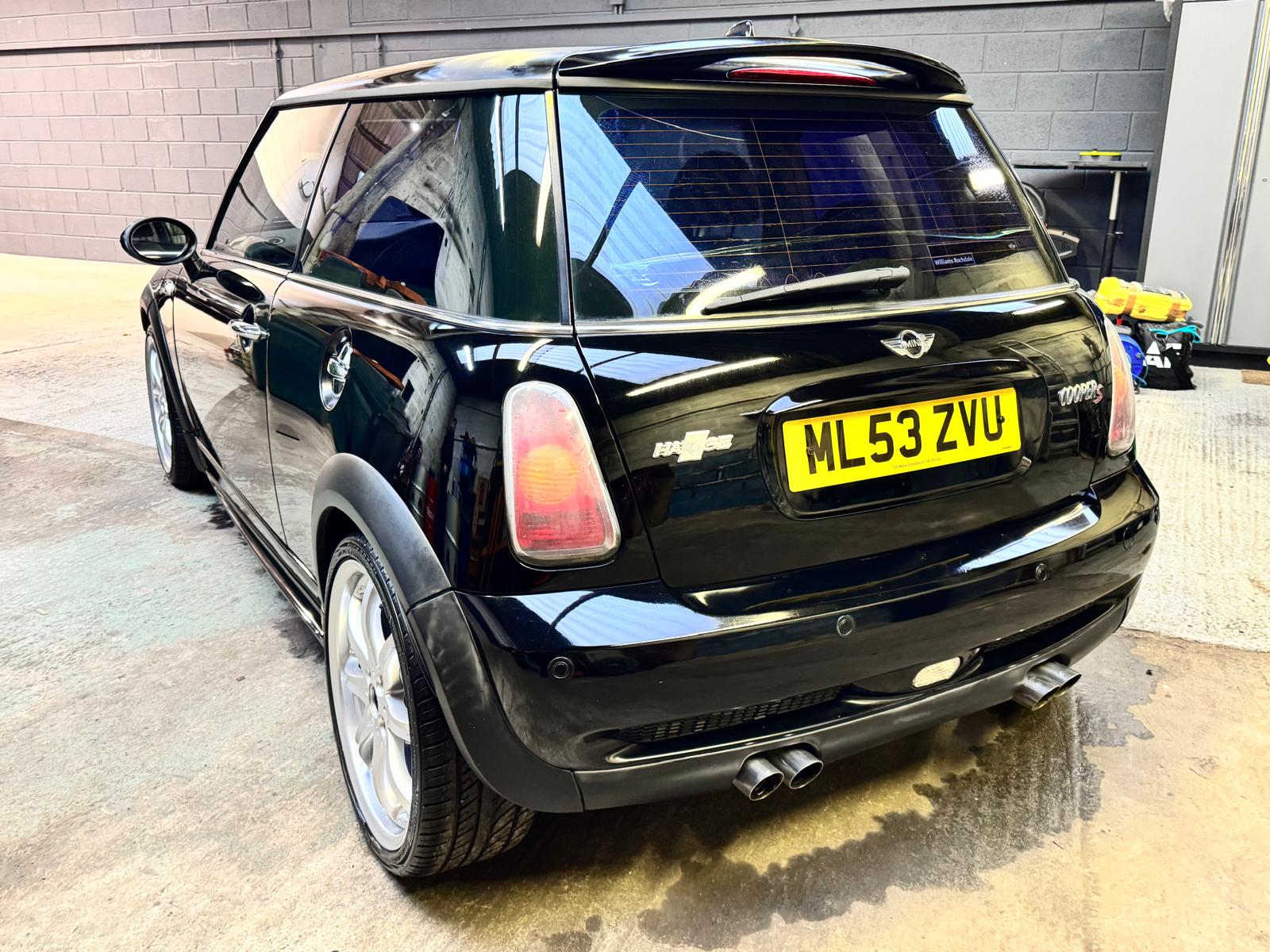

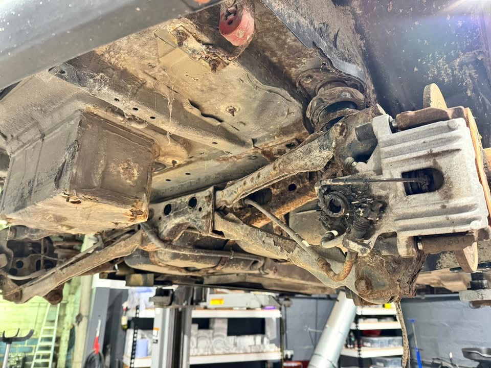

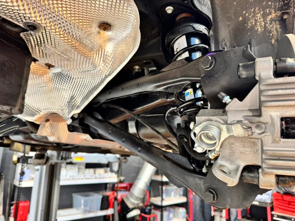

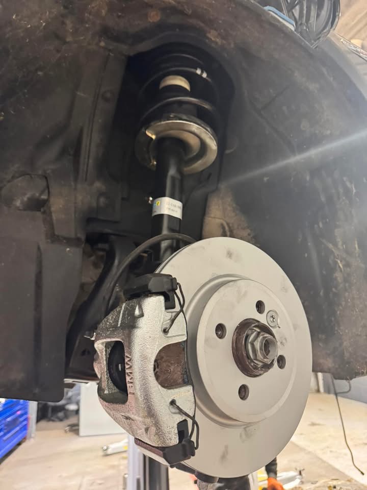

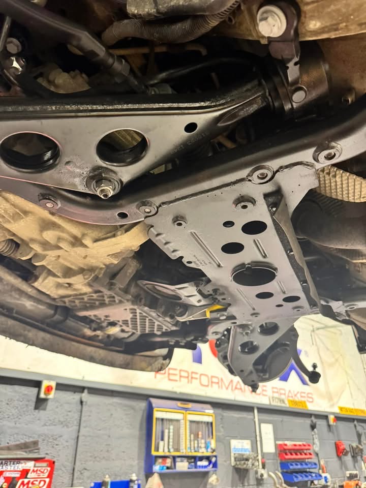

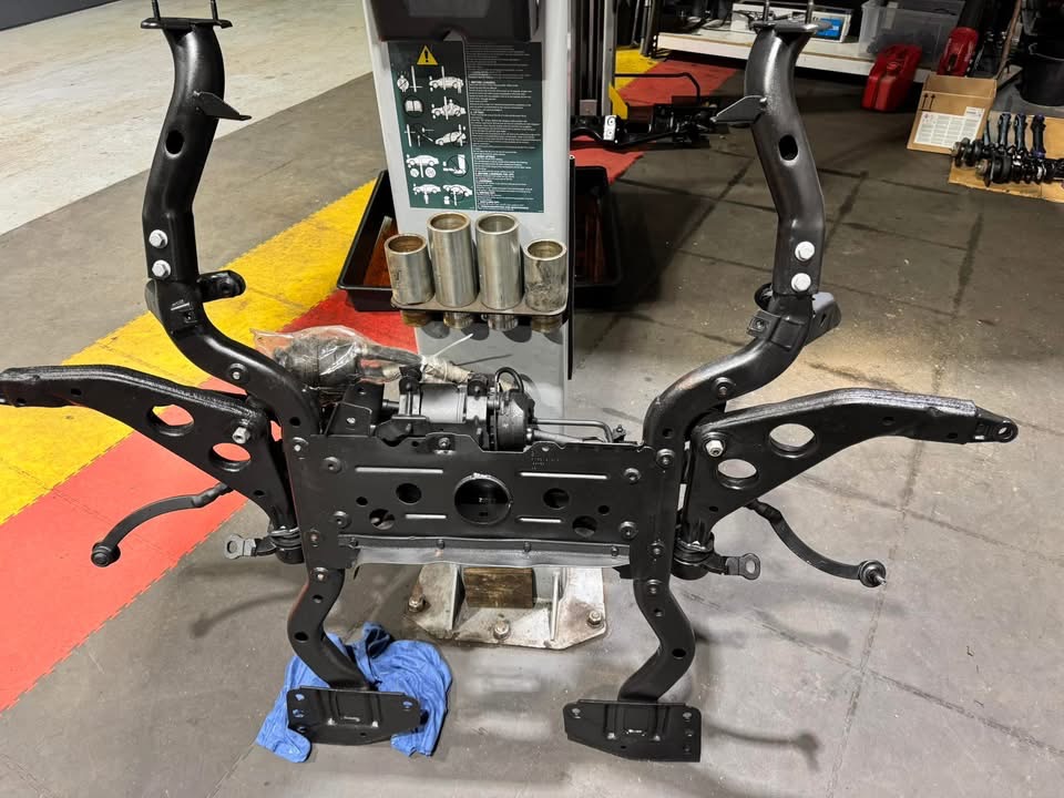

  16. We’ve owned this R53 Mini Cooper S since it was a year old. It’s 1 of 15 that had the full Hartge conversion by Birds which included the power upgrade to 230bhp, body kit, quad exhaust system, uprated suspension and 18” wheels. Unfortunately the car became neglected over time and fell into serious disrepair. We were at the stage where we had to make the decision of whether to get rid of it or go for a full restoration. Because of the rarity of the car and the fact it’s a low mileage, low owner example, it seemed a shame to let it go. So we bit the bullet and spent a small fortune bringing it back to its former glory. There are still a few minor jobs to carry out such as new rear lights, new seal on the panoramic roof and a bit of paintwork but all the major work is done. It really is a fun car to drive, bags of power with go cart handling. Hopefully there will be many more years of enjoyment to be had and perhaps an appreciating asset?.
    IMG_0310.jpeg IMG_0311.jpeg IMG_0312.jpeg IMG_0313.jpeg IMG_0314.jpeg IMG_0315.jpeg IMG_0316.jpeg IMG_0317.jpeg IMG_0318.jpeg 11e0dd39-231c-40c0-8b23-26cb3b684c1b.jpeg 2f403e75-f0b0-46a4-9bf8-034833e4a21e.jpeg ae4ea795-2032-4317-bc22-49636e6b981e.jpeg

  17. Looks great. Enjoy!
  18. where did you get the underbody work done
