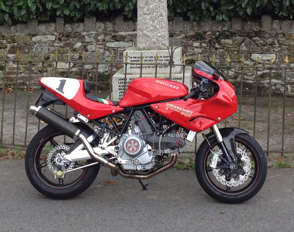

    I knew I had a picture of Paul’s bike somewhere.
  8. Wow, that’s quite a list...
    No expense spared.
    So basically because it’s highly modified for lightness rather than any great inherent difference.
