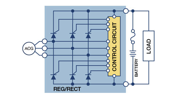

  13. And what about using the Shindengen SH847 regulator? This is a series regulator that controls the output voltage by limiting the current from the alternator, thereby reducing the heat dissipated in the regulator and in the stator through magnetic losses. So much less heat and a better life for the stator.
  14. No Derek. Could you explain the thinking behind this "through magnetic losses".
    The trouble is the Stator has already made (collected) the energy, and as you can see the only thing this control circuit is doing is "shunting" or conducting to dissipate the energy as heat.... if it doesn't the stator gets really really hot..... If the black box (yellow in this instance) isn't shunting the stator will get very hot.
    For those doubters among you, try removing just one wire from the Stator.......
    You'll find toasty bits in your oil as the insulation burns off the coils.
    Perhaps they think, oh well it's in a bath of oil, what's the worst that could happen.
