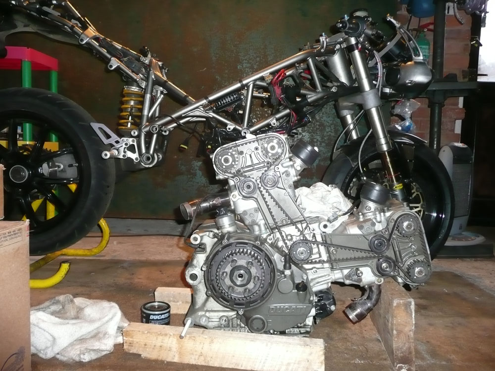

  1. You can leave the swingarm in place (put the bolt back through the frame) and have a rolling chassis.
    Here's a pic of mine some years back;
