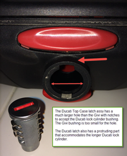

  2. Did some research on this to try and find a lock cylinder bushing to use my lock with a used Ducati top case I purchased on eBay for my 2015 1200S. Here's what applies to Givi.
    Ducati Top Cases are made by Givi, but . . . the Ducati Top Case has a different lock cylinder than the Givi case. The Ducati latch has a much bigger hole with 2 notches that match corresponding protrusions in the Ducati lock cylinder bushing (plastic part the lock cylinder is inserted into which in turn is inserted into the latch). The Ducati latch also has a boss that protrudes from the latch that the Givi latch does not have. The Ducati lock cylinder bushing used in the top case is the same one used in the panniers and the seat lock.
    Givi makes 2 lock cylinders standard and security. The Givi standard lock cylinder is very short and nothing like the Ducati cylinder. The Givi Security Lock looks similar to the Ducati cylinder but is shorter (I purchased one to try).
    I did not research in depth but it may be possible to replace the Givi Top Case latch assembly with the Ducati, assuming the 1260 and 1200 use the same case.
    2014 MTS 1200 GT Top Case Latch Assy PN 96700710A (Ducati nomenclature UPPER HINGE (Unit)) Approx US$45.00
    As an aside for anyone trying to find a lock cylinder bushing to use their Ducati lock cylinder; the seat lock cylinder can be purchased by itself, bushing can be removed and used for Ducati top case.

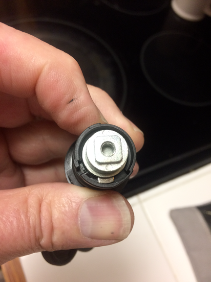

  4. I've got a couple of pics of the Ducati case and lock cylinder.
