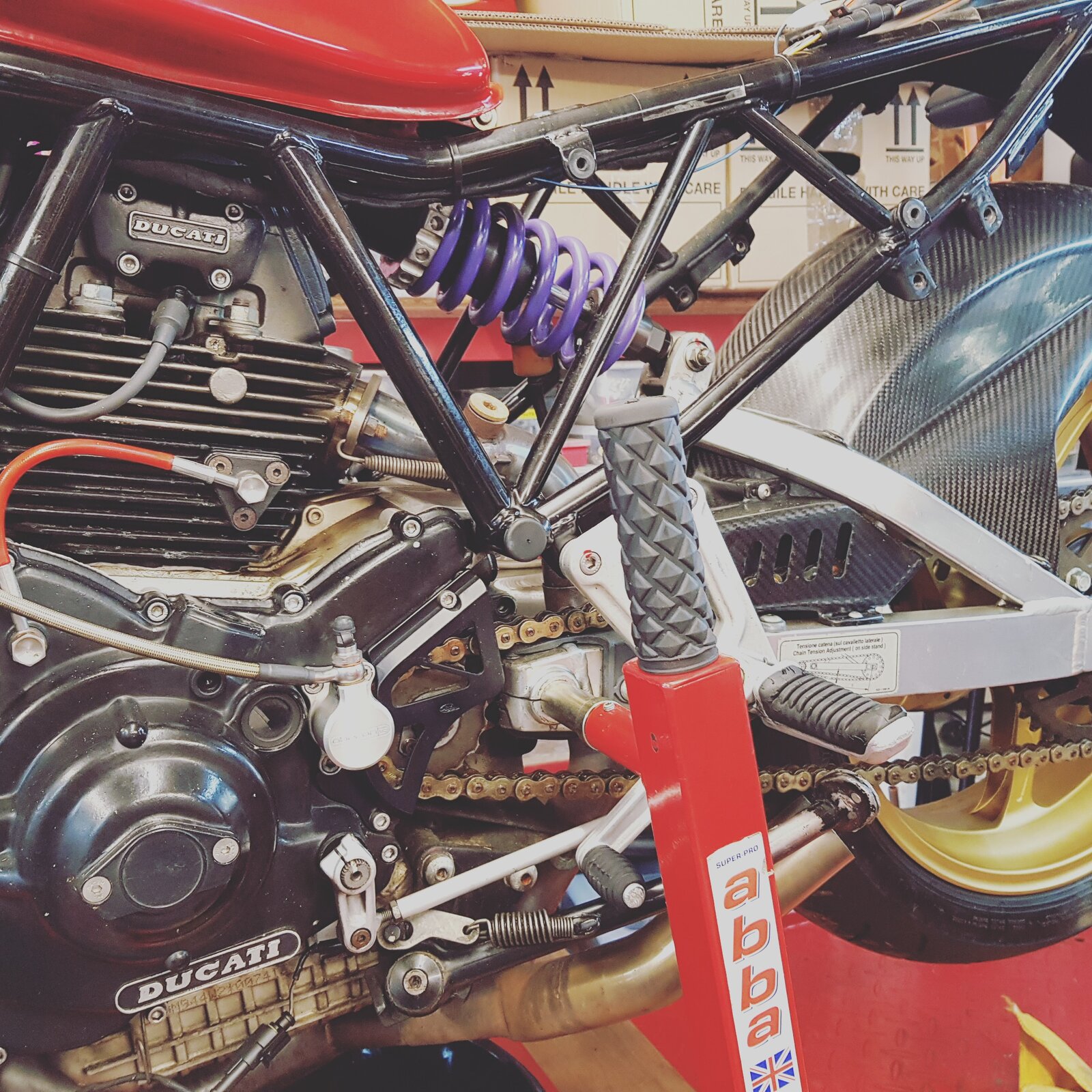

    Decided to write if this year for the SS. She's been hibernating since last year, and so I'm keeping her off the road and planning my modifications earlier than anticipated. So, started today getting it part ready to drop the engine.
    Planned mods include fitting the Bruce Meyer Pistal 94mm pistons, ST2 barrels, ST2 camshafts that I have, to get it to 944cc. I have a hall effect sensor to fit, Dyna coils and leads. There's also a 748 gearbox sitting in my garage.
    I may have a good few other things to do, there some wiring needs updating, and the motion Pro cables are being replaced with a kit from Venhill as the throttle cables I've never been happy with. I'll run my Multistrada 1100S only this year, means I have just under a year to do everything, which should be enough so it's ready for next spring.

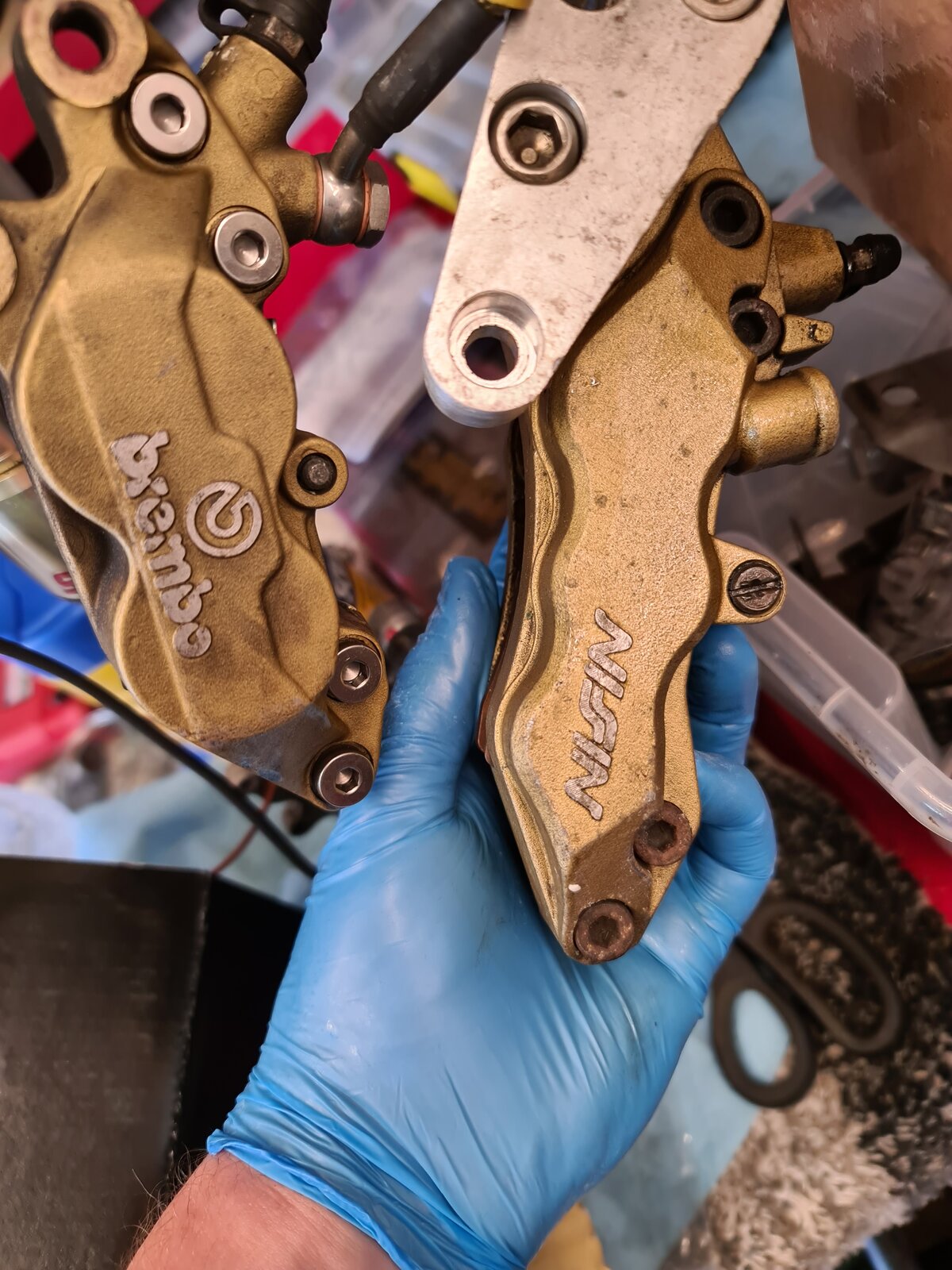

  17. I've made a little progress, sent my barrels and heads to Blastworx and here are the results below. I also did some research on upgrading the calipers. I have bought a set of 40mm spaced NISSIN 6 pots and over on Facebook I've had a fair amount of negativity towards them, with some thinking it's a downgrade. They are meant to be very good, and fitted to the MV Agusta 750 F4 (although different mount spacing) Ive gone this trial route cause they are straight swap. Has anyone used them before? Bikes off the road so I can't actually test it till next year 20200618_134811.jpg 20200615_202431.jpg IMG_20200614_102038_205.jpg
  18. Good man, plumbing is for central heating and the like, not real motorcycles :cool::joy:
