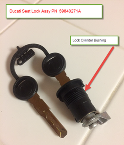

    Here's the article I read claiming that the Ducati under seat lock assembly should be able to house the spare Ducati lock and then fit into the Givi top box. The article relates to a Multi 1260 so not sure if the part codes for the seat lock assy would be the same as Multi V4... I guess a call to one of Ducati's dealer parts teams could identify the black plastic seat assembly part code...
    https://www.ducatiforum.co.uk/threads/lock-replacement-on-stock-givi-topbox.69536/\
  10. Ah. Sadly not. Close up, the lock clasp mechanism for the V47 looks different from the MS1200/1260 optional top case. May fit the E460, though...
  11. The related thread I posted above just talks about replacing the black plastic cyclinder lock bushing (the same as the one on the seat lock)... not the whole clasp mechanism
  12. Understood. I was looking to see if I could swop everything over, that’s all. But your point taken
  13. Thanks for sharing this - the parts have changed ...
    2019 1260 Seat Lock is 59840271A
    2021 950 and V4 and V2 Seat Lock 59820611A
