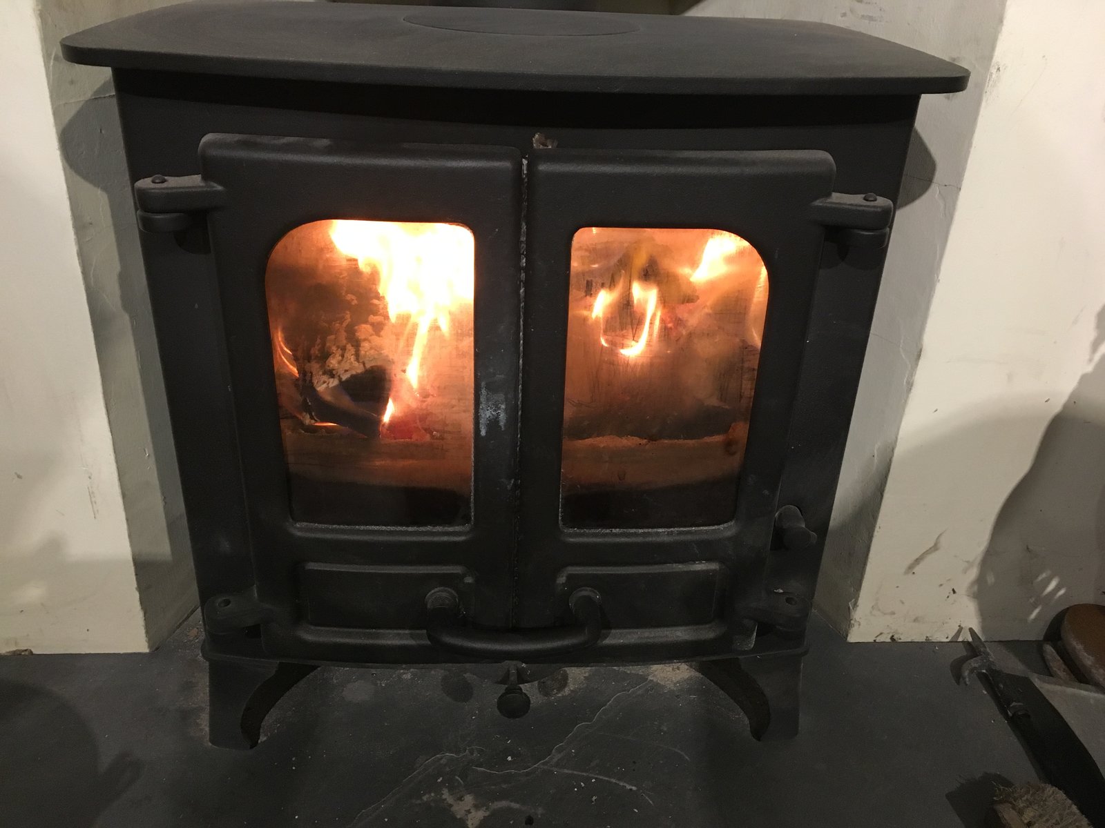

  18. 7A59A382-995A-4CBE-B9B8-4B83AFA11222.jpeg Charnwood island 1 in action, lovely!
