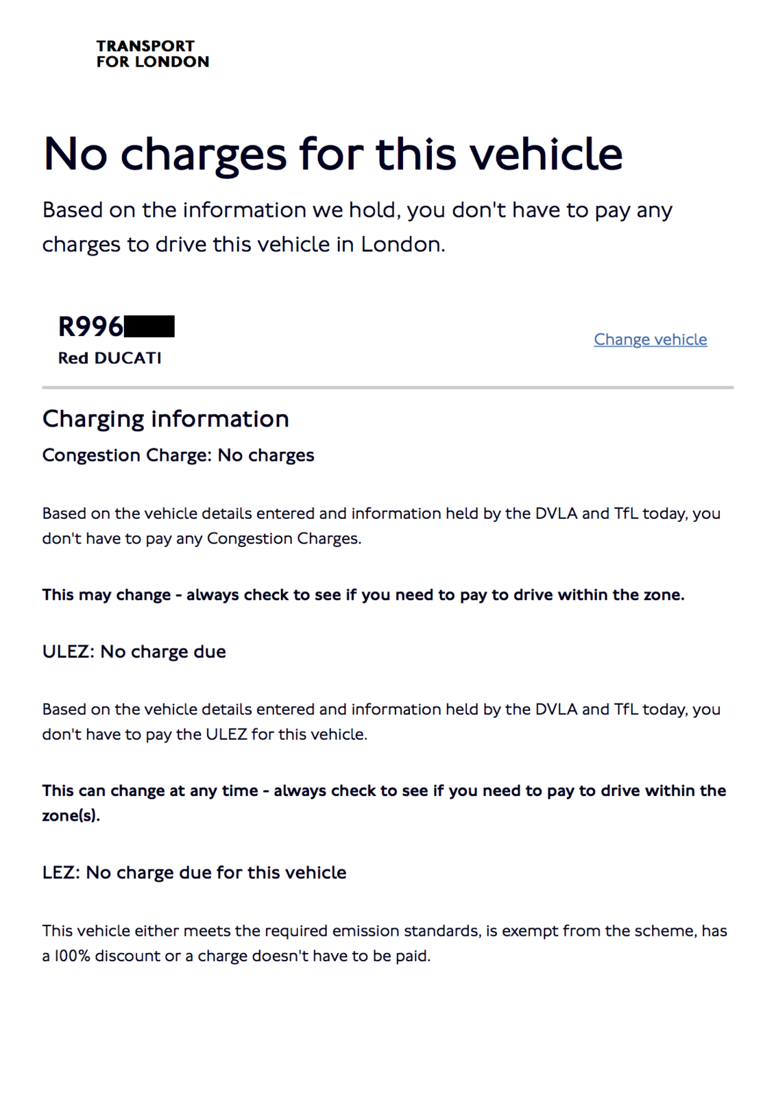

  3. An update/clarification
    The next step is that the info about the bike is entered on the TfL database; however this does not mean that it will straightaway show up as exempt using TfL's ULEZ checker here.
    Instead, one must go to https://tfl.gov.uk/modes/driving/pay-to-drive-in-london, register, and then offer to pay a charge for the relevant vehicle. You will then get a page like the one below.
    At some point TfL should write to the registered keeper confirming that they have received a satisfactory test result, but in the case of R996 *** they haven't done so yet (tested 24/05/19). I think (if I understand correctly) that at that point the vehicle should then be shown as exempt on TfL's checker. I'll update this thread in the light of developments.
