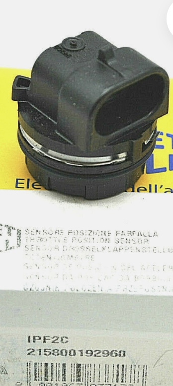

  3. You need to identify which model of TPS is fitted to the throttle bodies
    IPF2 ?
  4. sure, thankyou @chrisw , that'll be a petrol tank and airbox off job I guess. Thankyou, I will come back on once I have made a step forward. Its late here in NZ. Thankyou
  5. Just use Google
  6. Thankyou @chrisw , yes, that is exactly the same as the one I have. So now what do we do with that information please? Cheers
