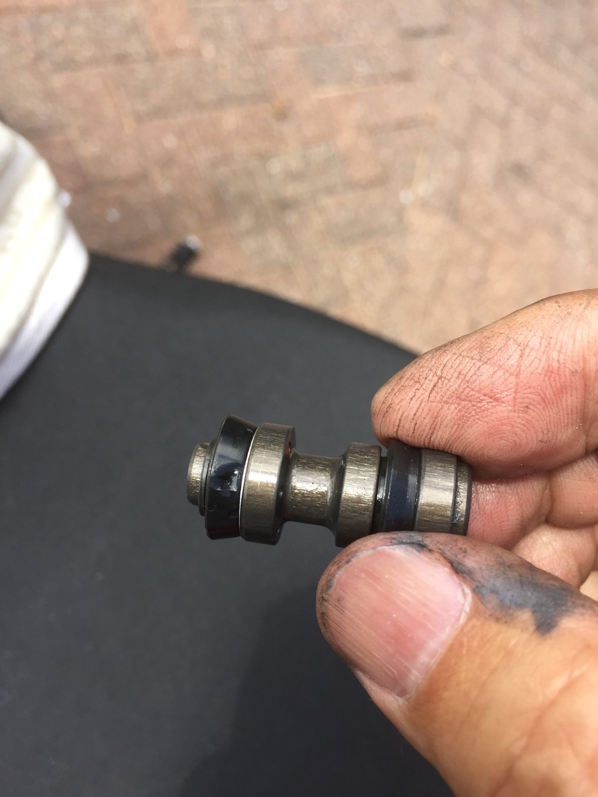

  1. E5947367-DA37-47D6-AFEB-D8920855CDD8.jpeg Having a bit of a mare getting hold of some Brembo seals for my 899 clutch master cylinder, I’ve been told that Brembo don’t sell a clutch seal repair kit, I only need one poxy seal to sort this problem , you can see from the above picture that there’s a tiny pin hole through the front seal and I’m losing clutch pressure when I’m trying to hold the clutch in.
    I need Brembo seal number 05426374, it’s 16mm o/d 8mm bore and 5 mm thick.
    Everyone I’ve tried don’t seem interested, they only want to flog you a master cylinder for £240
    Which is a total rip-off when it’s one tiny seal that’s giving me grief.
    Anyone have any contacts, ideas, suggestions etc......Help !!!
    Poucher

  10. Hi All,
    Icssiculo thanks for your effort but I’ve made a breakthrough today at Teessdale motorcycles at Thirsk, basically I’ve had a good rifle through there Spareparts and found the exact replacement seal kit for just over 20 quid !!
    When I pull it all apart again I’ll do a full write up with pics so it’s crystal clear what KTM part no’s you need and some tips on how to rebuild it and get all the springs and seals back into the master cylinder.
    Today I feel like I’ve made some progress !!
  11. Puoi farmi sapere le misure del cilindro? 15x?
  12. Yes, it’s a 15mm bore cylinder I think that’s what you’re asking, it’s all fixed now though.

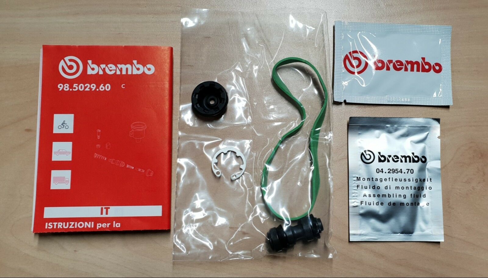

  14. Folks, Ducati may not include the kits in their parts book but they do kits for some of them including older versions like the 851. Ducati 749/999 clutch masters have a 15mm bore and the kit is available using part number 61041991A, Brembo part # for the kit is is 98502960 available from Ducati dealers at around £37. It fits the following including 899 (caution this is a 15mm cylinder not the 16mm claimed in the OPs first post) Following is C&P from Moto Rapido
    • 2009 - 2010 Monster 1100/S
    • 2014 - 2019 Monster 1200/S
    • 2016 - 2019 Monster 1200 R
    • 2006 - 2008 Monster S4R/S (Testastretta only)
    • 2011 - 2019 Diavel/Diavel Carbon
    • 2016 - 2019 XDiavel/S
    • 2008 - 2009 Hypermotard 1100/S
    • 2010 - 2012 Hypermotard 1100 Evo/Evo SP
    • 2010 - 2014 Multistrada 1200/S/Touring
    • 2015 - 2017 Multistrada 1200 DVT S/Touring
    • 2018 - 2019 Multistrada 1260/S/Touring
    • 2016 - 2018 Multistrada Enduro/Pro
    • 2012 - 2015 Streetfighter 848
    • 2010 - 2013 Streetfighter/S
    • 2003 - 2006 749/S/R
    • 2003 - 2006 999/S/R
    • 2008 - 2013 848/Evo/Evo Corse SE
    • 2007 - 2009 1098/S/R
    • 2009 - 2011 1198/S/R/SP
    • 2014 - 2015 Panigale 899
    • 2016 - 2019 Panigale 959
    • 2012 - 2014 Panigale 1199/S/R
    • 2015 - 2017 Panigale 1299/S
    • 2015 - 2017 Panigale R
    • 2018 - 2019 Panigale V4/S
    The part number for 851 version is 000047226 for around £25 or Brembo part #98502970 which fits the following
    • 1990 - 1990 851
    • 1990 - 1993 907 ie
    • 1993 - 1997 Supersport 400
    • 1991 - 1997 Supersport 600
    • 1991 - 1997 Supersport 750
    • 1991 - 1997 Supersport 900 (only bikes equipped with integral fluid reservoir - up to chassis number 012262)
    I suspect the £20 KTM service kits have the same bits in them, just need to work out what the KTM equivalent part number is unless they just use Brembo numbers. The 851 clutch master is the same as those fitted to a KTM125SX FWIW

  15. ^ Many Thanks Denzil, should be a sticky in Technical info or equiv unless already listed there.
  16. for info these are available from Ducati now part number 61041991A
