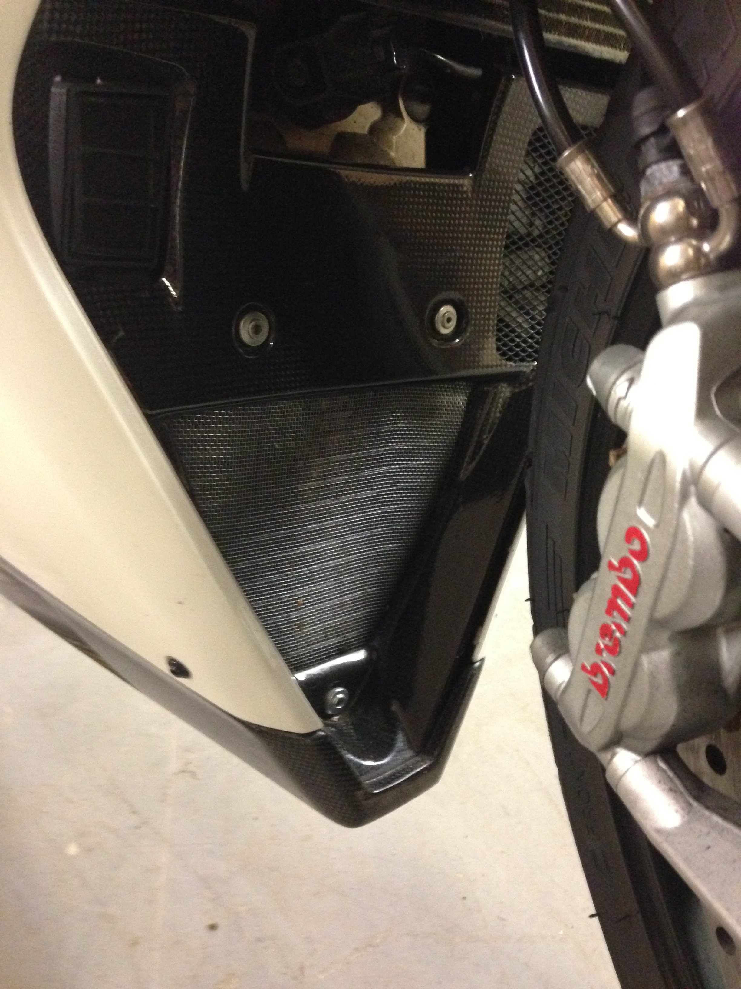

    I have an issue with my 1098 in that the lower fairings seem out of alignment so that looking from the front behind the wheel there is a bit of a gap between the v panel and fairing on one side and on the other side it sits nice inside the lip of the fairing if that makes sense
    Is there any brackets that are adjustable to compensate for this ? as it has rubbed away a bit of the paint on the standard red v panel and I have replaced that for a carbon one and don't want the same happening.

  3. Hi , the gap is on the left hand side edge and on the right hand edge it is sitting inside the middle fairing as it should
    I've no hoses etc fitted and everything's tight and seated as its the first thing I checked.
    perhaps I can elongate the holes on the new v panel and adjust it that way and would probably be the easiest solution but if you push lightly on the side fairing it moves slightly and fills the gap and all looks good but as soon as you let it go then it springs back out.

    The gap is around 3mm which doesent sound much and if I didn't show you it then you wouldent notice but it really bugs me.
    Its like the v panel is just hanging on inside the fairing and a bit of pressure will dislodge it then you can tuck it back into the fairing again.
    The right hand side fairing has a solid alloy bracket to align and fasten the panel to however the left hand side is only connected via a clip onto the battery tray bracket, also the bike has been down on this side as there's a few grazes on the water pump cover so I think ill start on that mounting point and see if its been bent inwards.

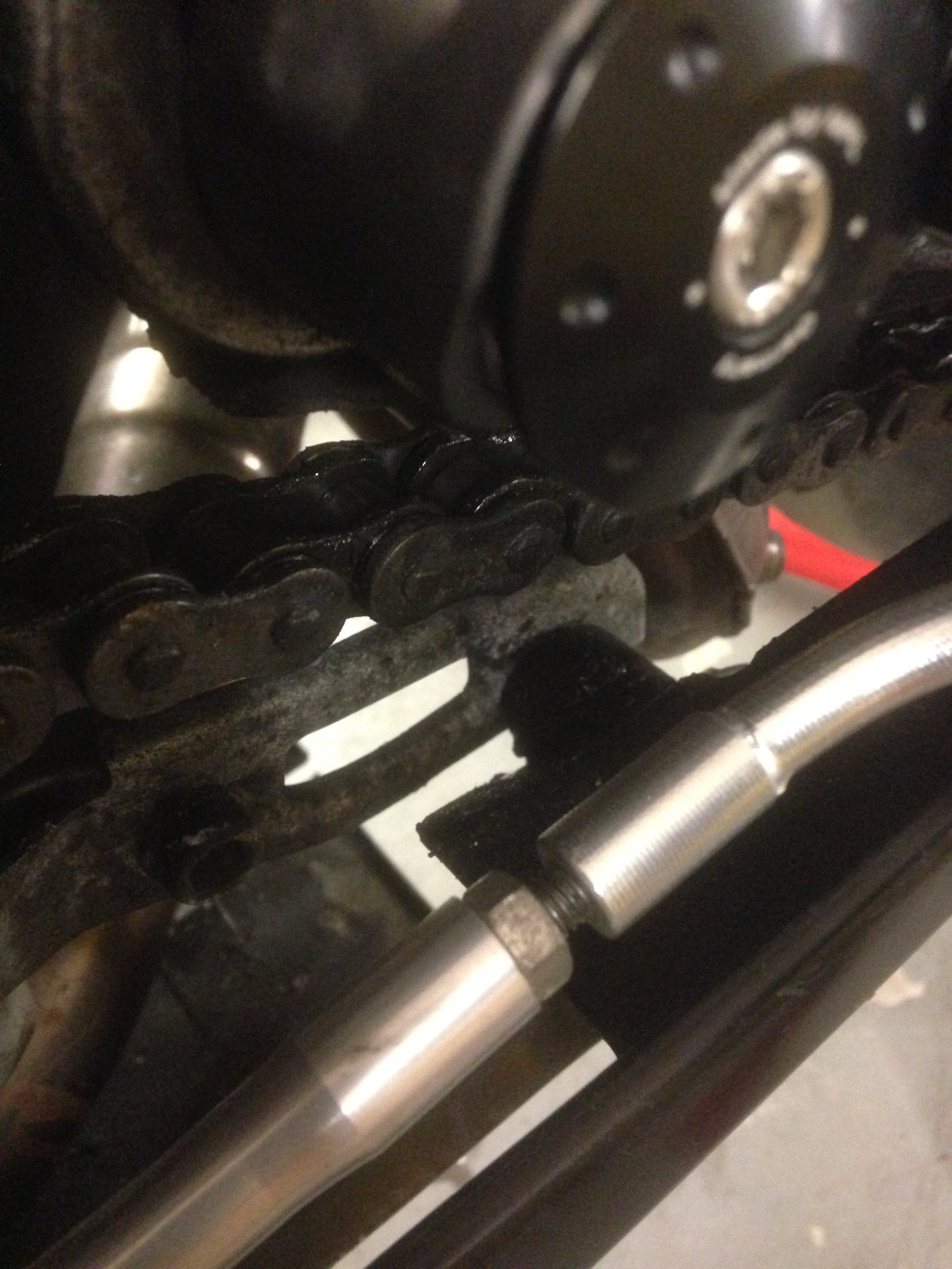

  9. looking forward to seeing how this one ends. mine's exactly the same, loose V piece, scraped water pump cover and the pointy end bit of the L/H belly pan is touching the swing arm. the bracket there probably just needs knocking out a bit.

  16. ok. the bracket holding the l/h belly pan at the back is made of very thin sheet steel and can easily be pulled outwards to clear the swing arm.
