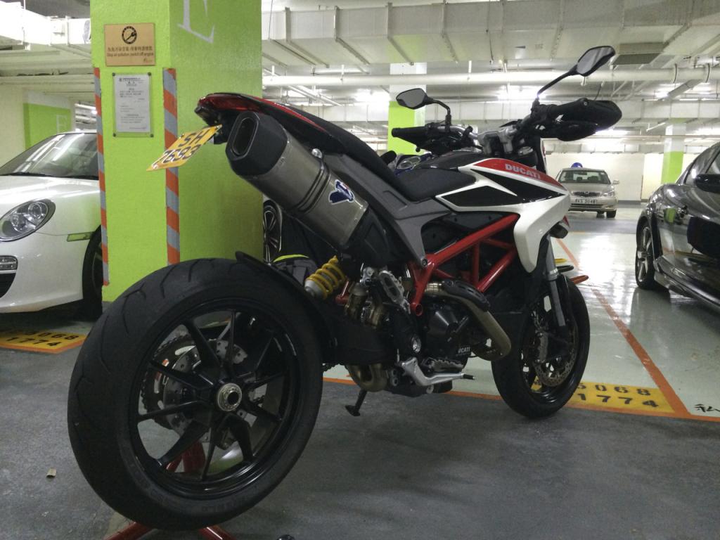

    couldn't fit on the 'sp' either so i purchased a red one, put on lower seat and sprayed it up!! the up map that comes with the termig pipe makes it even more fun than the standard 'sp'!!

  4. Dave, I'm 5'10" and my Ducati dealer also said I would get used to riding with only 1 foot down. Love my 2013 Hypermotard ... so much fun to ride. I never got used to riding with just one foot down though. I had KFC Racing replace the rear mono shock to lower the seat height from 34" to 32" and also moved the front forks up in the crowns by 1 inch. Also changed the oil from 5wt to 7wt in the forks and now it doesnt dive so badly when grabbing the front brake. At first glance you can not even tell I lowered the bike and I now can put both feet down flat on the ground at a stop light. SO MUCH BETTER!
