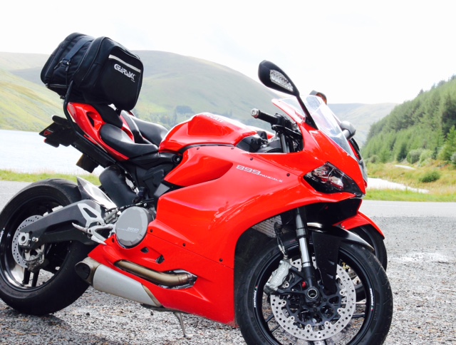

  2. I've used this Jofama unit over the rear seat on a number of foreign trips. Rear straps connected to the rear number plat hanger, front straps to the front footrest holders. 42 litres so plenty big enough. Seemed fine and stable at over 120mph. i used plenty of non slip webbing to stop it marking the seat unit
    Not a great picture but you get the gist

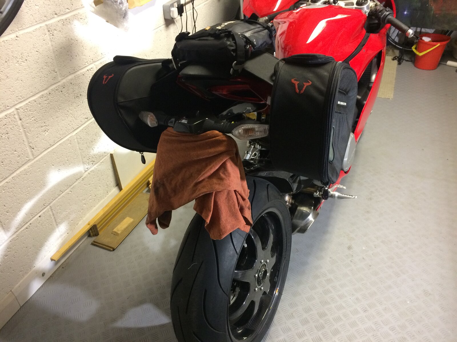

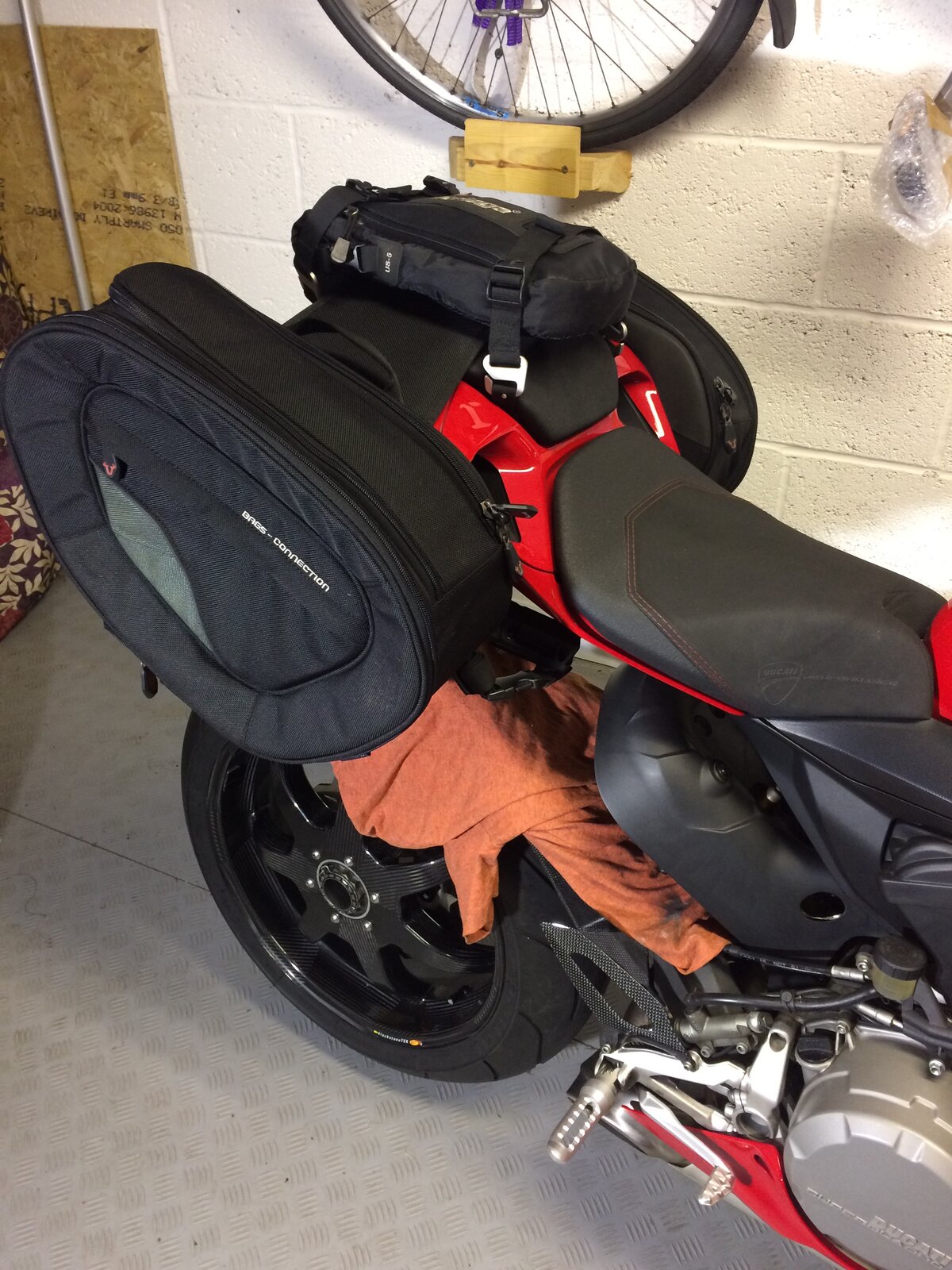

  4. Bought these from this here parish in readiness for Forum gathering in Wales that C-19 scuppered. So not used yet but happy with size & fitment.
    SW Motech Blaze panniers.

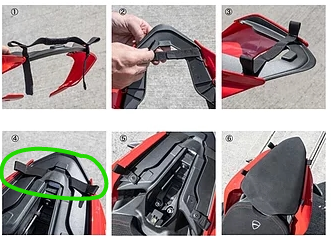

    I'm not knocking Kriega at all, it's great kit and I've got all of the dry bags but on the V2 they are very limited in how they can fit the straps.
    I found the strap at the back wouldnt sit straight as shown in the fitting instructions here
    And once the front straps were on too the seat was quite hard to slide on and off. Just dont like the fit.

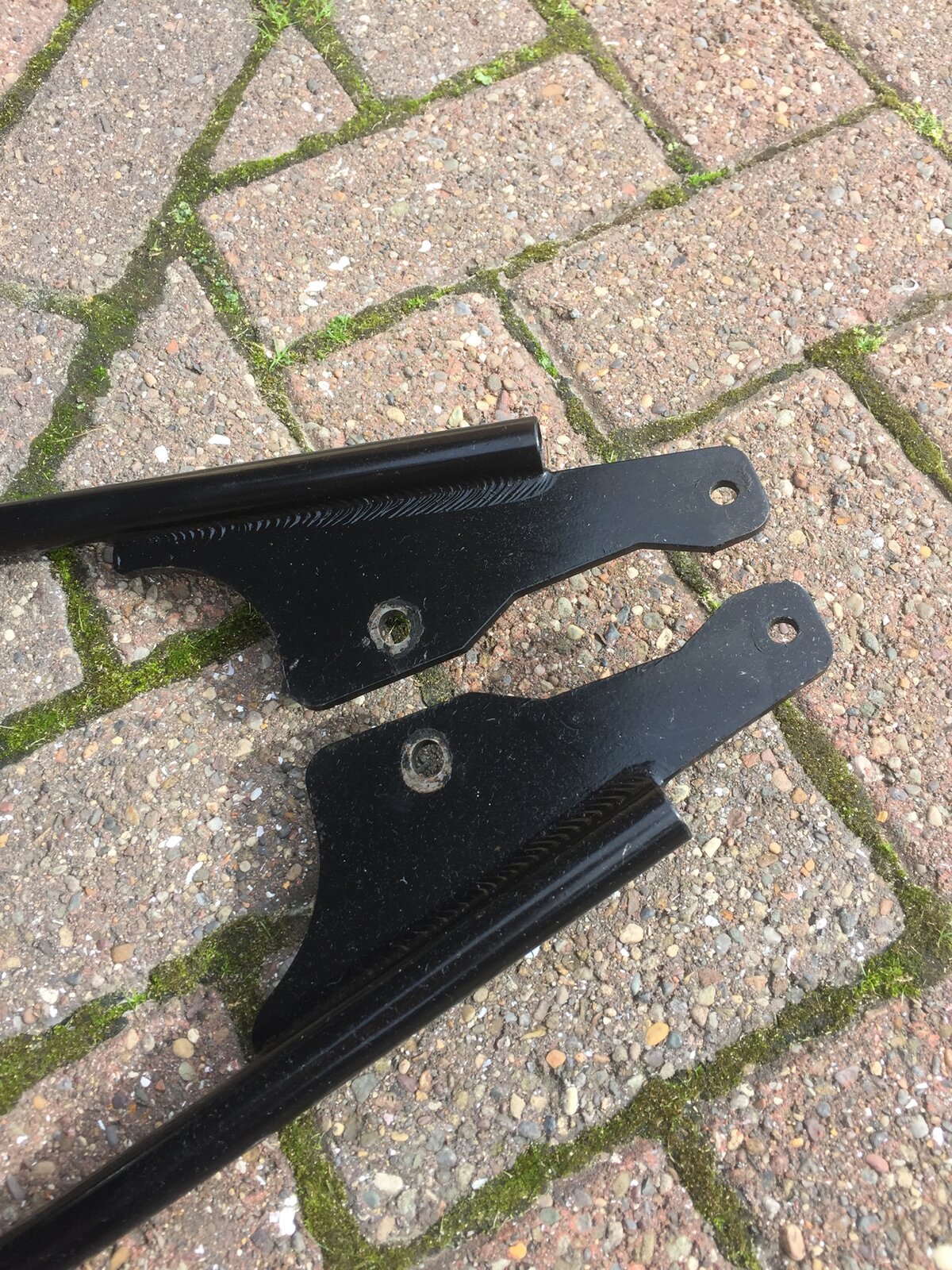

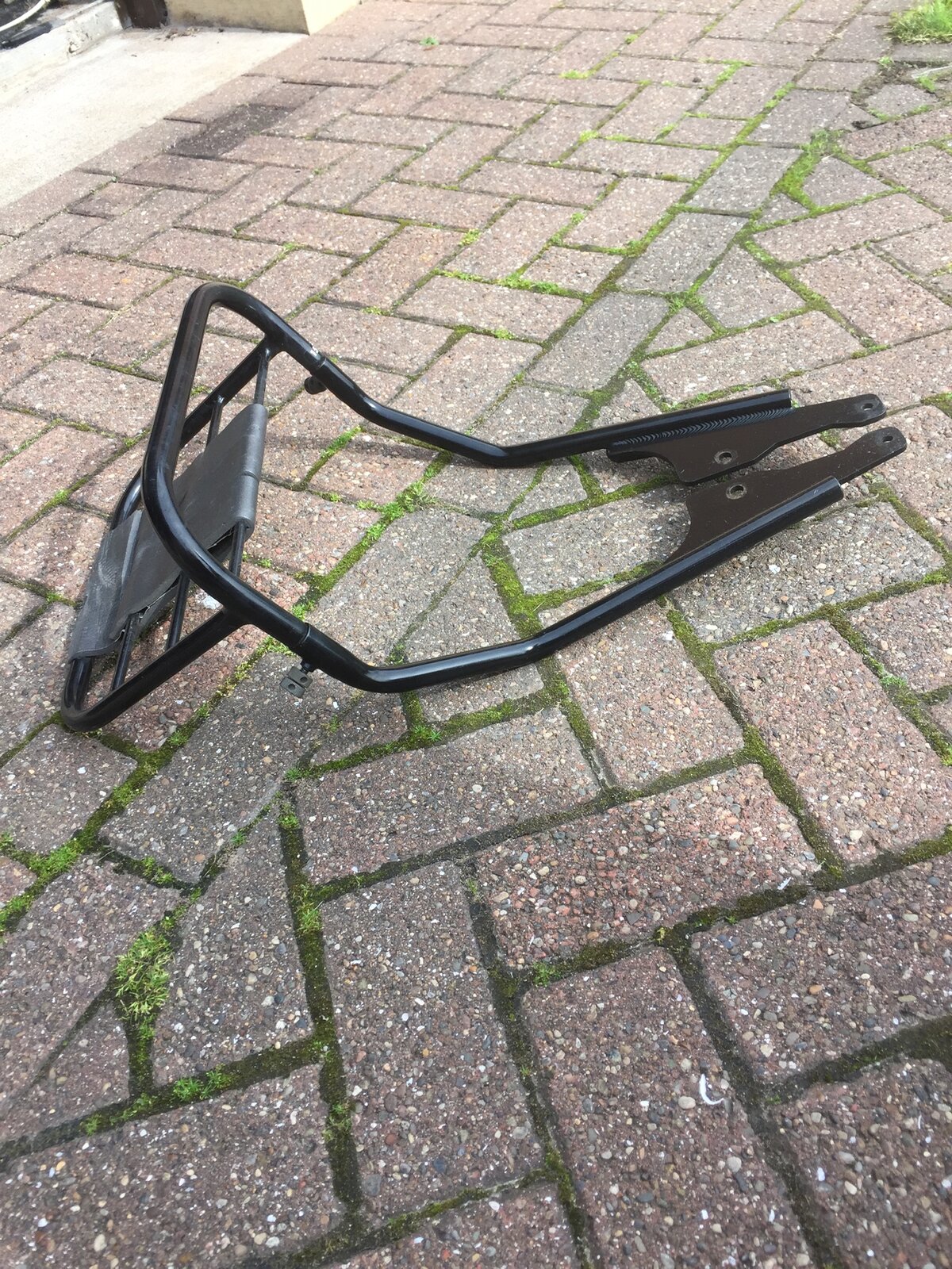

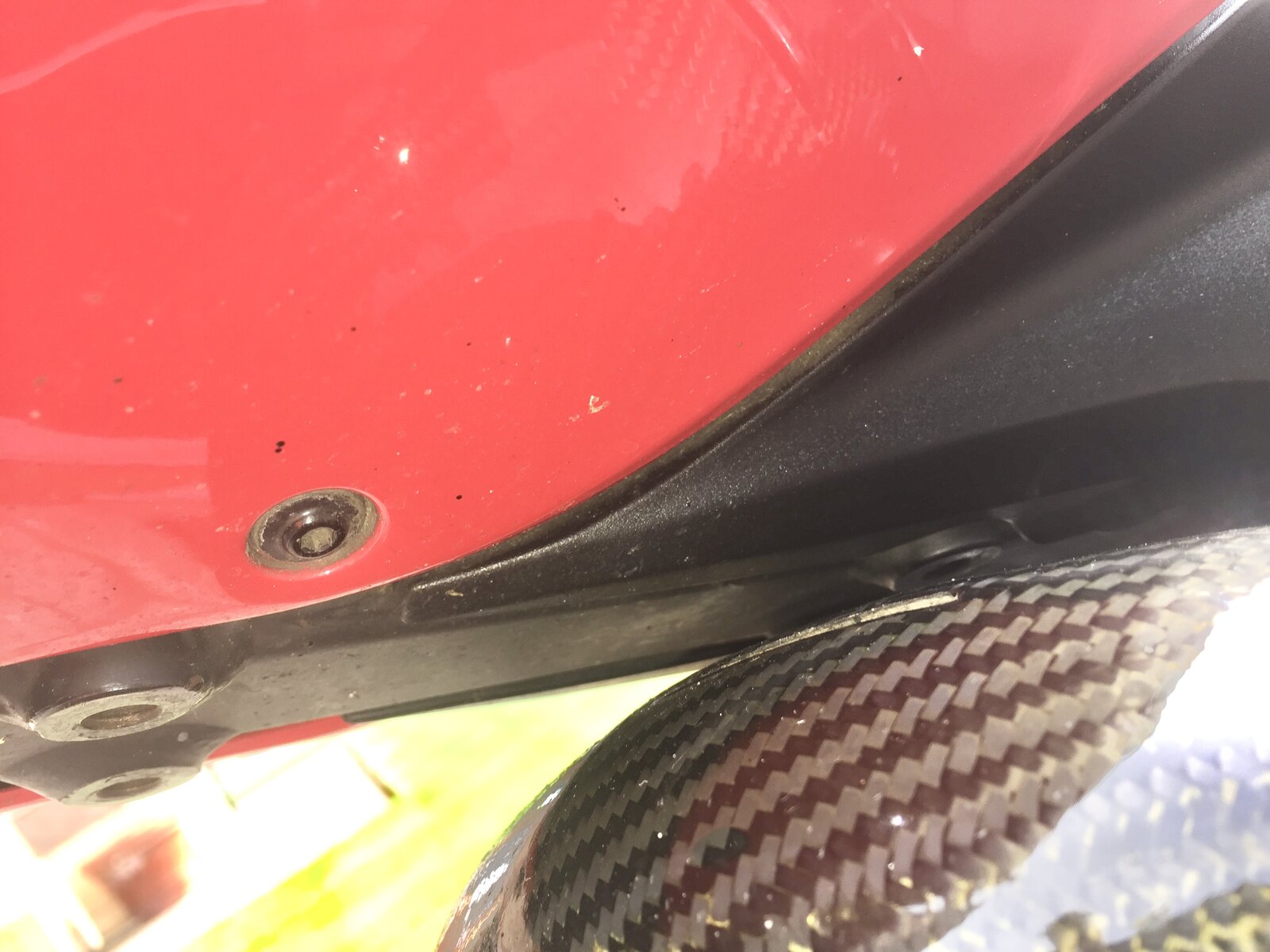

  16. Veetoo,
    Here you go
    I got the shorter sports rack so I can bungee any waterproof bag onto it, I put the pillion seat on the bike when I use the rack, the grey foam padding you see on the rack almost touches the seat, so when you go over a bump the rack is supported by the seat.
    I wouldn’t use it with the seat cowl as it may “tap” on the top of the seat cowl and mark it
    These mounting holes match up with the screw holes where the pillion pegs came off
    Rear mounting hole on left hand side, front mounting hole is just above the carbon fibre heatshield, it’s a bit fiddly to get this one in as the Allen key has to go through a hole in the heatshield.
    Once you get to your destination, you can take the rear sports rack off and just leave the side bars on the bike, but sometimes the rack is handy to bungee waterproofs or whatever to.

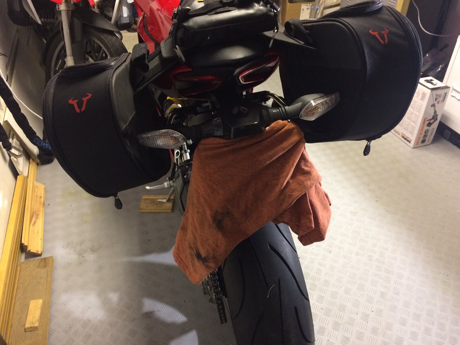

  18. Hi,
    do these touch the side of the tail fairing ?
    im planning on going away and ‘doing’ Europe on the gixxer and looking for some solutions (bloody sold all my kriega)
  19. Yes they do. Unless you protect the sides of the tail unit then they will rub the plastic. I have venture shield on my tail and put some non slip mesh between back of pannier and tail unit too.
    I sold all my Kreiga stuff I used on my K4 Gixer too; Doh.
