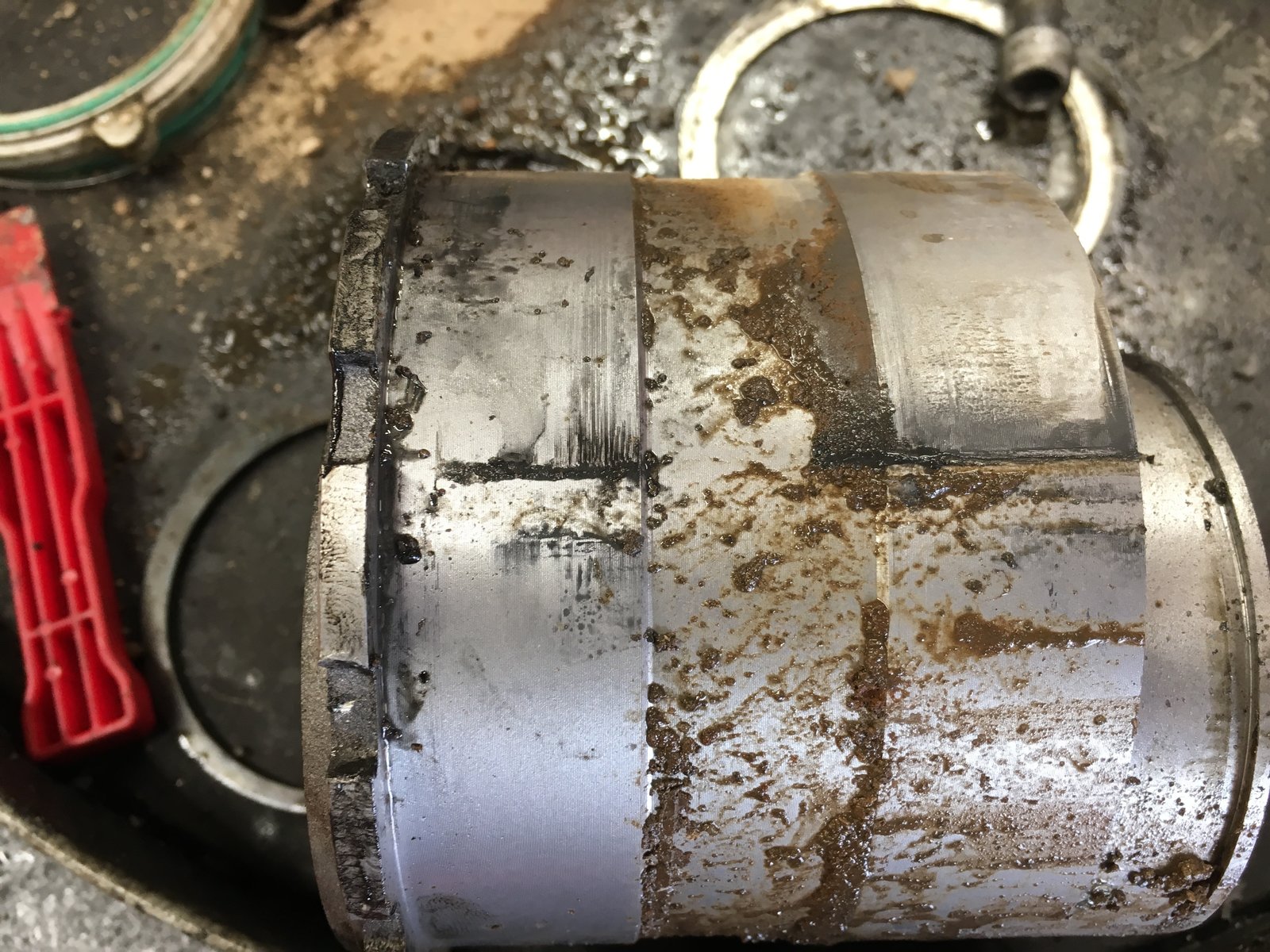

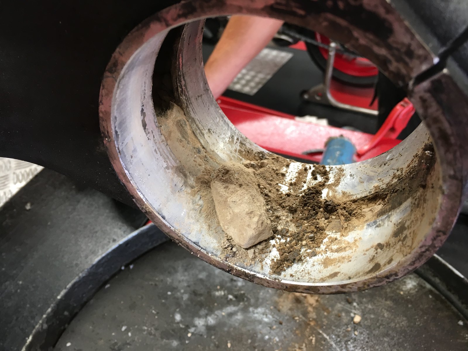

  3. image.jpeg There's more to the 15k service than "valves and belts" so be sure you're getting like for like quotes and that the full schedule is being followed. The chassis gets quite a going over as well as the motor.
    The rear hub should be stripped out of the arm and cleaned, and also the greasing of the rear hub bearings has been added into the original schedule. Standard hours for job were increased slightly to allow for this. It's seven or eight hours iirc now. I allow 2 days bench time in truth.
    I've had a few bikes turning up with seized hubs, unable to adjust the chain tension that had "recently" had the big service, but at a 'good price'....
  4. Would it be fair to presume this added work at the 15,000/18,000 valve service doesn't affect bikes with twin-sided swinging arms, such as Multistrada Enduro & the 950?
  5. Correct fella. It's 18k on the DVT and 950, but the rear hub work still applies to anything with a SSSA.
  6. Thank you for this advice. I had a call from Geoff Baines today to let me know that my hub was seized and bearings needed replacing so despite the added cost, I am very glad this will be rectified. My bike is unused over winter and I thought it wouldn't be an issue on mine!
    definitely recommend you get your Multistrada checked over and rear hub cleaned/inspected every 15k.
