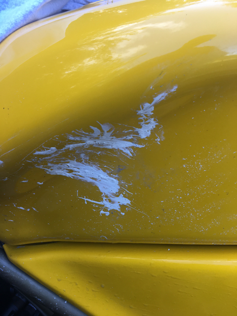

    Re the bath, I couldn't bring myself to inflict that on my wife so the bit that would fit in the kitchen sink, like the air box, did and it certainly makes it easier to scrape off. I'm loath to put the fuel tank in there though.
  2. Book her a spa day as a suprise, just cuz you love her and all that. Then get it all in the bath and pretend it never happened!
  3. I'm going to attack the tank when I next get chance and I was thinking of doing just that. Lay a tea-towel on the paint splurge then pour boiling water on it. I'll let you know if it works.

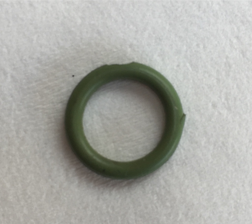

    But then I notice there's petrol pi**ing out the underneath of the tank onto the vertical cylinder head and running down over the exhaust manifold. Not good. Kill the engine. It took me 5 minutes to trace it to the o-ring in the QR fitting of the fuel feed line. For some reason it has a flat spot on one side. (The nick in the rubber was me extracting it with a small screwdriver). Well it is 19 years old. So, no more running today.
    A quick trip to the local farm co-op and get some o-rings of the same size (not Viton). Replace both feed and return o-rings and reconnect. I know they won't last but I've some Viton ones on order which will be fitted as soon as they get here.

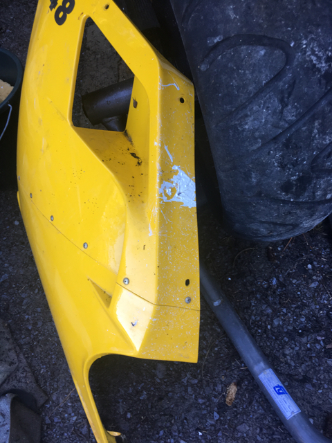

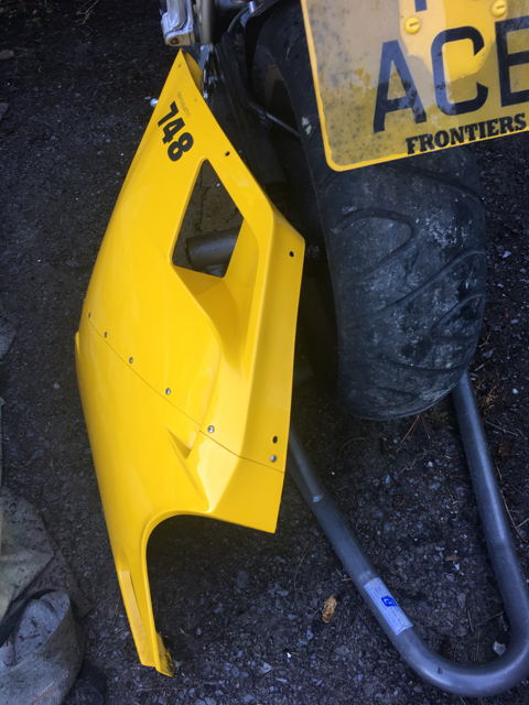

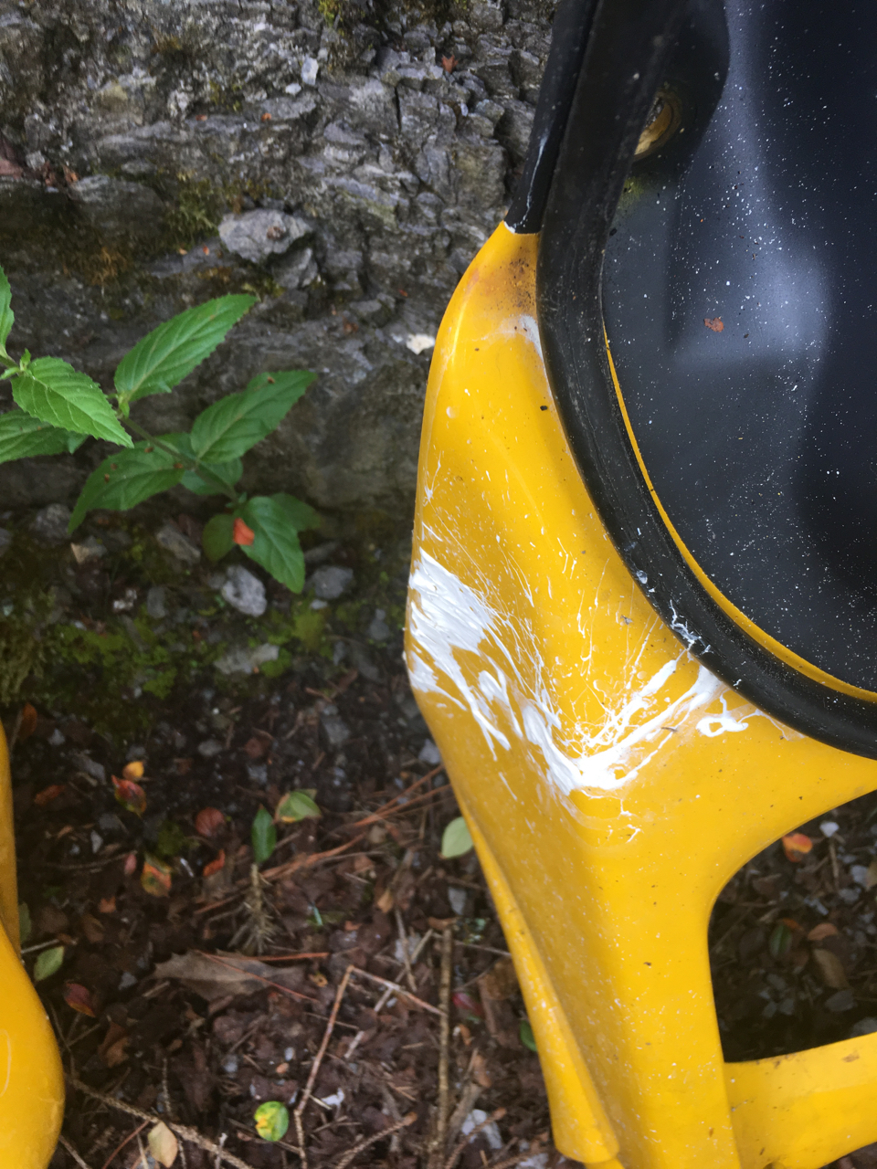

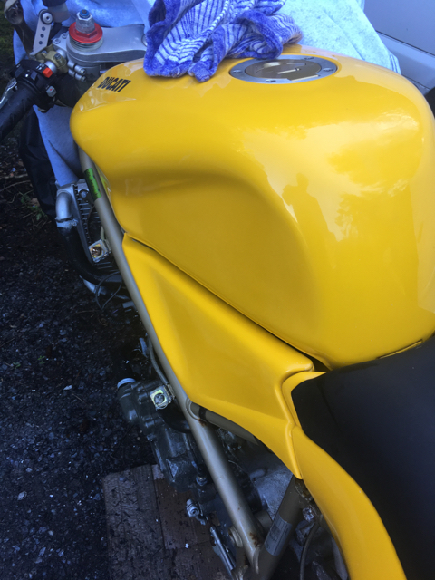

  14. NO MORE EMULSION.
    After buying a new tin of Elbow Grease and applying @Martin D 's suggestion of the hot towel bath the emulsion has now all gone. We're getting there.
