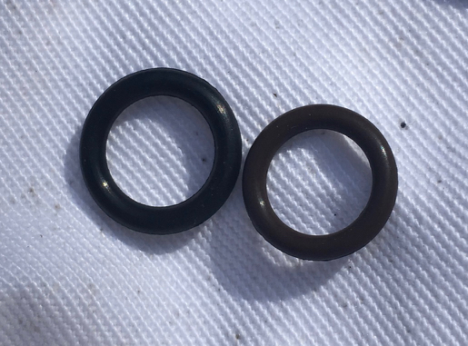

    Thanks @Exige for the viton fuel line o-rings which arrived so while the tank's off I'll swap out the regular o-rings I got from the local farm co-op and put on last week. Interestingly, even after just one week and no-more than 15mins engine running to bring it up to temp and check the fan cuts in you can see they've swollen. The one on the right is the original variant, the one on the left is after being on the fuel line for 1 week.

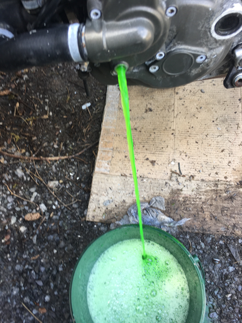

    Now to drain the coolant. Drain plug's not seized thankfully, despite the corrosion (although the crank case covers are in pretty bad cosmetic shape). Wow that's a vivid green colour, but so clean. Flush it through with a hose, re-fit the drain plug and top up with new coolant. The new coolant's blue. I think I prefer the fluorescent green personally.

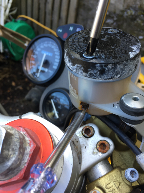

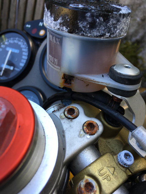

    Now for the clutch, rear brake and front brakes. No seized bleed nipples. No issues at all on the clutch and rear brake cylinders, what with them being plastic and simply unscrewing, but the front brake was a different story. The nuts at the end of the bolts securing the master cylinder lid are badly corroded. Despite application of penetrant although one did unscrew the other didn't and the nut started to turn in it's plastic housing. B*ll**ks what do I do now? Am I going to have to get a whole new master cylinder? But, necessity is the mother of invention and a small electrical screwdriver held between the nut and the nut housing holds the nut in place sufficiently enough to be able to undo the bolt. I'll get some new replacement nuts & bolts.

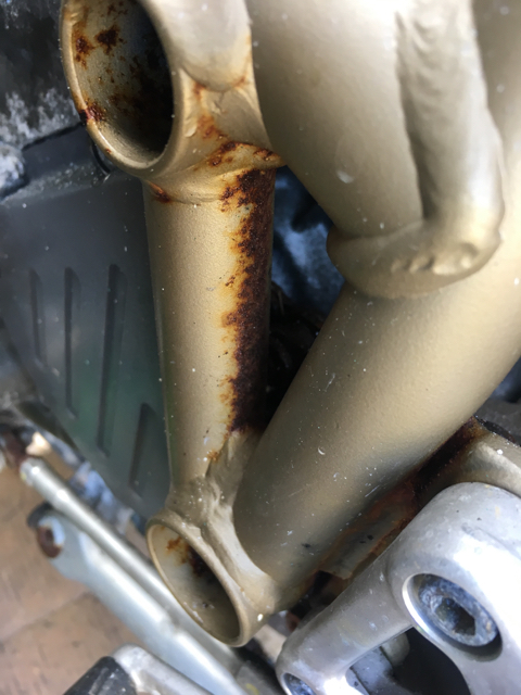

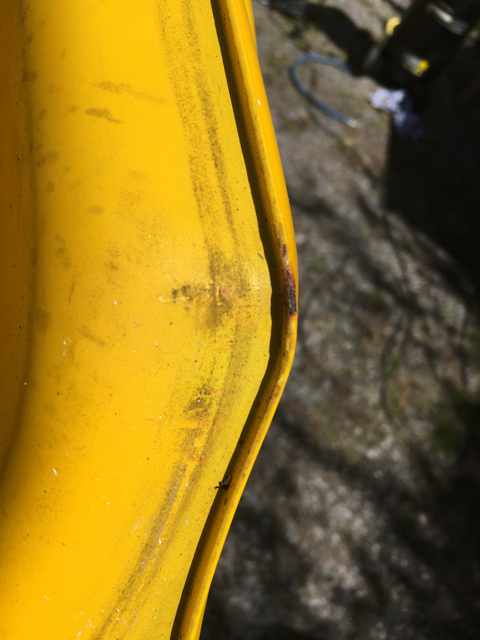

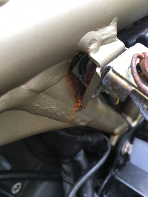

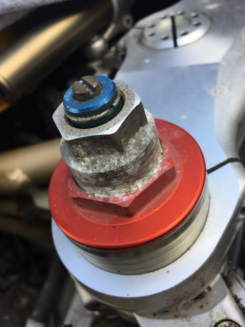

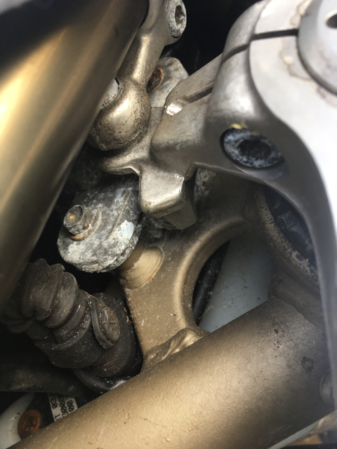

  5. CORROSION.
    All suggestions and advice as to the best way to treat the corrosion will be gratefully received.

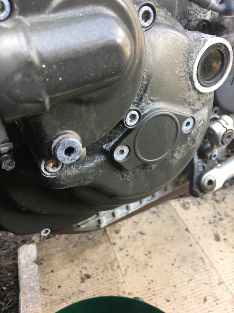

    As you can see, the crankcase covers are suffering badly with their paint bubbling and peeling off. Almost all alu alloy parts are suffering (the front fork adjusters as an example), alloy painted parts are suffering and the frame's got rust dotted all over it and the external seams on the tank have some corrosion.
    With regards to the frame, yes I know I can strip the whole bike down and get it blasted and powder-coated and maybe I will do that over the winter but for the time being I'm thinking of a wire brush and smooth gold hammerite. However, I've no ideas about the alloy bits.

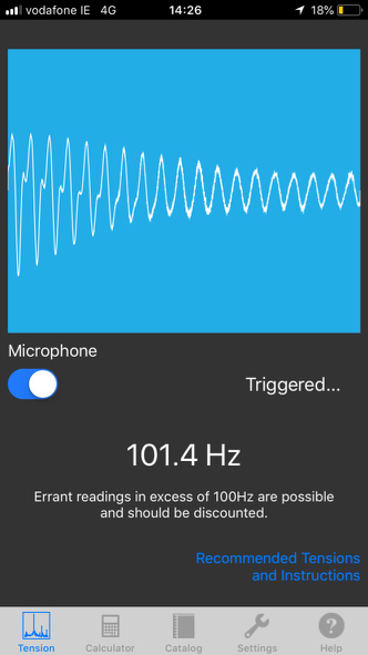

    Try as hard as I could I just couldn't hit the optimum 99Hz when tensioning so I've settled for 101Hz. I reckon a couple of Hz is neither here nor there.

  7. If you managed to get bang on 99Hz, I'm sure it would be more through luck than judgement
  8. Re the coating...id say strip to the frame and send the whole lot to be cerakoted ( engine back to the crankcases ). itll onlt need doing once and id hazzard increase the value of fhe bike...have a look at my engine rebuild thread in thd hyper area....my motor looks like brand new now...
  9. Thanks. It will probably going to be my winter project. Strip it down and get the frame and engine both redone.
  10. You'll be surprised how much more stuff can be done, loads of bits all over the engine, stand, exhaust, mounts, sub frame, swing arm etc etc...

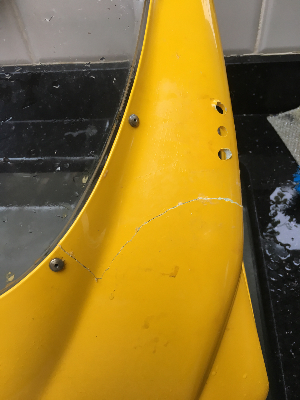

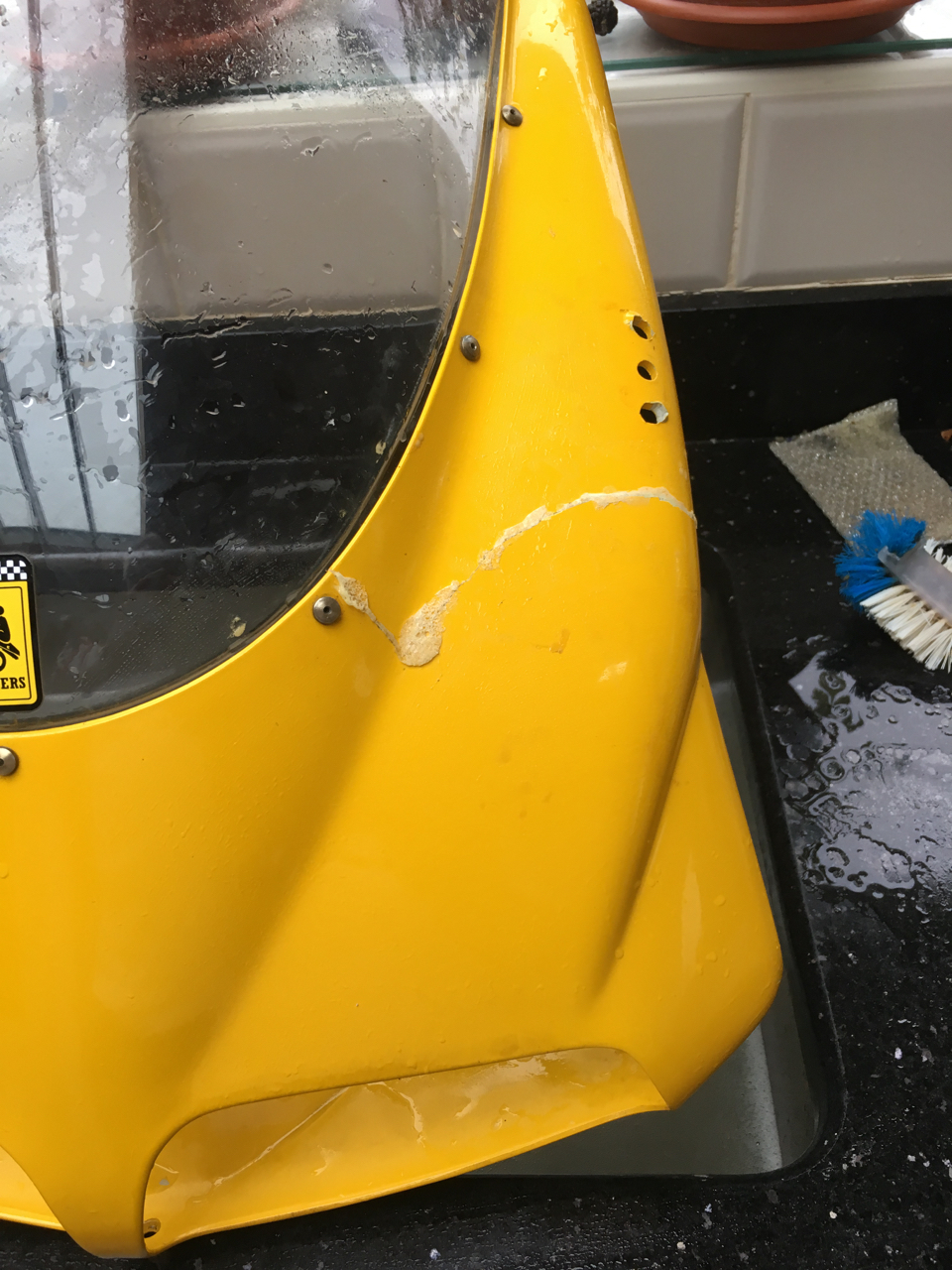

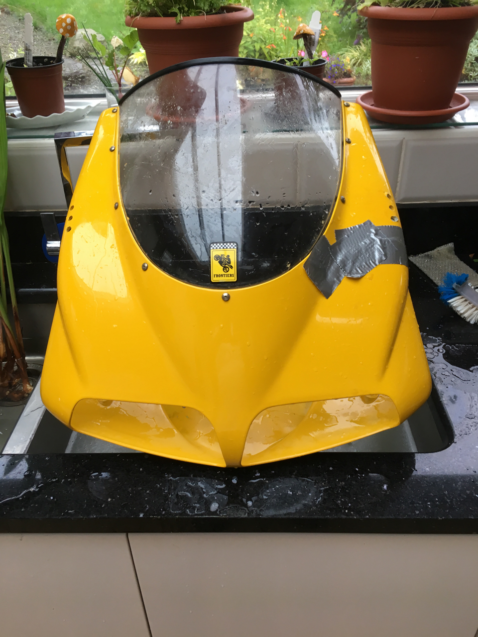

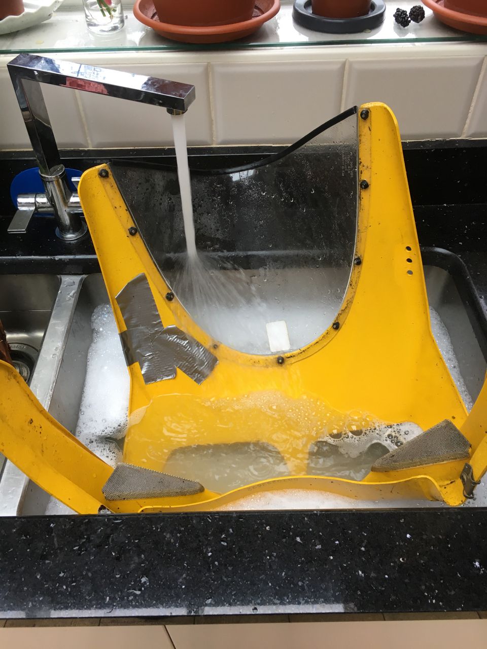

    While the cat's away the mice will play. The wife's out today so I sneaked the nose fairing into the kitchen to give it a good wash and remove the bandages. Before @Birdie and told me about the QBond (which I now have) and @comfysofa had told me about the hot stapler (which I haven't bought yet because it's €118, money which would go a long way towards a replacement nose fairing or a professional fix and respray), I used Gorilla Glue. It seems to have done the job but I'll find out how strong the repair really is once the fairing's back on. If it breaks I'll try the QBond next.
    Does anyone have any suggestions please for filler and where I can get Ducati yellow paint from? I might as well try and smooth out the glued crack and then respray. I've a paint spray gun and fancy giving it a go.

  15. I'd be inclined to fit the nose and run it for a while before spraying it, just in case the gorilla glue doesn't work. The Q bond doe's work as I've used it successfully. There is a lot of vibration around the mirror mounts when the bike is in motion.

  16. Well, the Gorilla Glue ('It'll stick anything!') doesn't stick anything. Actually, I had it in the kitchen draw so tried it. The joint failed as soon as I started to mount the fairing. So, out with the QBond. Boy, does that set quickly! I couldn't even get the joint aligned in time so now I have a Grand Canyon of a scar across the fairing. Still, at least it appears firmly stuck this time. I'll see how it goes and shop around for a replacement.

  17. I think you should break that joint and start from scratch, clean it up, watch a YouTube video on how to use the Q bond.
    As for the gorilla glue, in my experience it works well on porous materials, not so good on others.
    Steve
