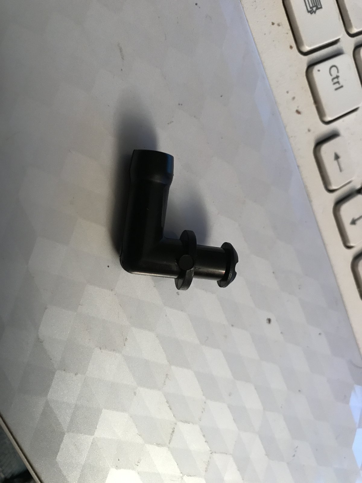

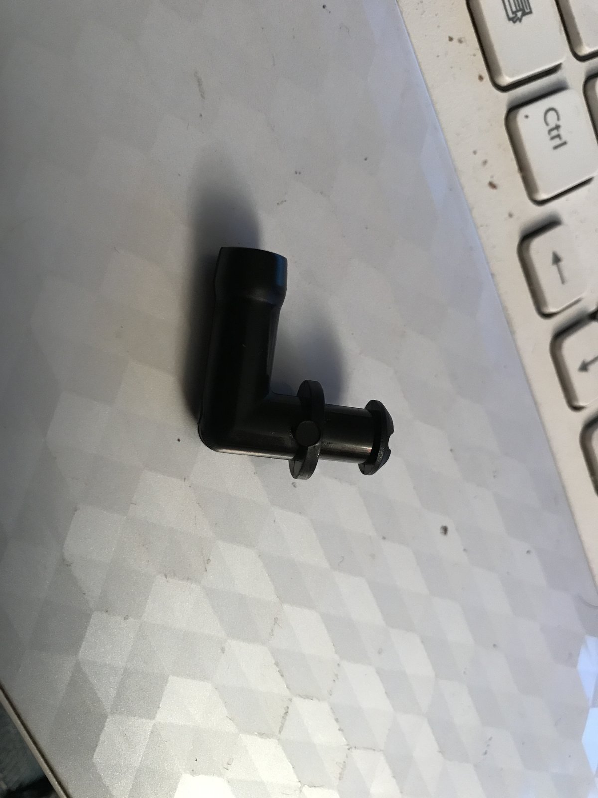

  16. Hey sorry to hi-jack but its a related question on Brembo spares, does anyone know where I can buy the spigot/union see pic
    This a 90 degree one but I want straight ones.
  17. That's Brembo for you!
