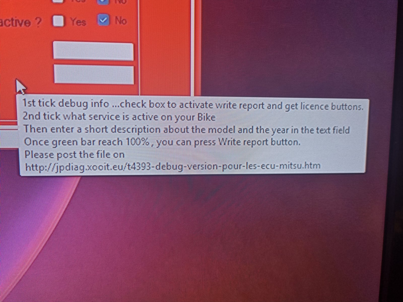

    When I applied for the licence I left the NO tick boxes ticked for OIL and DESMO. When the mouse is hovered in that area a help box pops up giving some info regarding the boxes but I find it difficult to understand - it talks of first tick and second ticks but theyre labelled YES or NO
    Once I received the license I pasted the LIC file into the Melco file as instructed. Sadly this doesnt seem to activate the DESMO RESET button.

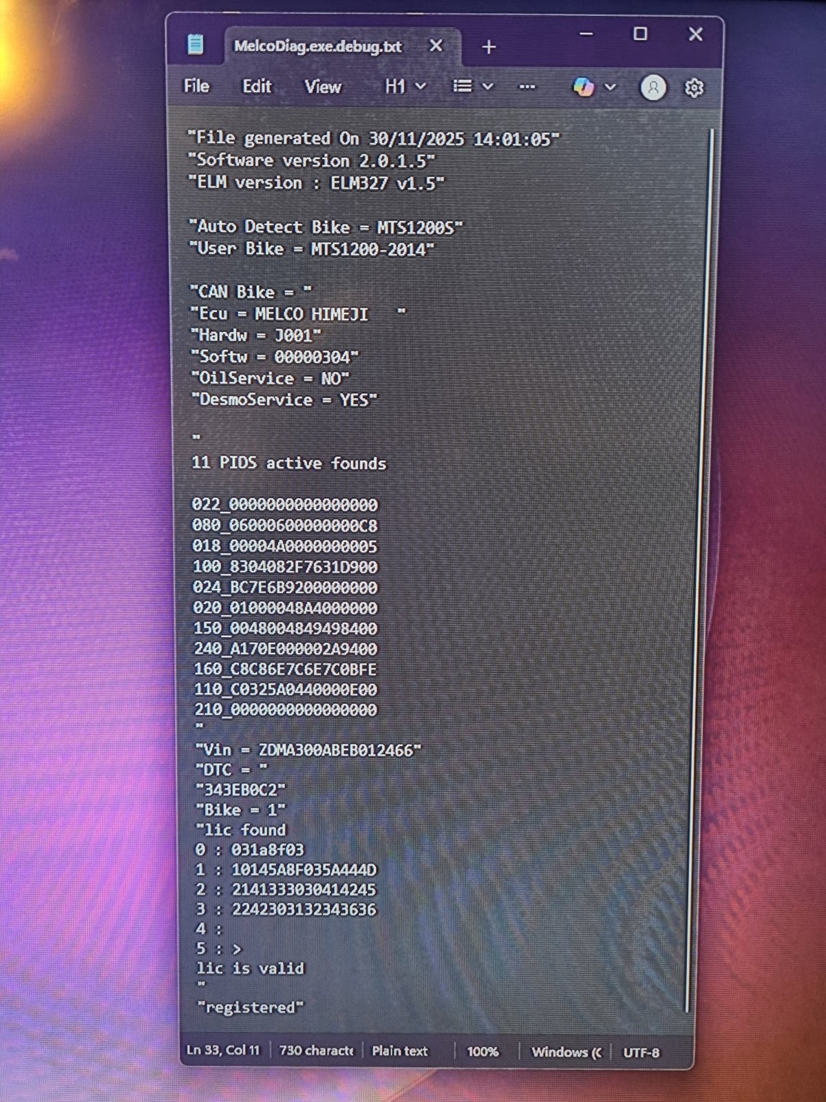

    Ive noticed that writing a report (front page button) generates a new file called MELCO DEBUG within the Melco diag file. SEE PIC 2. This originaly showed that the LIC file wasnt seen and the last line in the file said NOT REGISTERED. Changeing the DESMO to YES and clicking the WRITE REPORT button again now gives LIC FOUND and REGISTERED on the bottom line.
    Tragically this still doesnt seem to enable the DESMO SERVICE button either,

    Anyone explain the instructions in the second pic?
