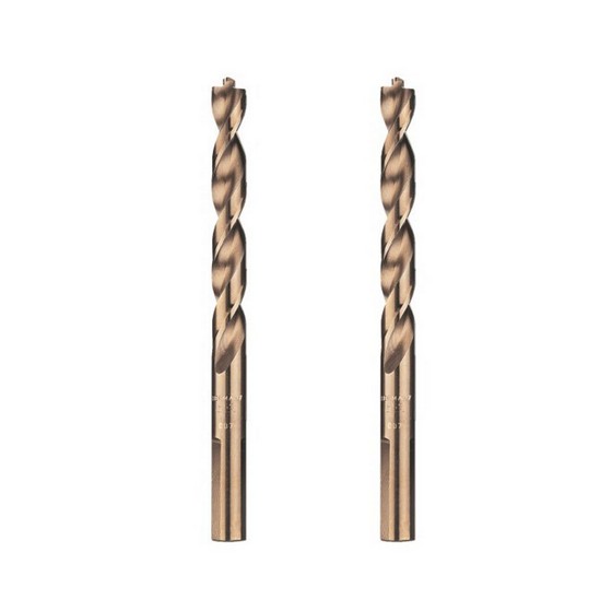

  16. +1 for cobalt. DeWalt do some. However, that all blunt eventually & need to be replaced.

  18. perfect for sheet metal. When used right, these leave no burr underneath.
