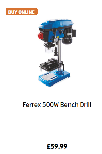

  6. I bought one with the work piece table on a rack (and winding handle) so you can raise or lower the depth of drilling. This is a well worthwhile extra as trying to set the height of the table accurately with the clamp ring is a PITA. Also, when comparing possible products go for the one with the highest wattage motor as some you see will struggle to drill steel without the drill stalling.
  7. At Aldi right now..
  8. Good to go for a good-quality second-hand one, as the cheap ones can be crappy (crappy = not stiff; low-quality clamps/vice; poor-quality chuck; small max-diameter chuck; insufficient motor power; small number of speeds; inadequate work-piece height/clearance and so on...), but most are better than a hand drill :)
    As a guide, try to visit a decent workshop and see what they've got then downgrade from that according to your budget. Very difficult if you're not used to a workshop environment...
