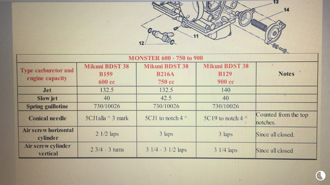

    During the summer I was working to the guide here for my m900.
    Basically the bike has been returned to stock by refitting g the stock pipes, a stock air filter, and reinstating the airboxlid to how it should be.
    Carbs apart and cleaned more times than I can remember.
    So are the numbers in the chart all good to work to?
    I need to pull it apart again to check the springs are stock as interview earlier pics in this thread.
  5. Seems to tally with what I have.....apologies for the way it appears here.
    MONSTER 600 - 750 - 900
    Tipo carburatore e cilindrata
    Mikuni BDST 38 B159
    600 c.c.
    Mikuni BDST 38 B216A
    750 c.c.
    Mikuni BDST 38 B129
    900 c.c.
    Note
    Main Jet
    132,5
    132,5
    140
    Idle Jet
    40
    42,5
    40
    Slide Spring
    730/10026
    730/10026
    730/10026
    Needle & Position
    5CJ1alla 3^ tacca
    5CJ1 alla 4^ tacca
    5C19 alla 4^ tacca
    Tacche contate dall'alto.
    SUPER SPORT 600 - 750 - 900
    Mikuni BDST 38 B159
    600 c.c.
    Mikuni BDST 38 B70
    750 c.c.
    Mikuni BDST 38 B67
    900 c.c.
    Note
    Main Jet
    135
    140
    140
    Idle Jet
    40
    37,5
    42,5
    Slide Spring
    730/10026
    730/10026
    730/10026
    Needle & Position
    5C19-3 - 3^ tacca
    5C19-3 alla 4^ tacca
    5C19-4 alla 4^ tacca
