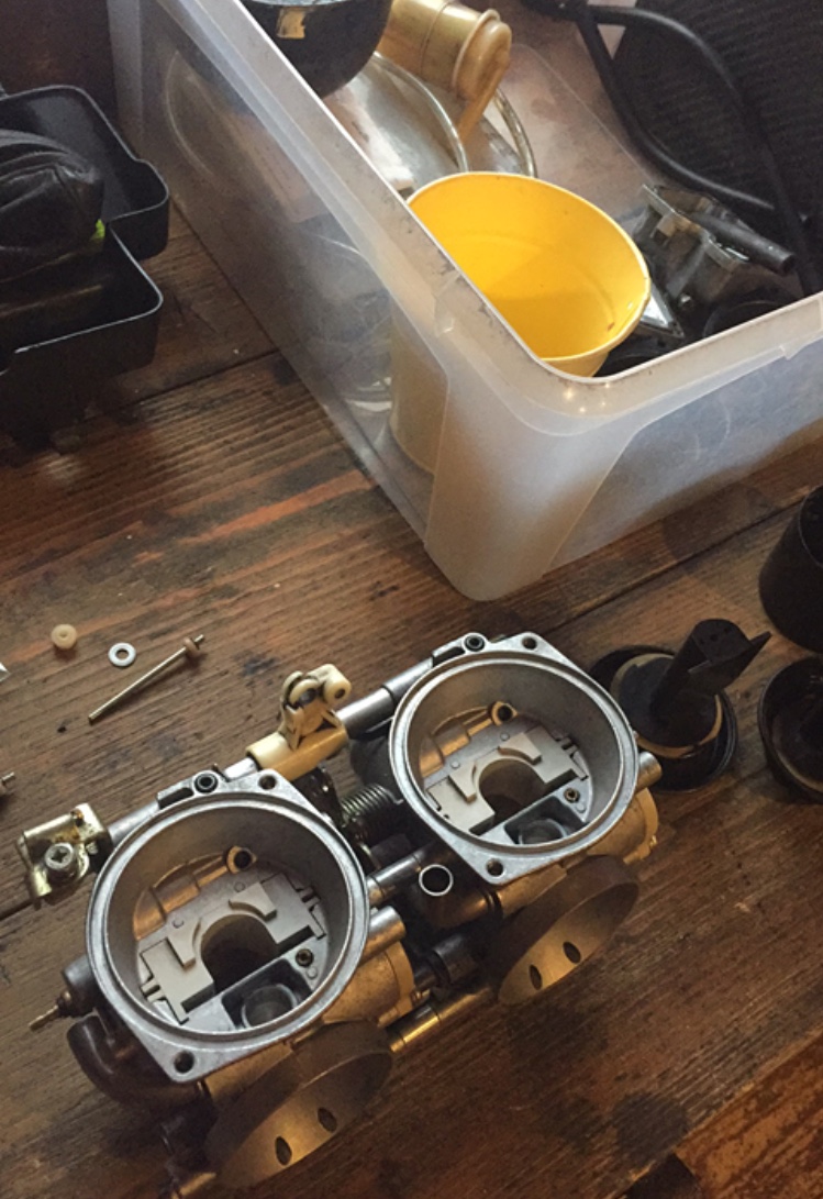

  5. So my pilot circuit seems just fine. Starts, ticks over and runs fine up to 4K. Its a very definite change over point. Also, the motor bogs if I open the throttle rapidly. I'll do all the simple plug and lead checks but something tells me its the diaphragm slide actuation.
  6. I feel your pain. I have just been thru these again checking, double checking and checking again every needle, jet snd setting setting. I’ve replaced the rings and found that thanks to a pic earlier in your thread that they still had Dynojet springs in which is no good to me as the bikes gone back to full stock.
