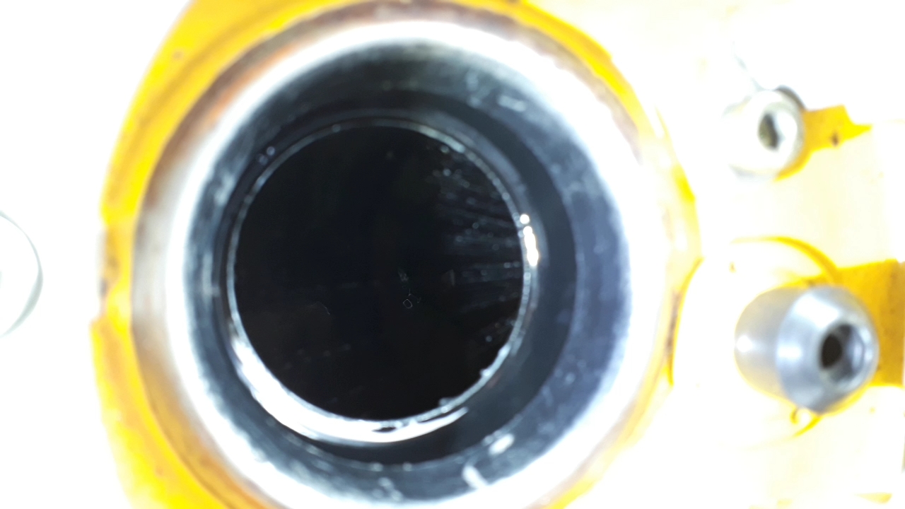

  1. I've got a misfire/stutter that I thought might be electrical but now I'm not so sure. When I look inside the filler with the engine running I can see a spray of fuel from just below the filler cap and I'm wondering if it's normal. You can see it in this photo. The bike stutters and spits as I start to open the throttle. Could be my imagination but I think the spray got worse at misfire. Last weekend it felt like it dropped on to one cylinder. Possible split fuel line or normal?
  2. Yeah split hose
  3. Or loose hose clip
  4. Thanks for the quick reply fellas. Much appreciated

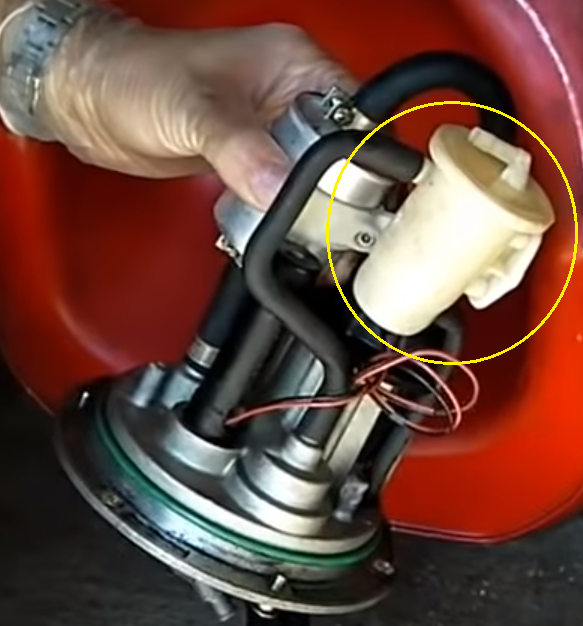

    I was looking at the pump assembly.. I'm wondering what the white thing is that I've circled in this pic, as it seems that the spray I'm seeing could be coming from the right angle pipe at the top, and it looks like it's part of the fuel return circuit(?)
