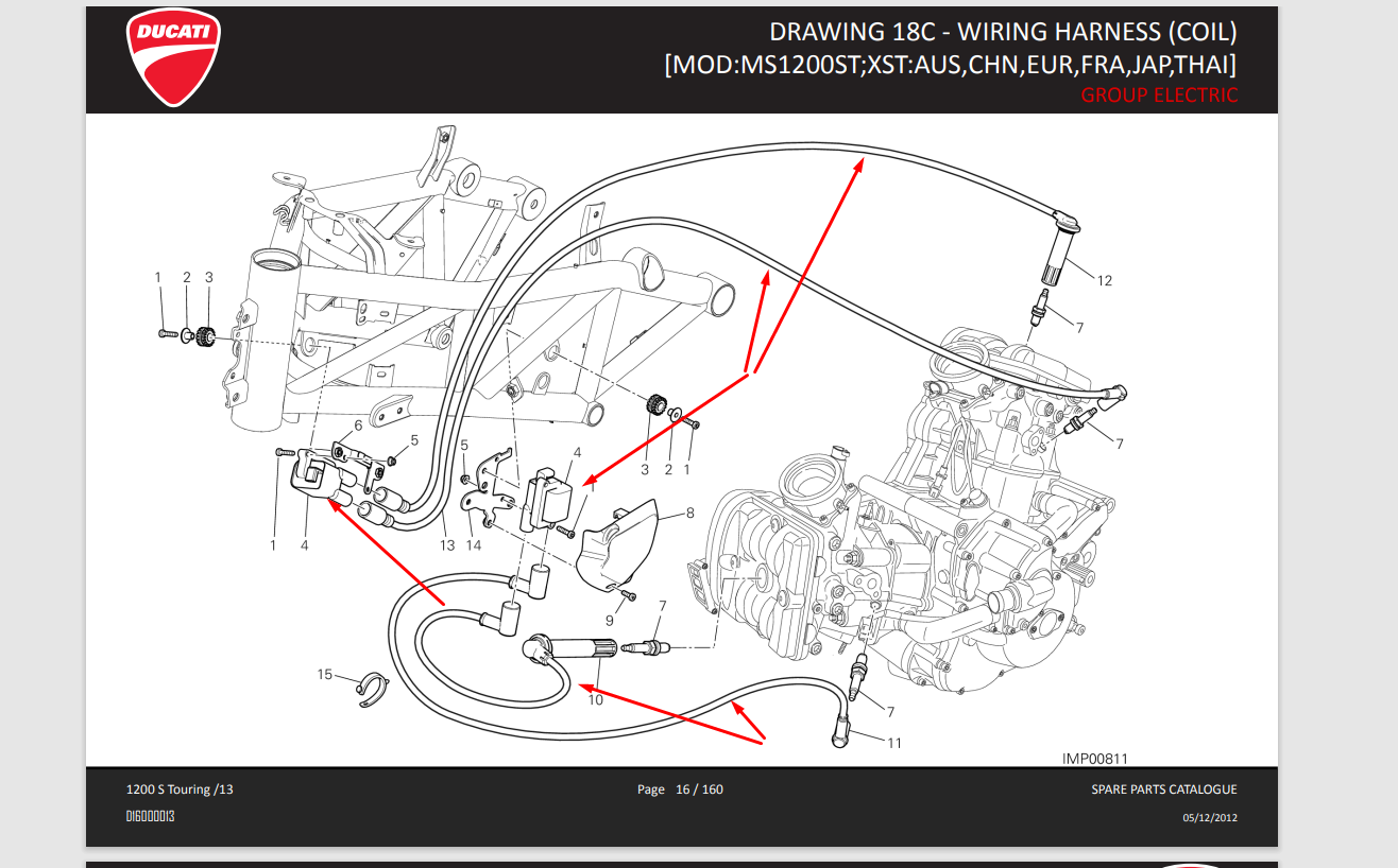

    I have a Multistrada 1200S Touring 2013 that has a misfire when warm The engine feels lumpy and you can feel the misfire. When I gun it, it pulls normally. I have checked the mfg wiring chart and it looks like the coils are the wrong way around on my bike to the wiring diagram ie the front cylinder HT leads are attached to the right coil, the back vertical cylinder to the left coil when the wiring diagram shows it the other way around? In your opinion, could this be the cause?

  8. That picture is wrong, noticed it when I had to order a new lead a few years back.

  10. I think you are correct there. I've definitely got the connections the correct way around.
