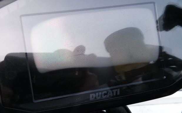

  14. Dragged mine out today and YEP. 512miles/9months old Dash misted up about 90% in the centre part of the display ;(
    Ran it for 10 min and slightly cleared up, but not much.

  15. that's bad and dangerous
  16. Dragged bike out again and Dash was totally clear ;)
    But
    After about 1h outside I went back to bike and Dash was misted up again ;(
  17. Got new dash fitted yesterday..
