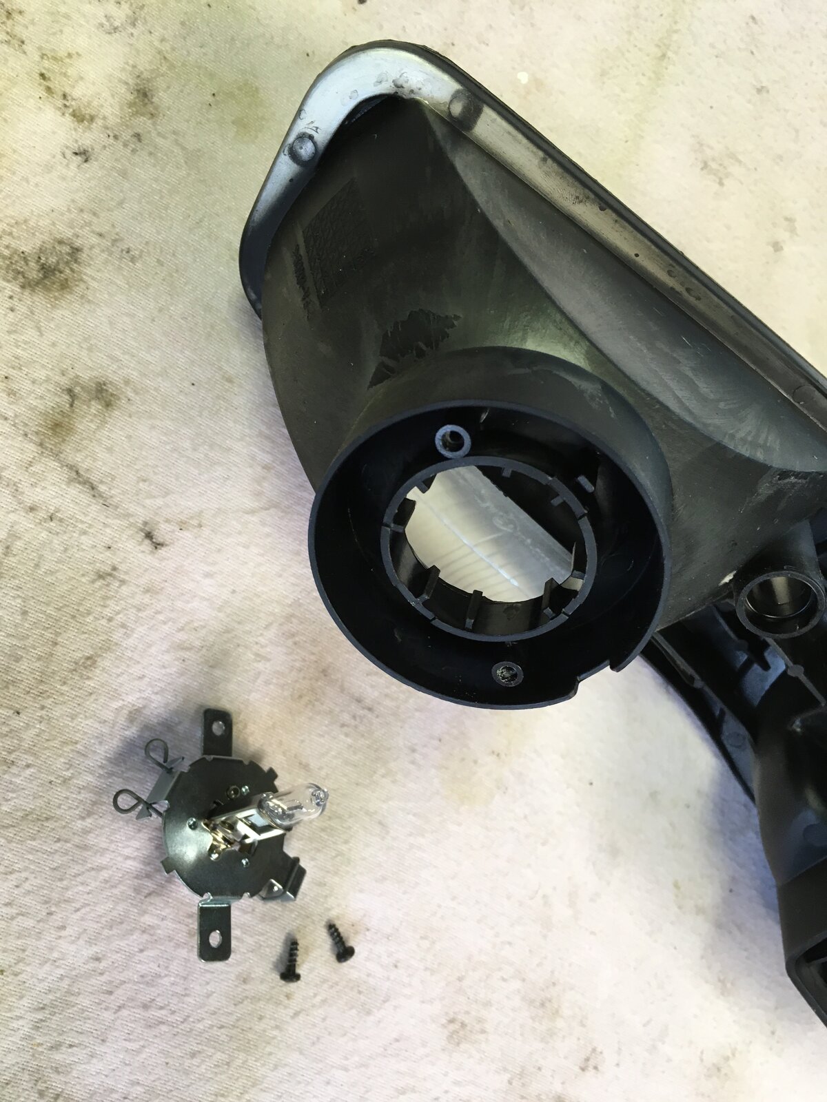

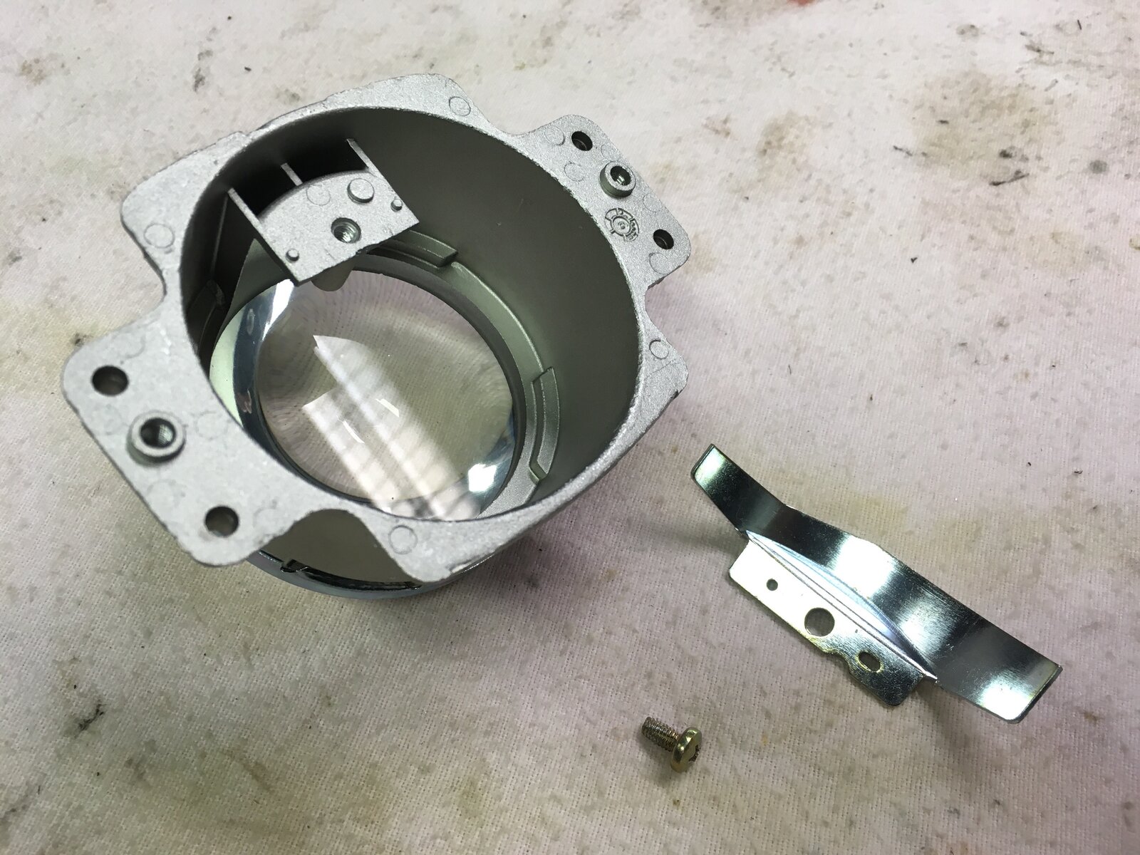

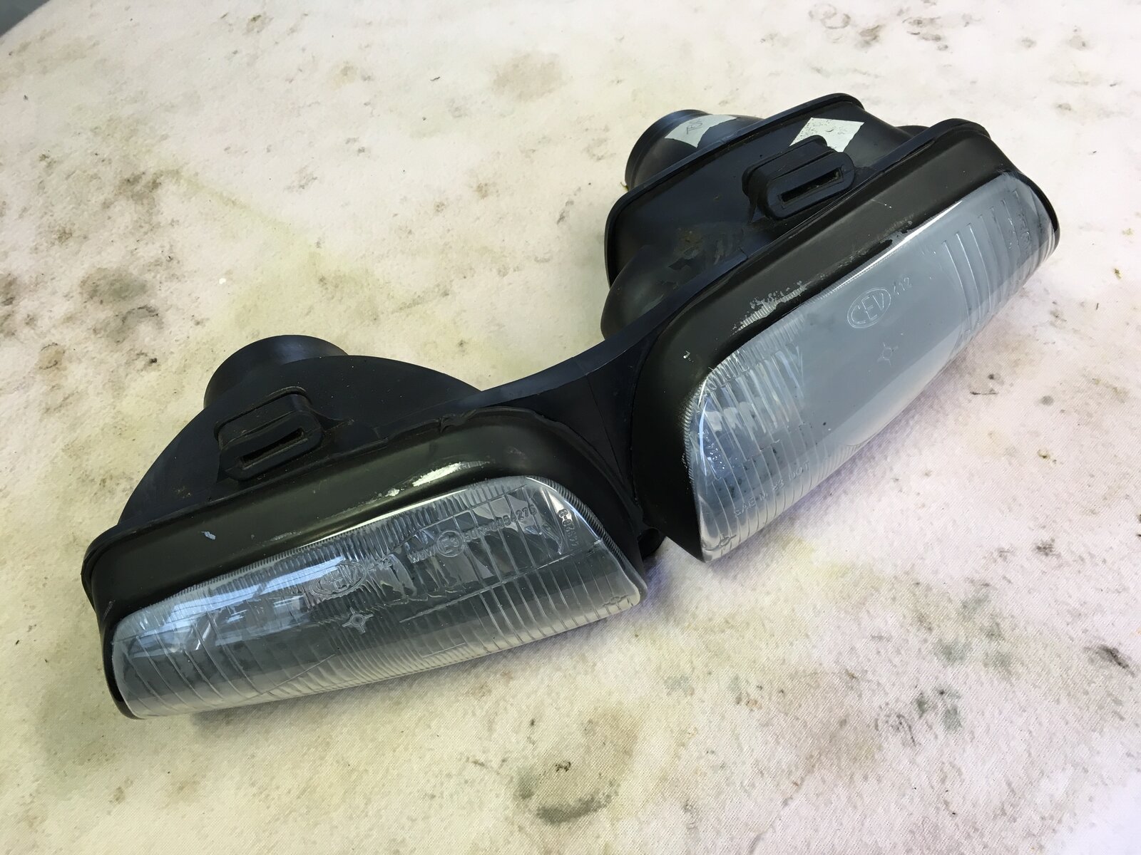

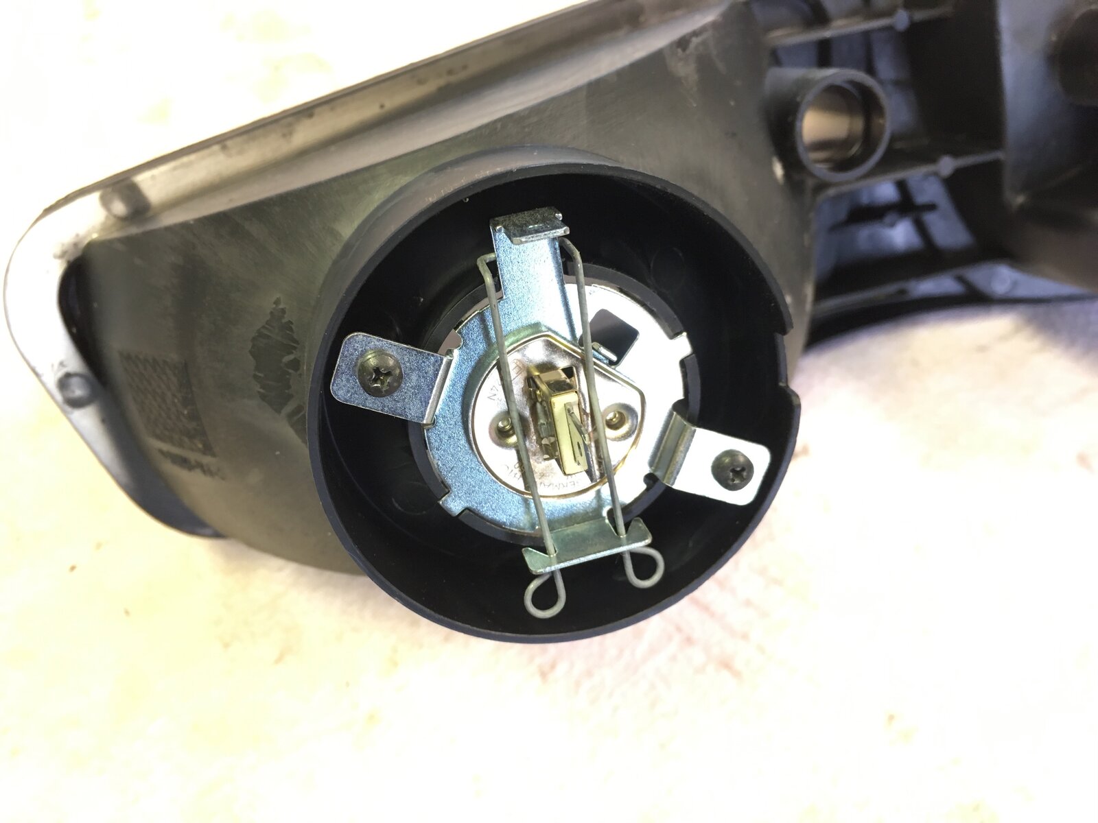

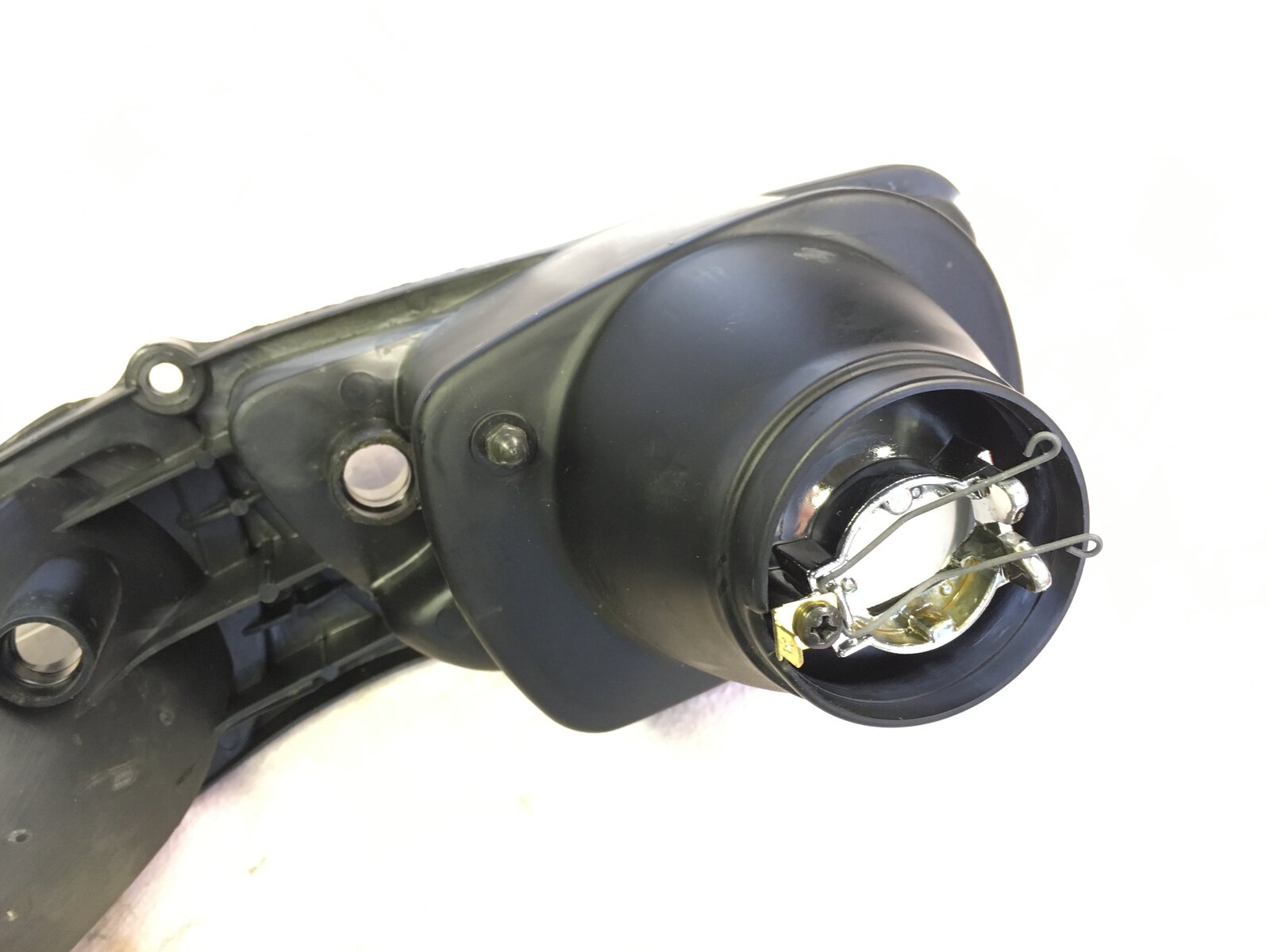

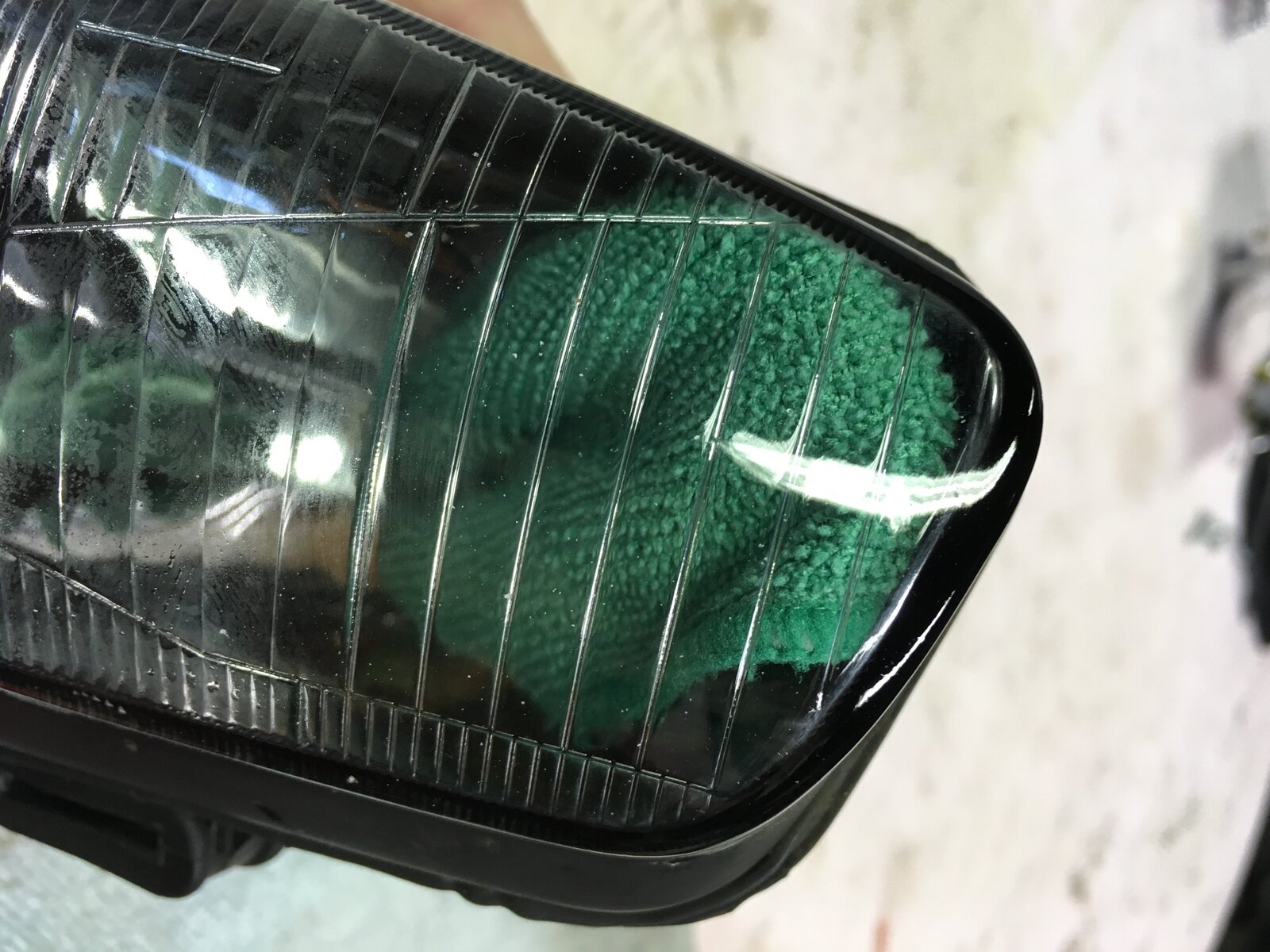

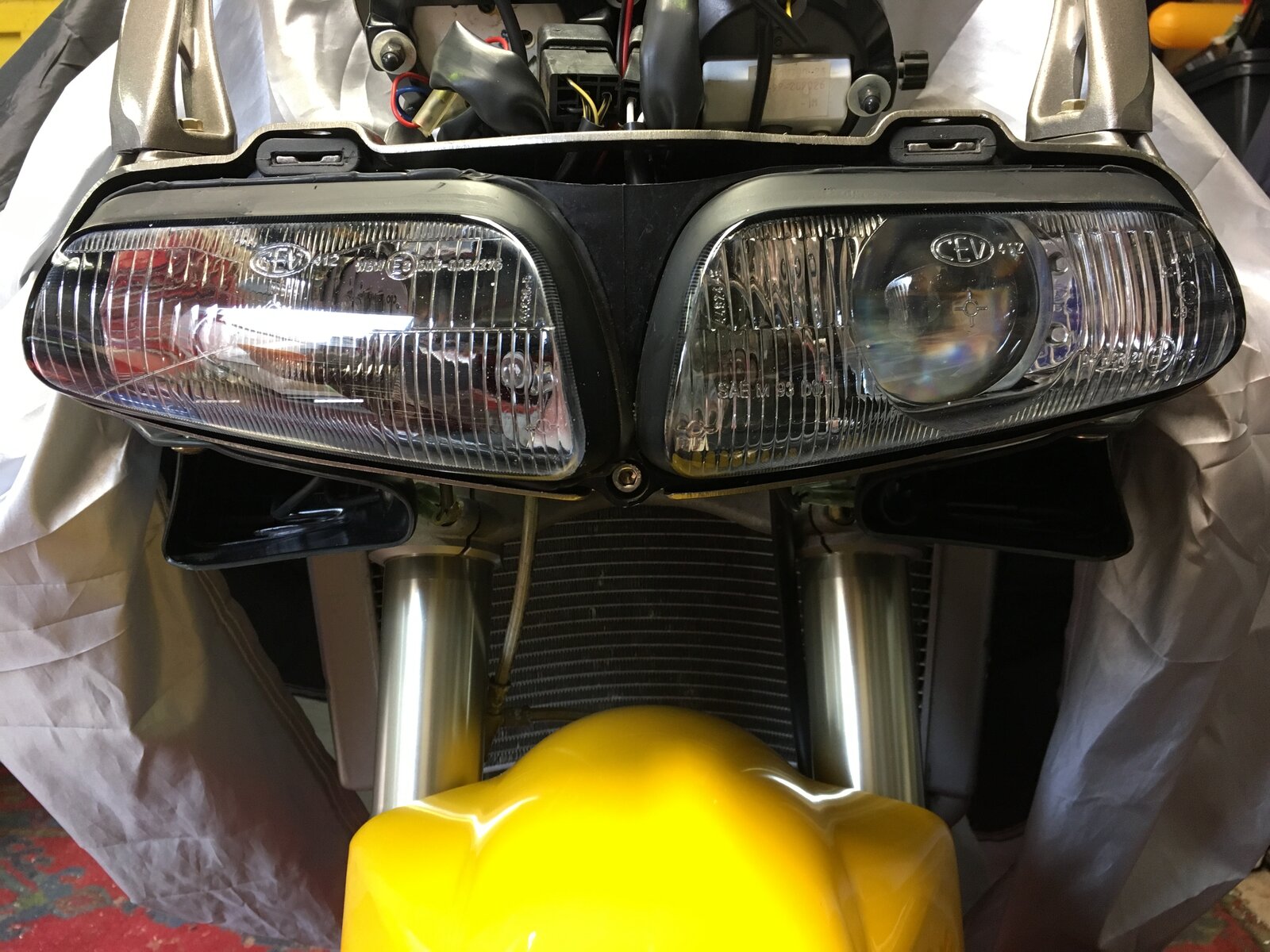

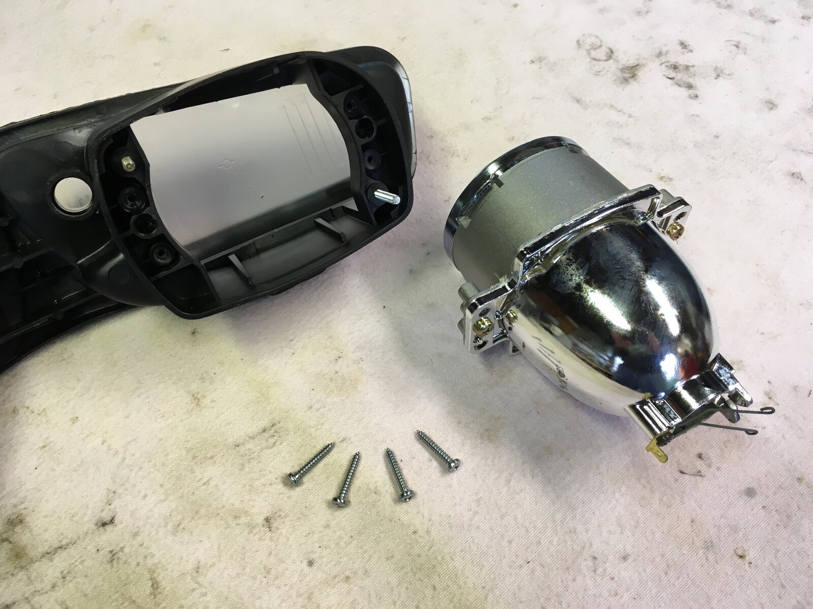

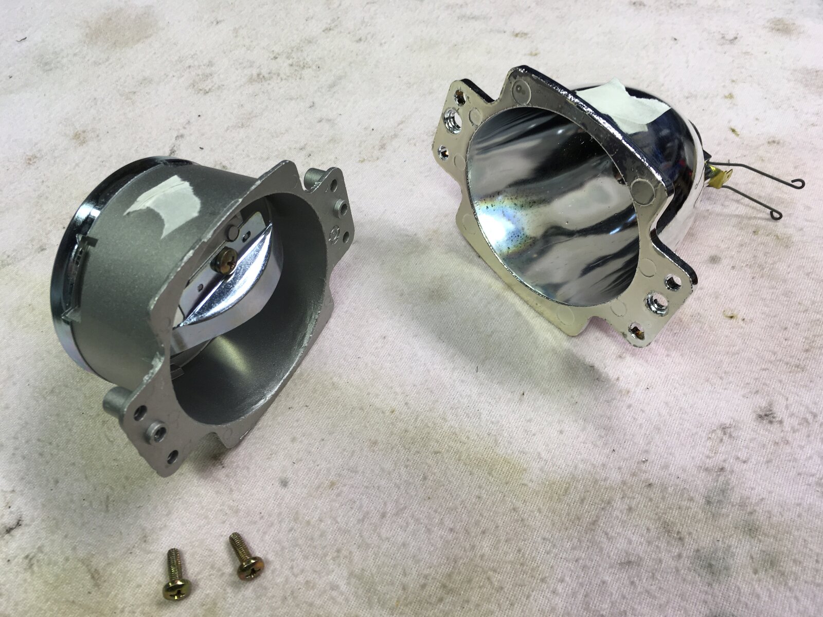

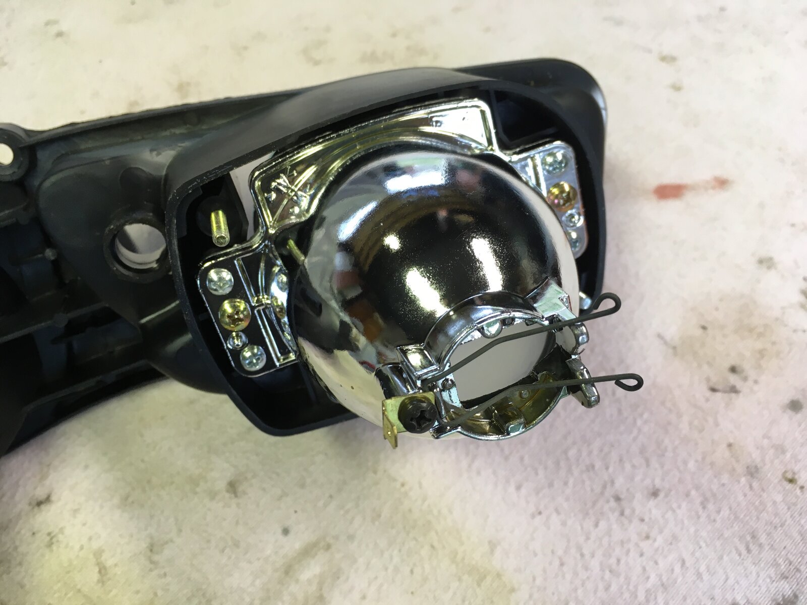

  6. IMG_0427.JPG IMG_0432.JPG IMG_0436.JPG IMG_0428.JPG IMG_0430.JPG IMG_0433.JPG IMG_0439.JPG IMG_0440.JPG IMG_0437.JPG IMG_0438.JPG IMG_0464.JPG
    My experience in words with photos showing the stages of cleaning the headlight lenses.
    I've just removed the old girls cataracts. She had a complete cataract in her left eye, and partial in her right.
    First remove the top fairing then remove the headlight unit from bike before removing the bulbs; it is a lot easier and takes no time at all. Now remove the single screw in between the lenses that adjusts the headlight beam, then push the lights forward off the rubber mounts by pushing the bulb holders from the rear.
    Once I removed the headlight from the bike, I removed the bulb holder from the left side and the projector unit from the right. This allowed access to the rear of the front lenses where the hazy deposits are. I also stripped down the projector unit to let me to clean the magnifying lens properly.
    All done very carefully using a bent toothbrush moistened with water into which a couple of drops of washing up liquid had been added. The excess moisture was then removed with a micro fibre cloth wrapped around the toothbrush. At no time did I get any water on the reflector.
    Hopefully this might help someone.

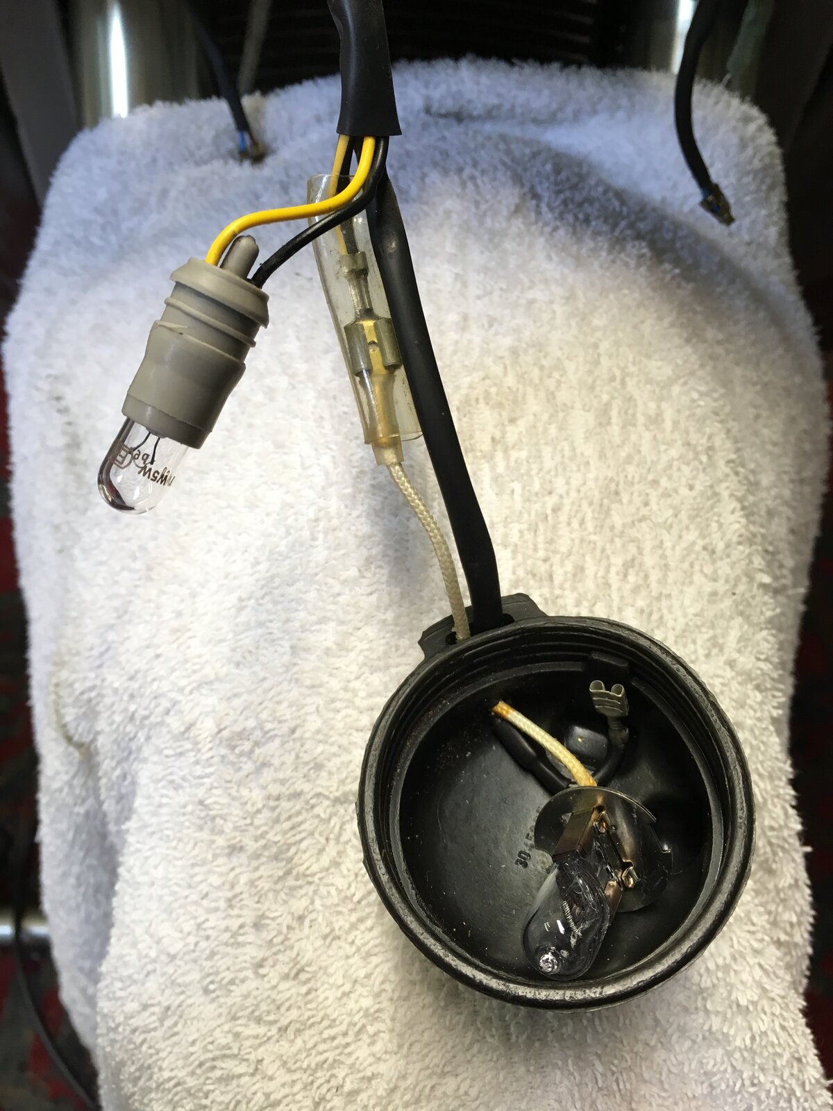

  7. IMG_0454.JPG I read somewhere the you should remove the horn to access the pilot bulbs, don't do it. Once the headlight is eased forward, use a small pair of pliers to grip the small tit between the wires and give a good pull as they will be quite tight. When replacing them, lubricate these and the headlight mounts slightly with silicon grease to make fitting easier.
    • Useful Useful x 2

  9. nice one George, as you say, washing up liquid* (hardly any contain salt, but check anyway..) and luke warm water is all you need. All I would add is avoid rubbing chromed plastic face too much as some will become matt or even detach from plastic. Anything stronger than this* can start to break down the bonding material used between glass and plastic - have seen glass detach completely before.
