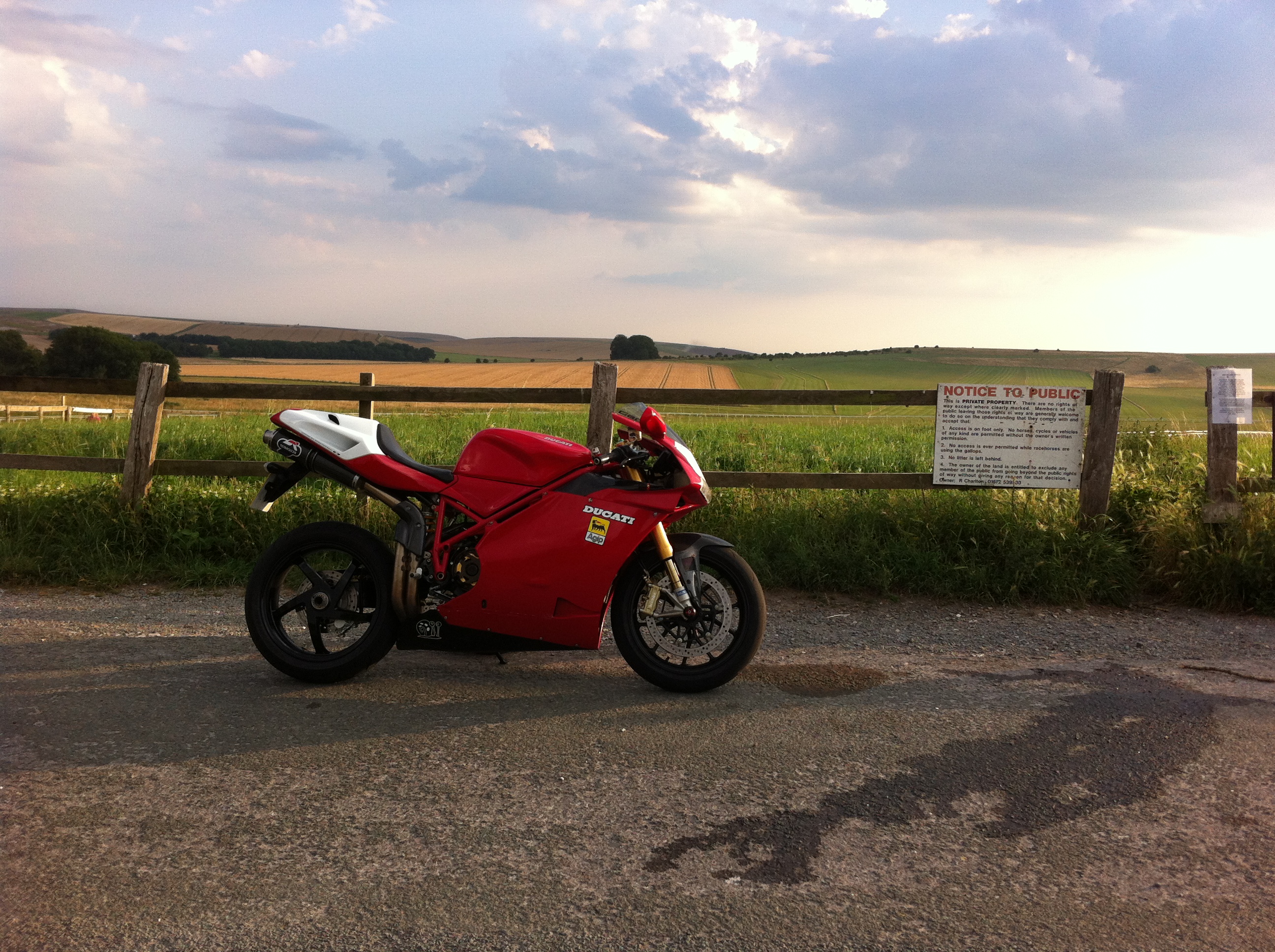

  11. Thought I'd up date this thread. Since completing the build I've done..... not very much really!
    Was still getting some alarming low speed bogging, which I appear to have fixed by fiddling with air screws/ecu trimmer (give enough monkeys enough type writers!).
    Bike idles really evenly and no stalling whatsoever. I will prob' still get a custom map sorted when I can bring myself to part with the money...:Woot:
    Also added a quick throttle, which leaves me giggling like a school girl after each ride! :D
    Future plans....I'll get the the headlight cowl off in the winter an have it blasted and coated black, that's prob all it needs.
    Also on the lookout for an ali mono seat frame for less than Atahualpa's ransom!
    Wee pic from this morning's ride...:Snaphappy:
