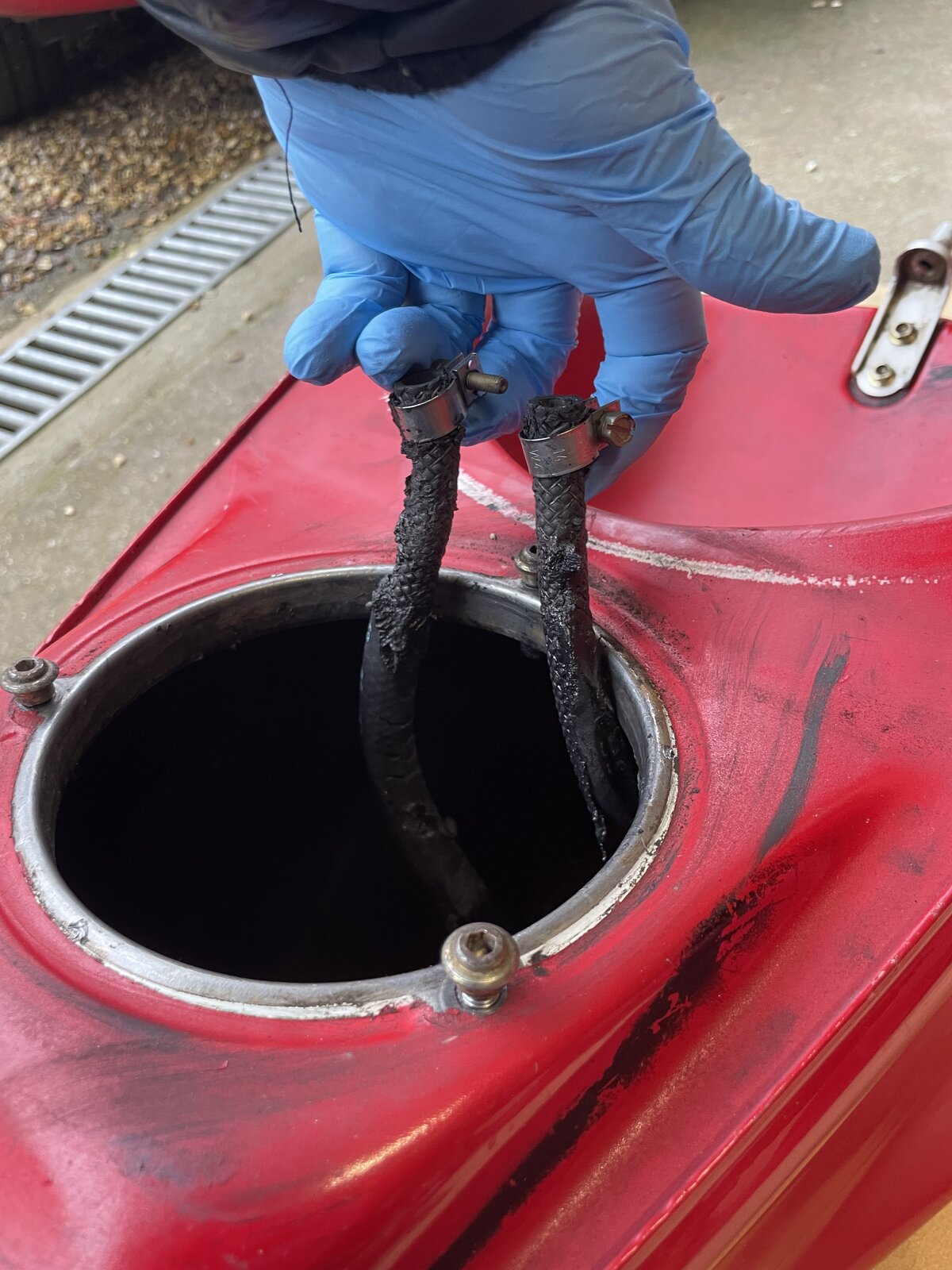

  2. I believe that 2000 was the cut off date for vehicles for Ethanol compatibility.. however I've used E10 in my 1997 900ss for many years without issues.
  3. The internal fuel hoses are known to perrish. They did that before ethanol and now it's definitely going to happen over time. They, together with the filter, need doing every 5 or so years anyway. Just replace with ethanol proof, submersible hose. The rest, including the external fuel hoses, is fine.
