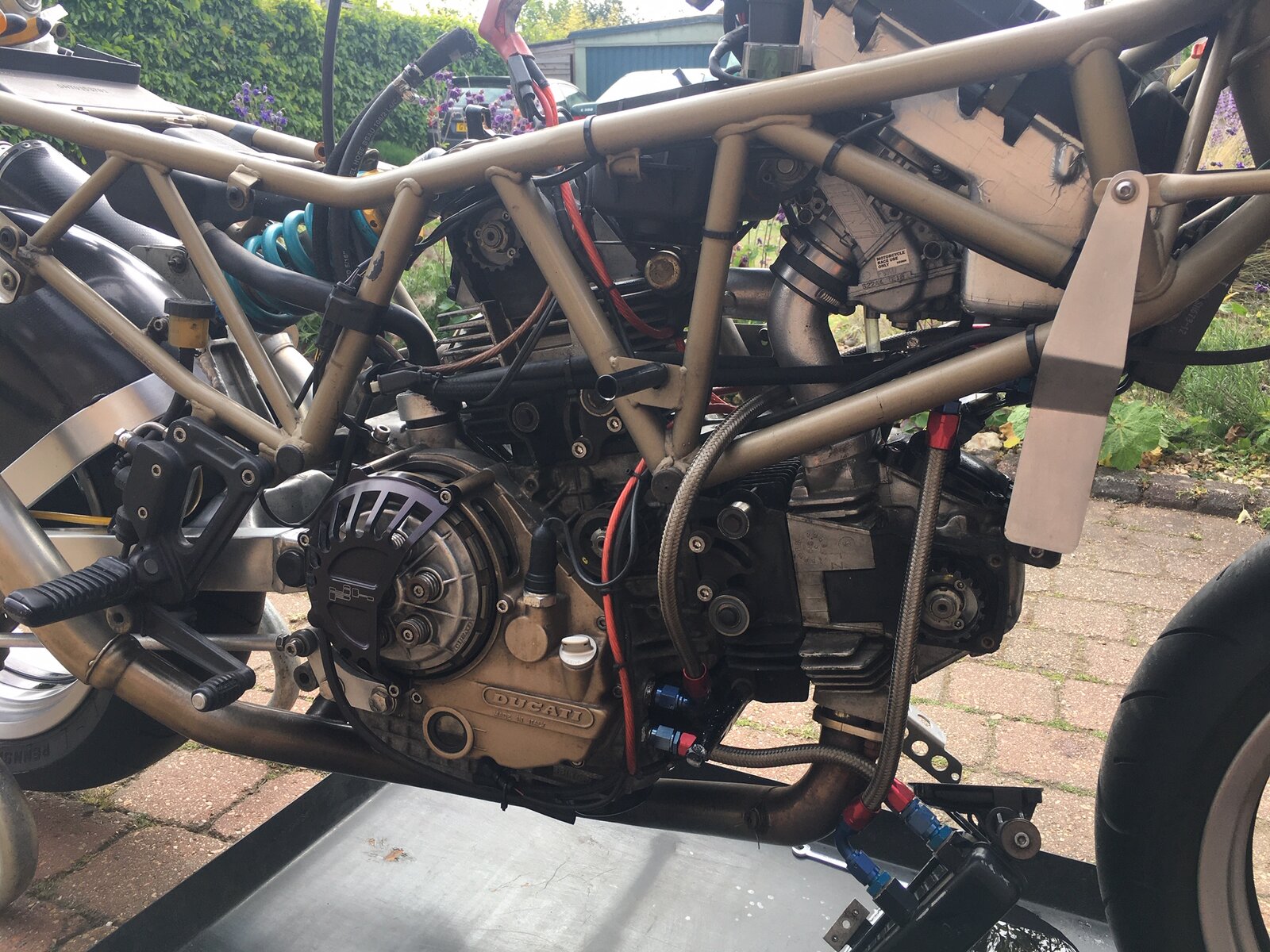

  3. Firstly I have serviced the engine and checked the valves - only one clearance had moved a touch - the horizontal opener inlet from .1 to .12 still in spec - these are spot on and with one exception as I set them years and 000 of miles ago. The openers are the easy ones to adjust too. As I went through the bike I was reminded of all the little and big things I did that i'd for gotten about (like the 748RS Verniers). She's a bit mucky, however I use her hard and she's got nearly 35,000 miles under her wheels.

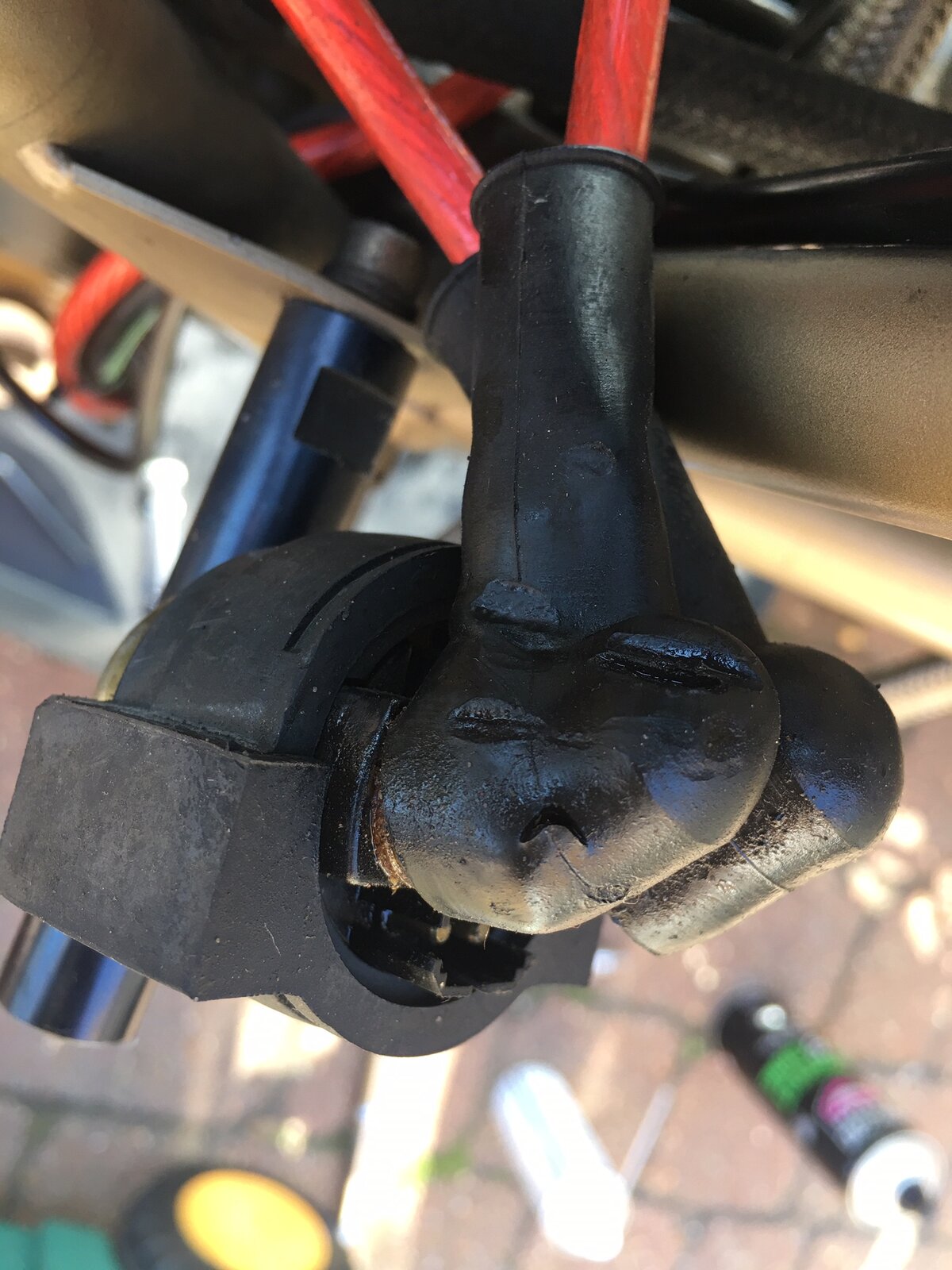

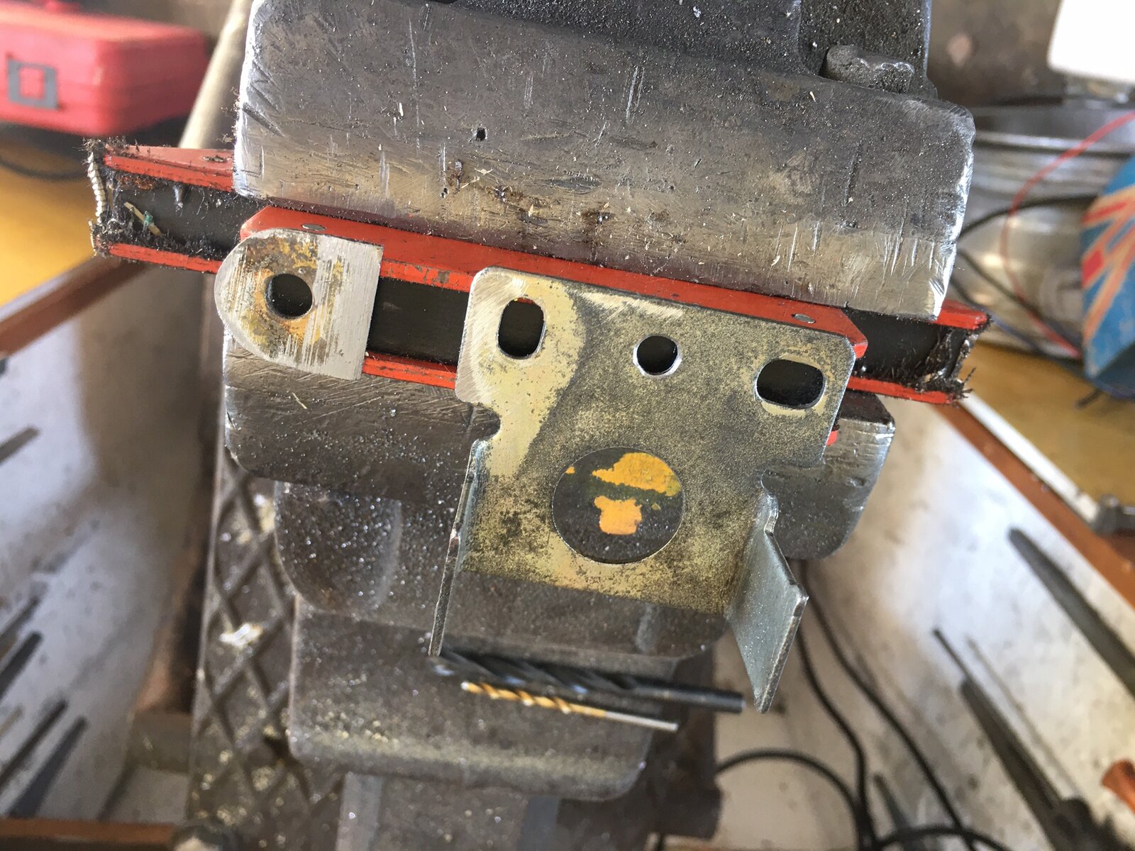

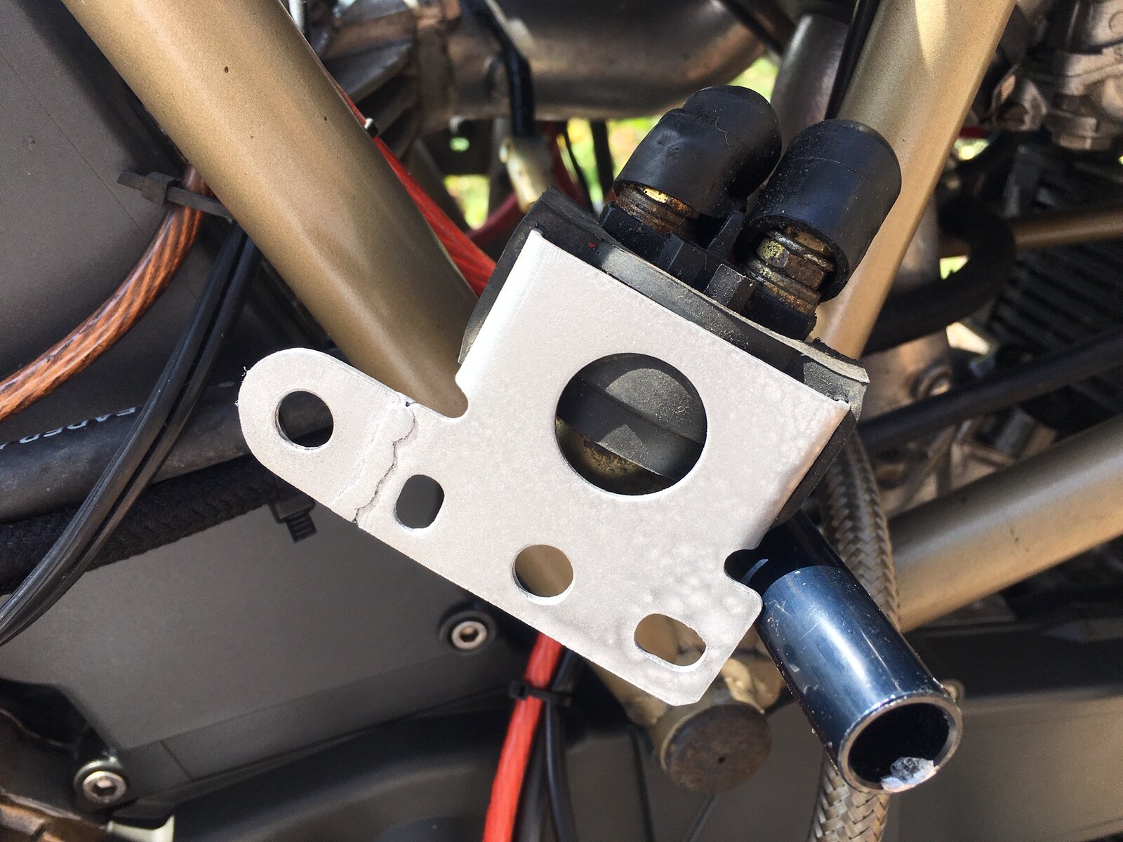

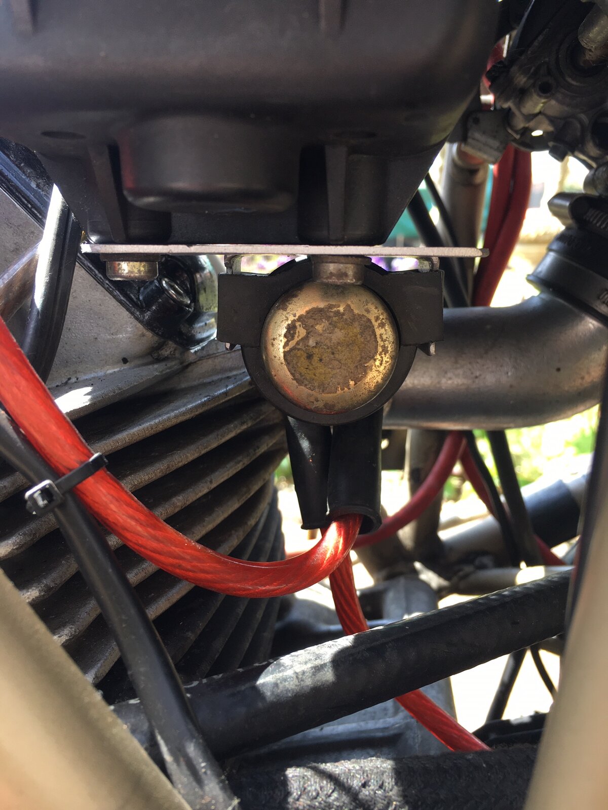

  4. One thing I did notice was that the main feed to the starter from the solenoid boot was touching the cylinder head. I'm not sure if they are all like that sir, or if its because my bike has ie heads. Anyway - its a recipe for disaster, so a hunt around the metal bin, a spot of welding and a rattle of silver and she's relocated a touch between the pots.
    solenoid boot.JPG solenoid bracket 1.JPG solenoid boot.JPG solenoid bracket 1.JPG solenoid bracket 2.JPG solenoid bracket 3.JPG repositioned Starter solenoid.JPG

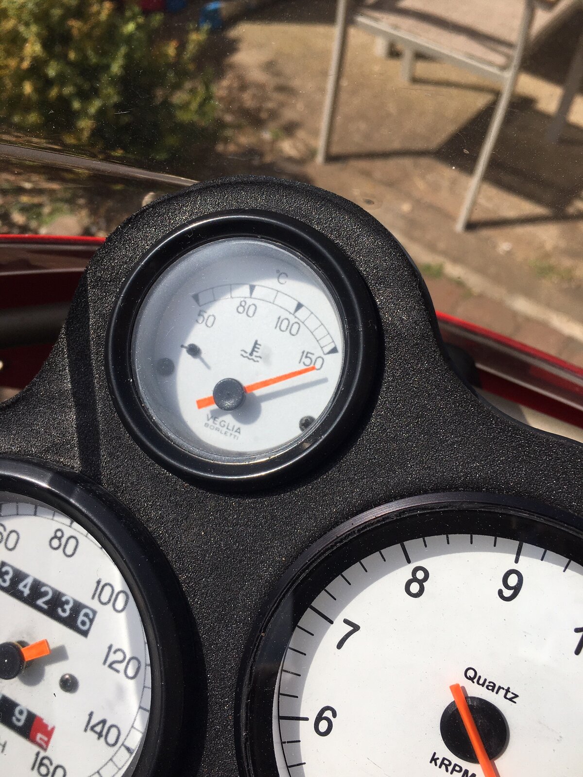

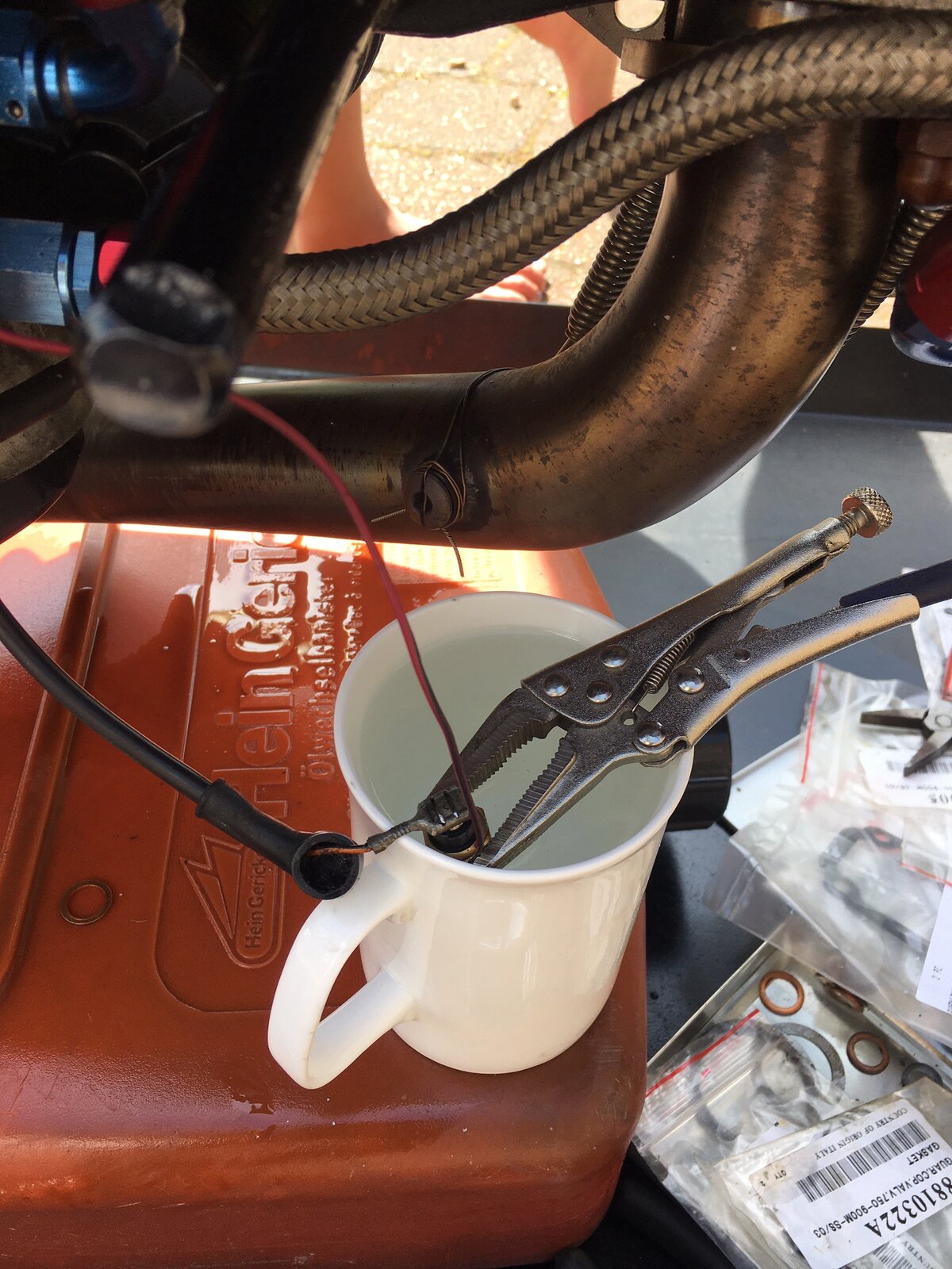

  6. Another thing that was bugging me was the oil temp - or what the gauge was indicating.
    so I jerry rigged this test with fresh hot water from the kettle
  7. ...and yes - the oil temp gauge had gone all Italian on me. Has the gauge died? any one any ideas? The sender is new.

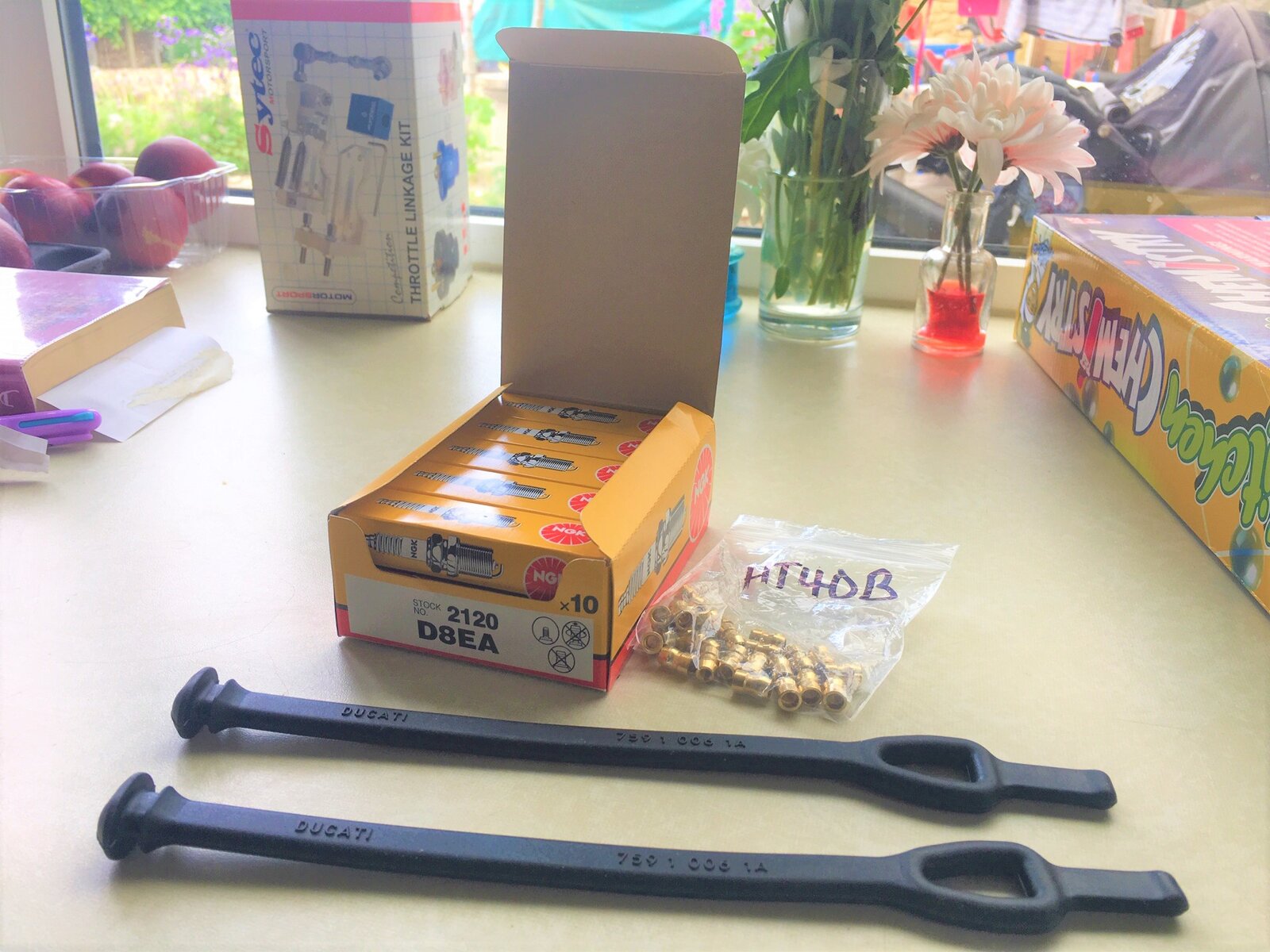

  8. New plugs have arrived and a pair of battery straps - I buy the D8EA's by the box - they are less than £2 each and work beautifully... got a load of brass bullets too - I nip 'em up then put a blob of Loctite in the top to stop them unscrewing.

  11. Just wondering where the return wire from the oil temp goes to? Or is it from the earth point the gauge has always used. I did a similar test to get my oil temp working and seem to remember the gauge not working because of the earth point I was using.
  12. Bike looks stunning btw.
  13. I earthed it to the engine - the small long nose mole grips clamp the wire hard for a good connection - I've done this before and the earth was not good enough so the gauge did not show anything.

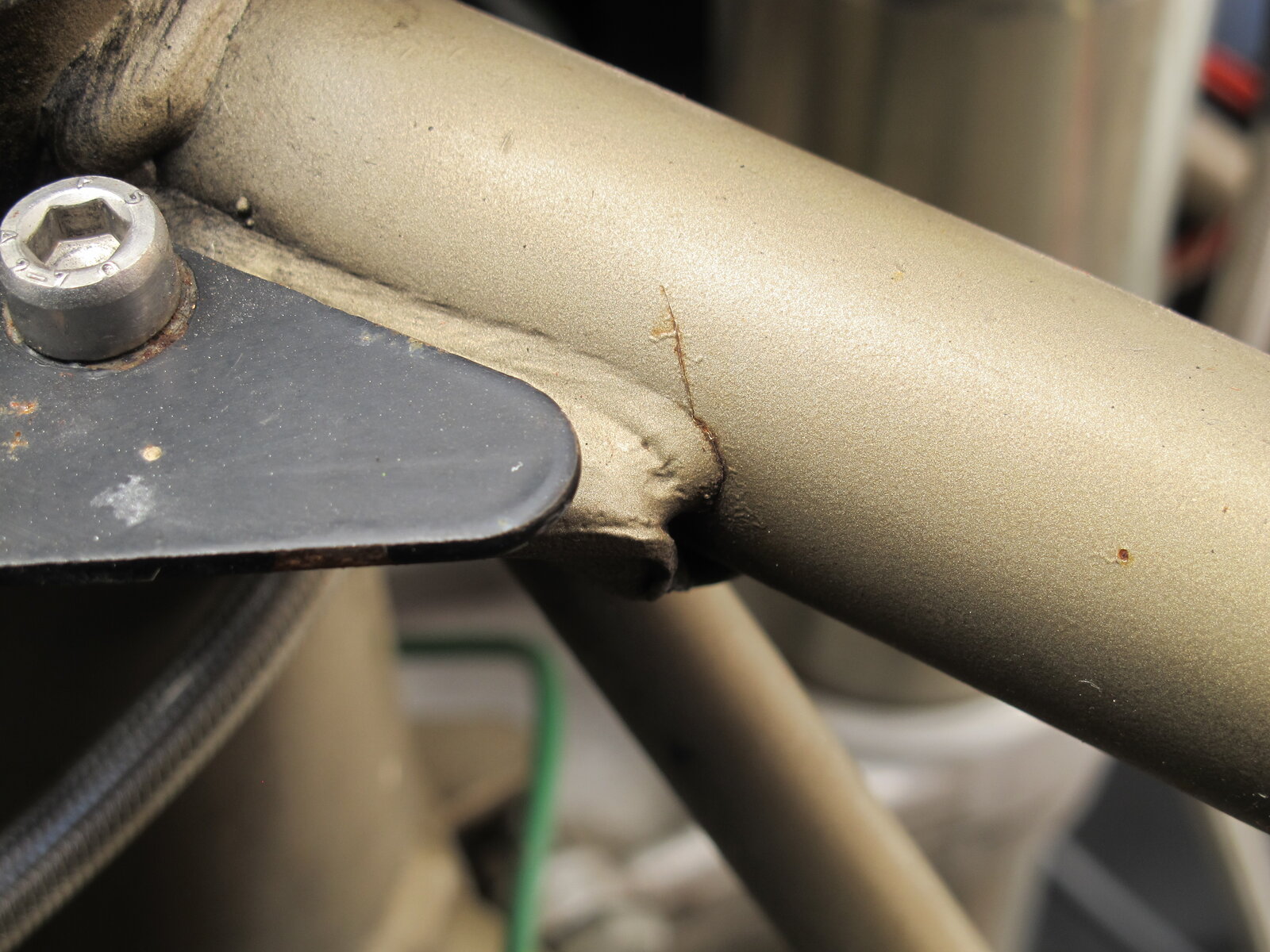

  14. T!TS and AR$E
    • Dislike Dislike x 4
  15. ARSE Indeed.
    Been there done that.
    Luckily it was 20 years ago and they were still dishing out new frames FOC if you paid the labour to get the change-over done.
    There was a company at Pocklington who were welding braces onto the frames some years ago.
    Unless you know someone else, it may be worth checking if they are still on the go and if they are prepared to tackle the job.
