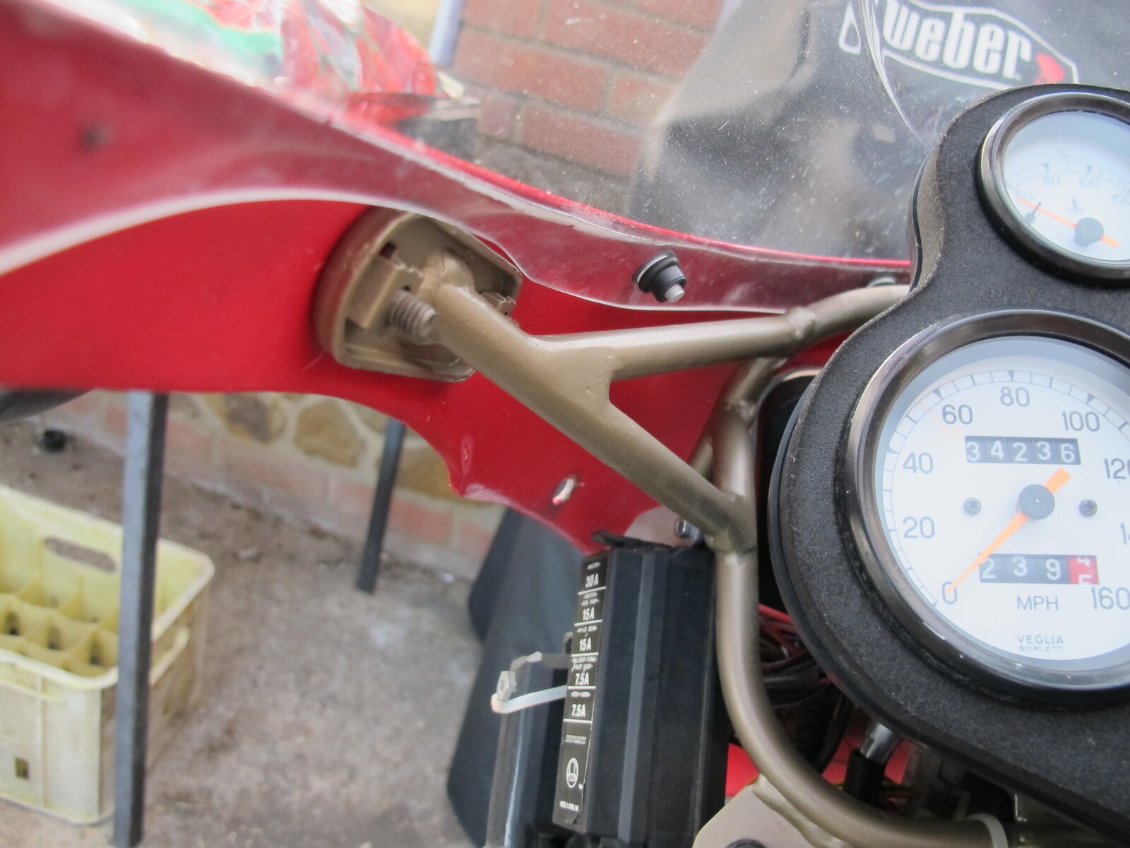

  3. Id for gotten about this great mod I did about 10 years ago.
    The mirrors and nose fairing are mounted to the frame by these single stalks sprouting out of the front subframe, they wobble and mine had a crack in the weld one side, so while I re welded the original weld I added an extra tube for stiffness.
    Works beautifully and the mirrors are really firmly mounted.
    Note the relocated fuse box - she has clip ons that fouled the old position.

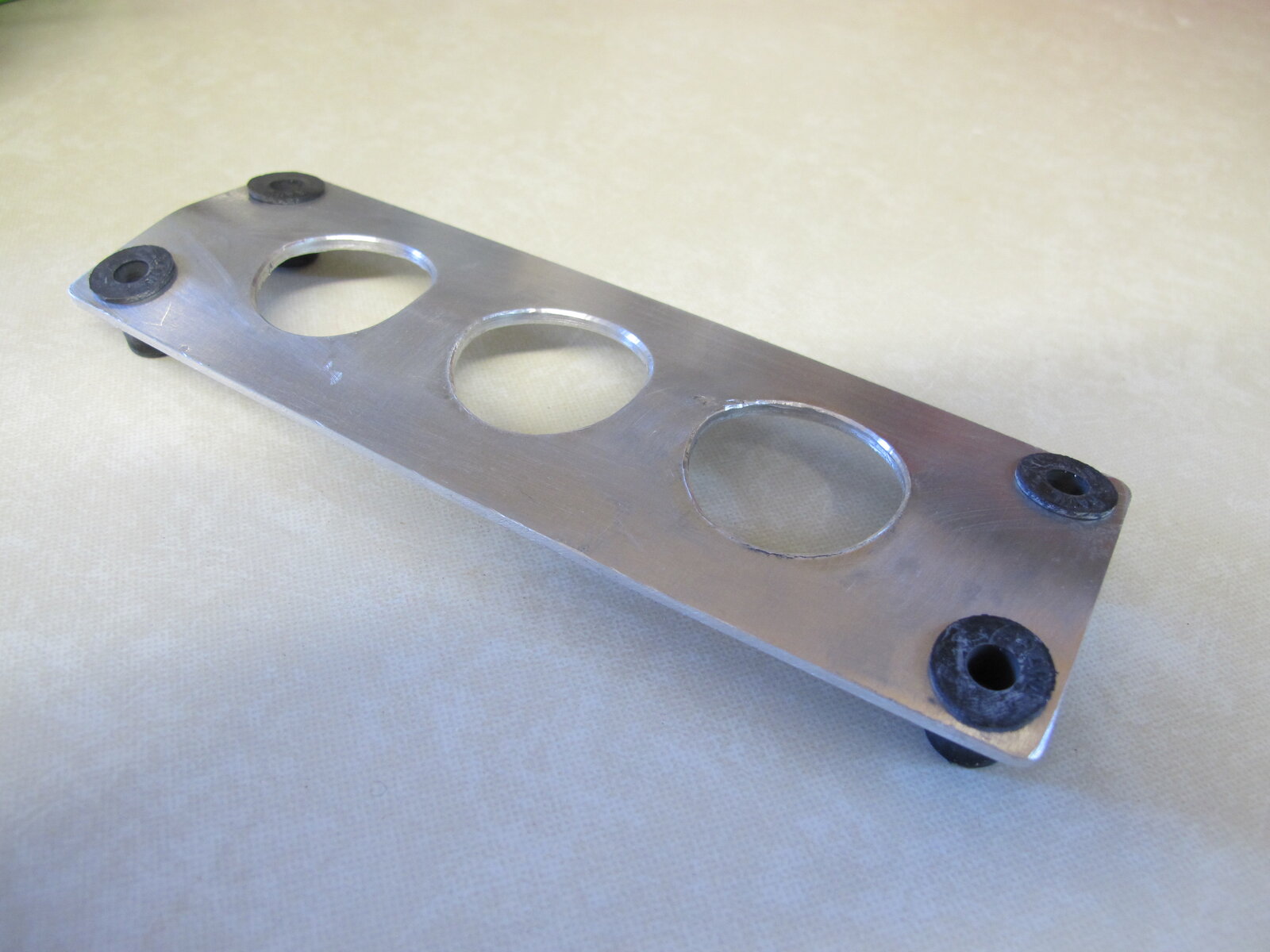

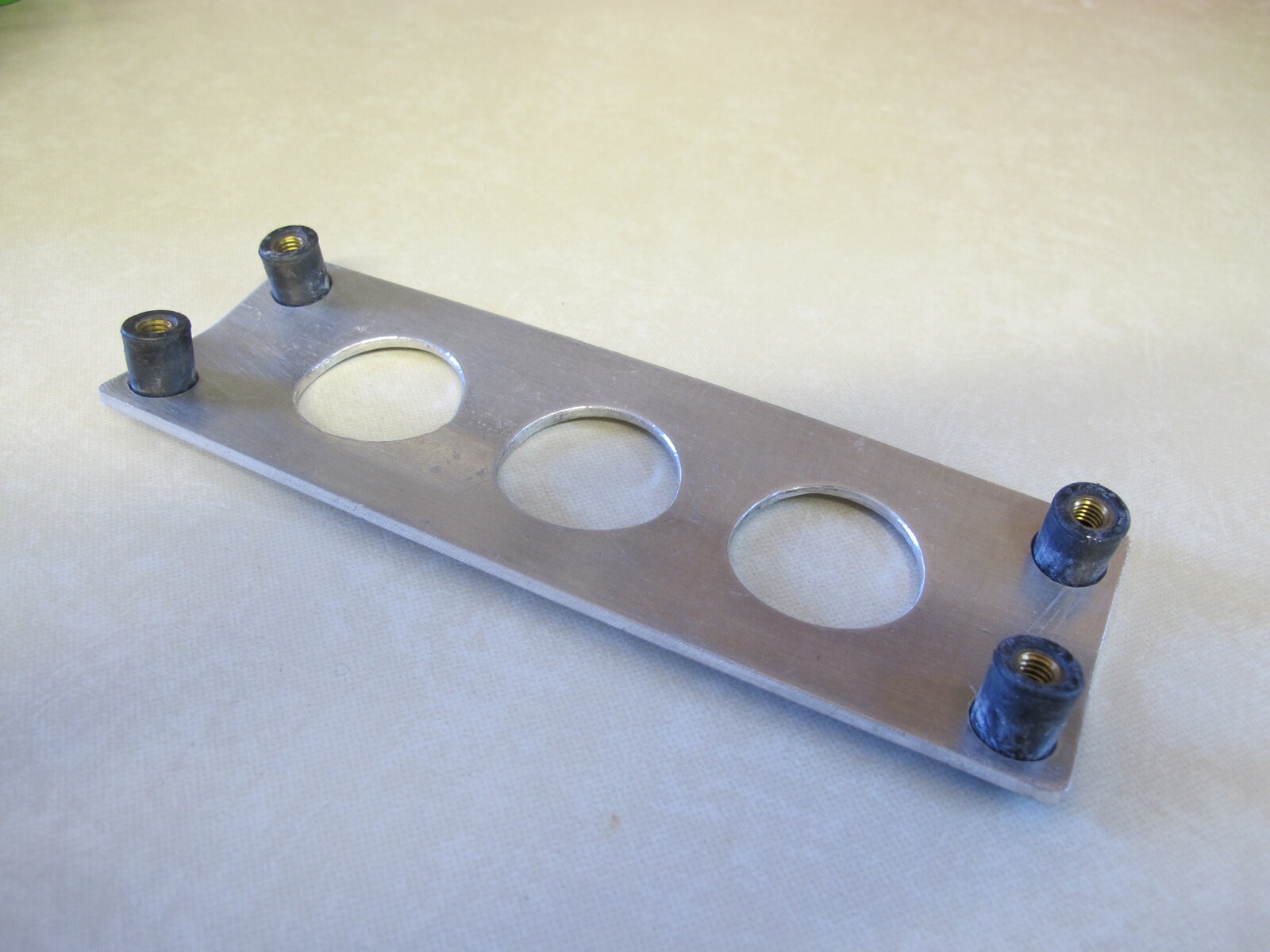

  4. Talking of improving brackets - one of the few things I really disliked was the bottom well nut tab things that hold the bottom of the fairings together. The fairing can get itself slightly out of line, what I really wanted was to make a single alloy bracket - which I made this morning.
    (maybe... thinking about in now - I should have made provision for 2 more well nuts making 6 in total?? nahhh, its done and its lovely and firm)
    Well chuffed

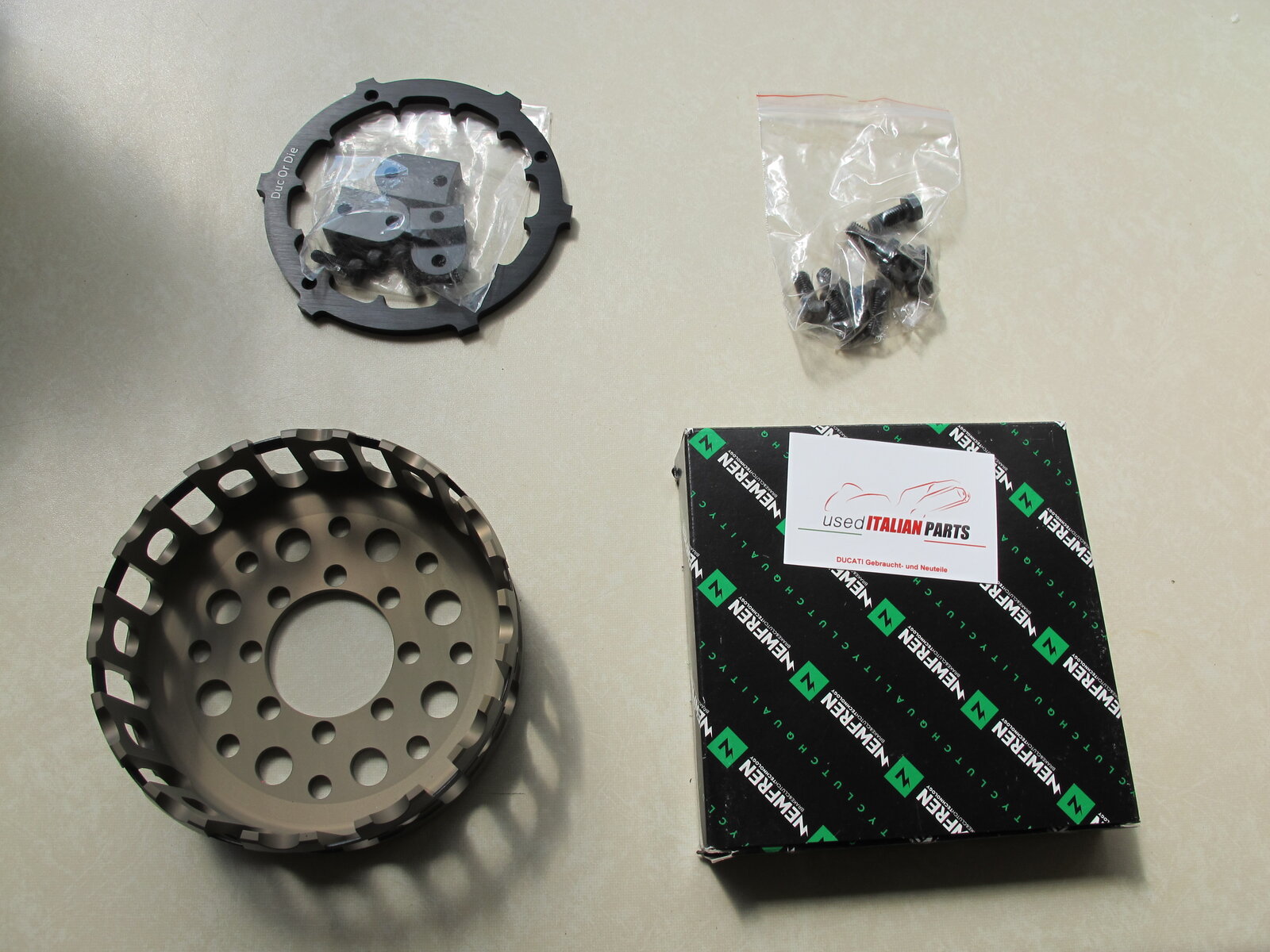

  5. The clutch plates and basket are both 90% worn, I was looking at my options and came across this alloy kit from eBay £170 delivered. I'll give it a try - the quality looks great, the plates fit well - I'll report back on the fitment and ride.
    … once a new battery arrives... Doh!

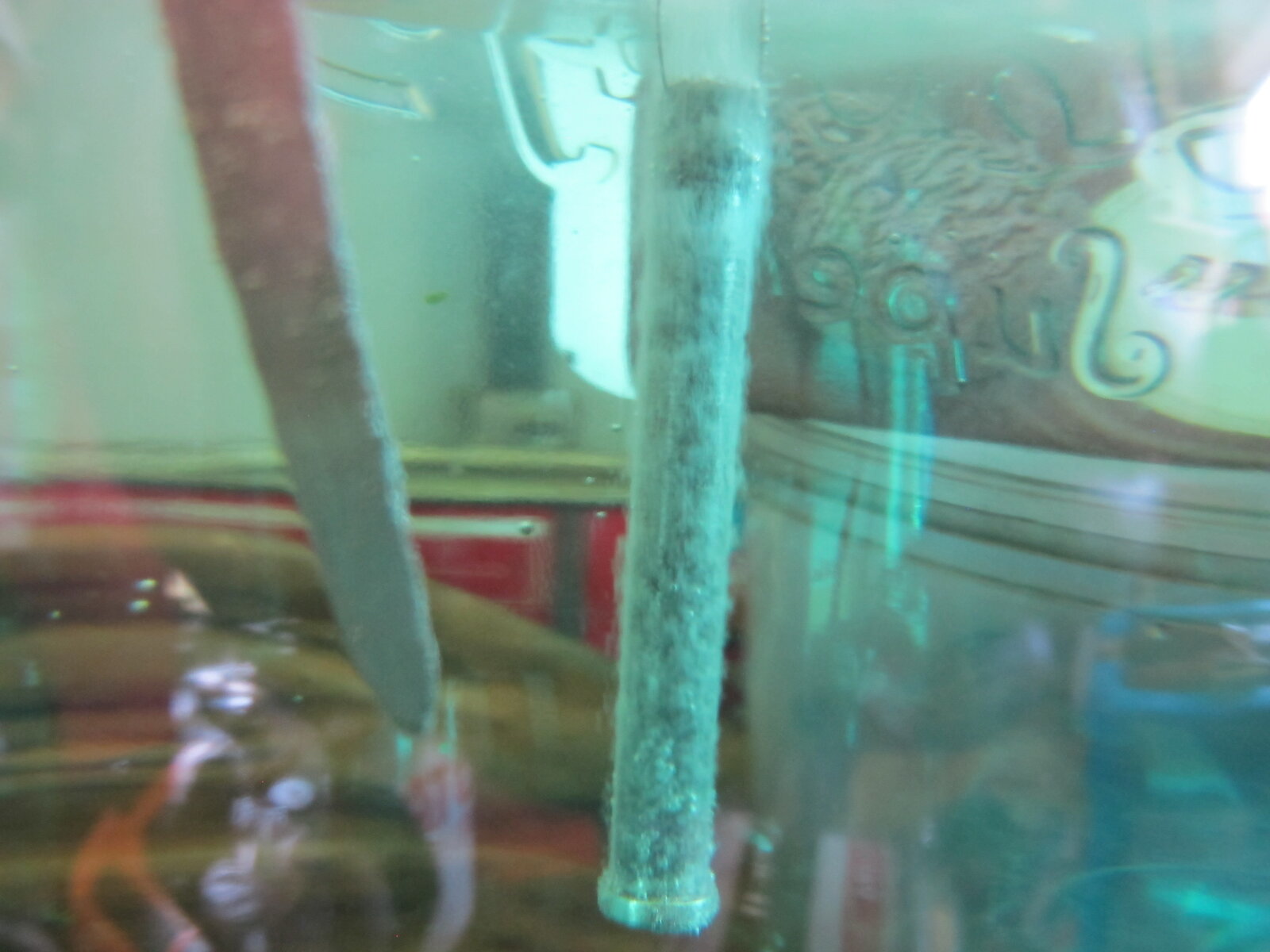

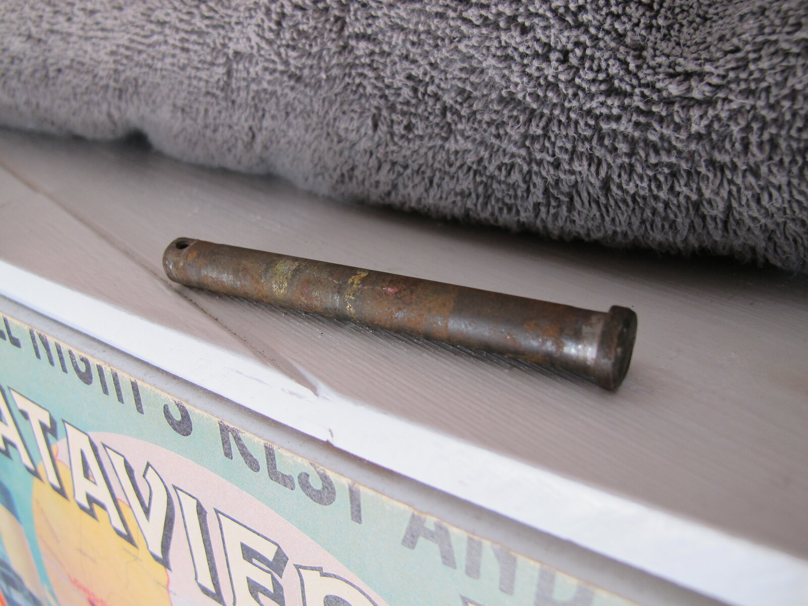

  6. The tank hinge pin always gets grubby/rusty, so I put it in my DIY Nickle plating plant (glass jar + mobile phone charger) for a layer of rust resistant Nickle.

  7. Looks interesting - can you show us the "after" results?
    So just a glass jar, and mobile phone charger?
    What is the exact process, and how long do you leave it submerged?
  8. Sorry for not replying sooner CK - The attached vid covers what to do for a basic kit very nicely.
