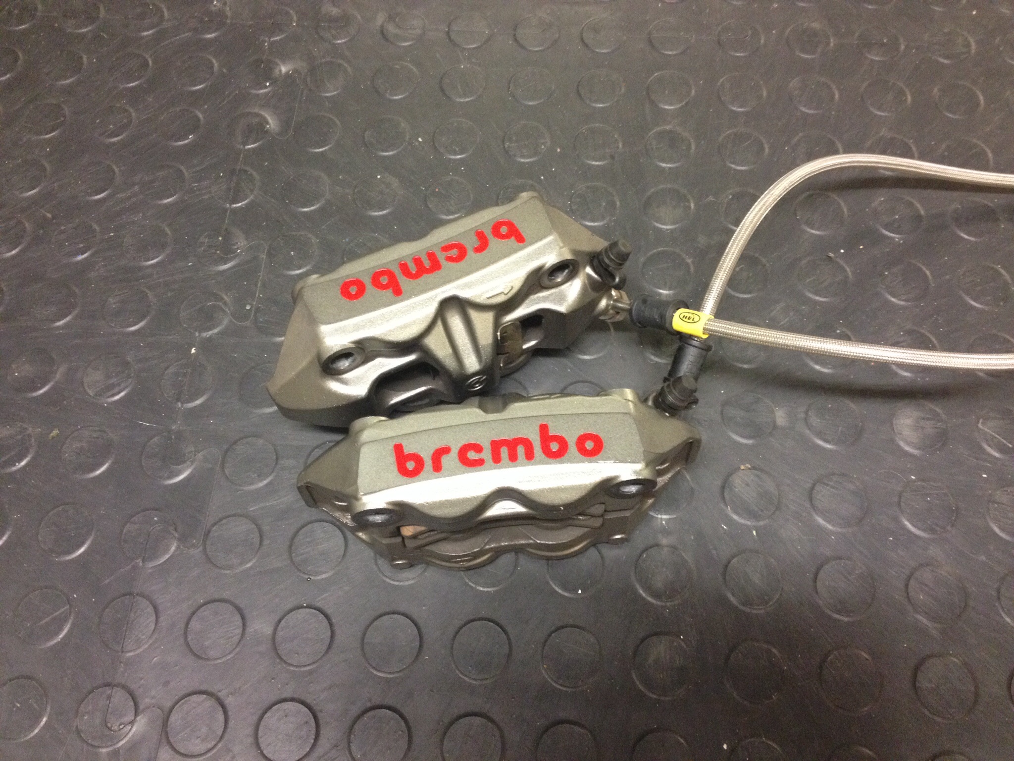

  3. Do you still have de M4 bembo's for sale ? What is the diameter op the pistons ?
  4. sorry they are sold

    My issue is feel. The OE set-up just doesn't have what I like. My 21 year old 900 Diversion surprises me every time I jump back on her with a firm, solid feel to the brakes that shoots feedback up my arm. My Multi by comparison has soft, spongy feeling brakes which at a standstill I can pull back to the bar. She's always been that way and no amount of bleeding, adding of bleed nipples or change of fluid has changed it.
    Since then I've ridden an 848 Evo with M4 calipers and ABS. That bike had so much feel from the front brakes that it makes me feel that Icould stop faster even if in reality it is all still down to the grip of the front tyre. I want that feel on my Multi and with the M4's all the components are now the same as that 848 Evo.

  9. I'll be keen to hear your assessment. Hope you aren't disappointed. Andy
  10. I can already tell you that the M4s provide better performance and feel, as will MJW.

    400 quid for much better stoppers is IMO a no brainer, and much better money spent than for example on a bit of carbon.
    Longwayhome, I am sure you will be pleased with them :)

    As an aside I may have a set available soon, with pads & modified lines included

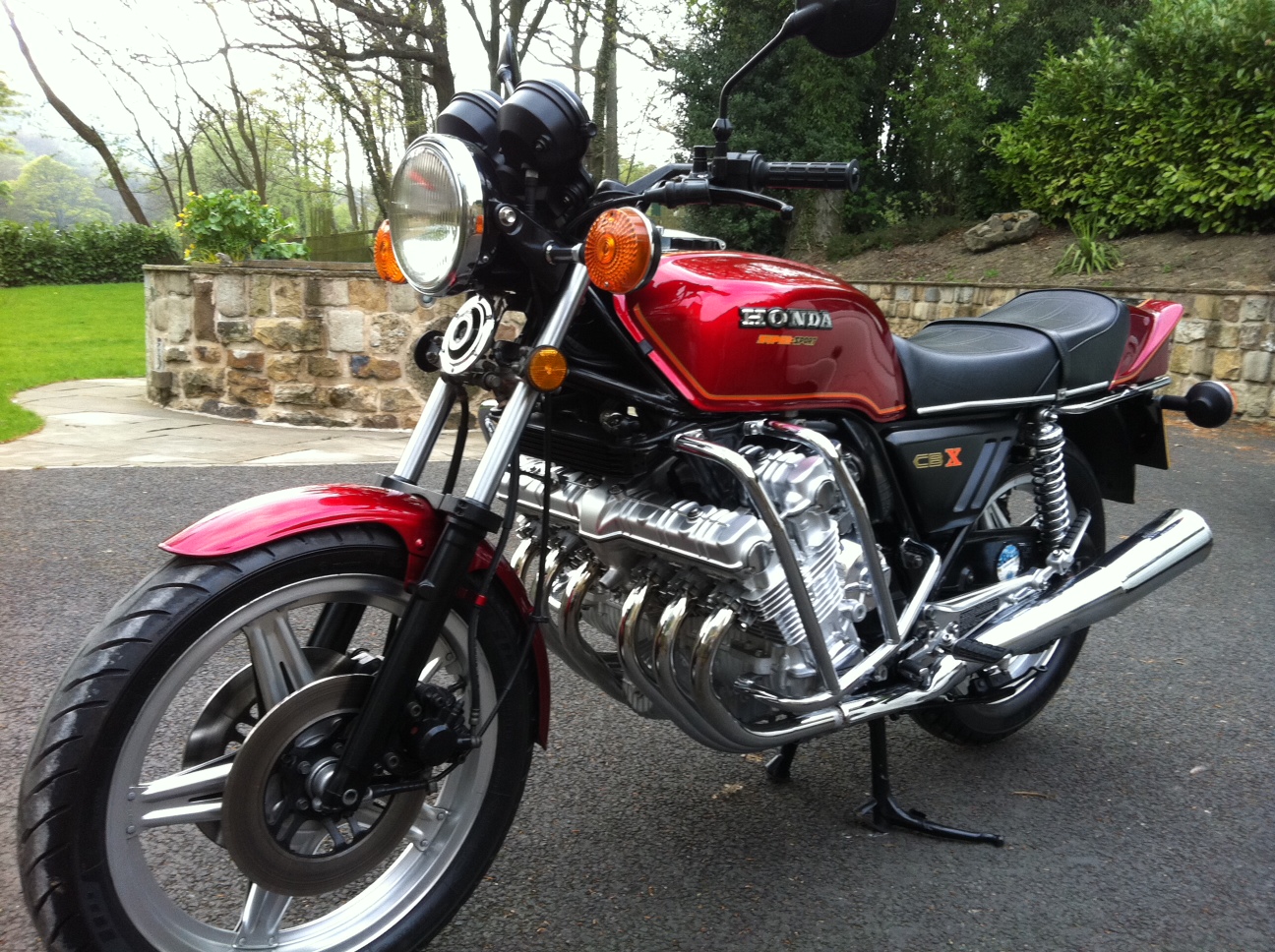

  19. Or My 1979 CBX1000Z !
    6 Cyl two wheel coach with wooden brakes as I call it!!
