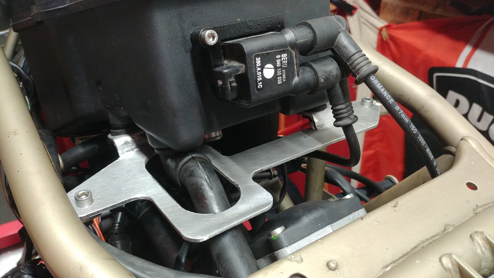

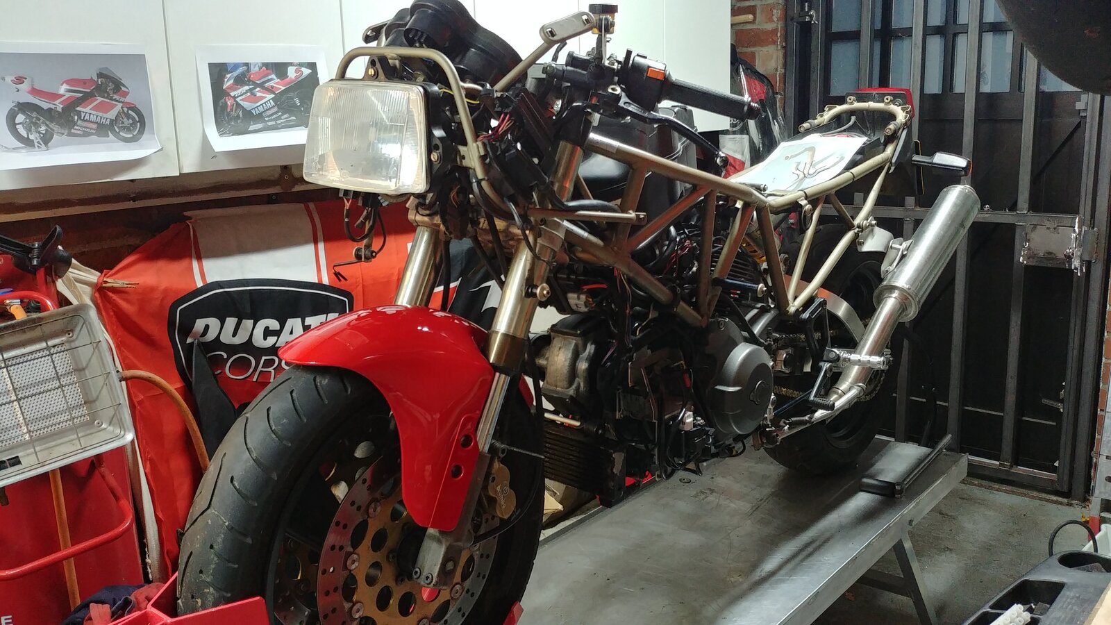

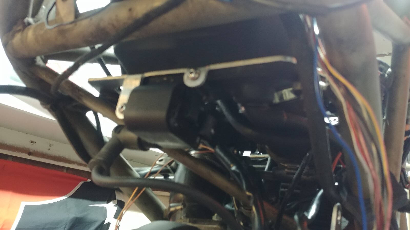

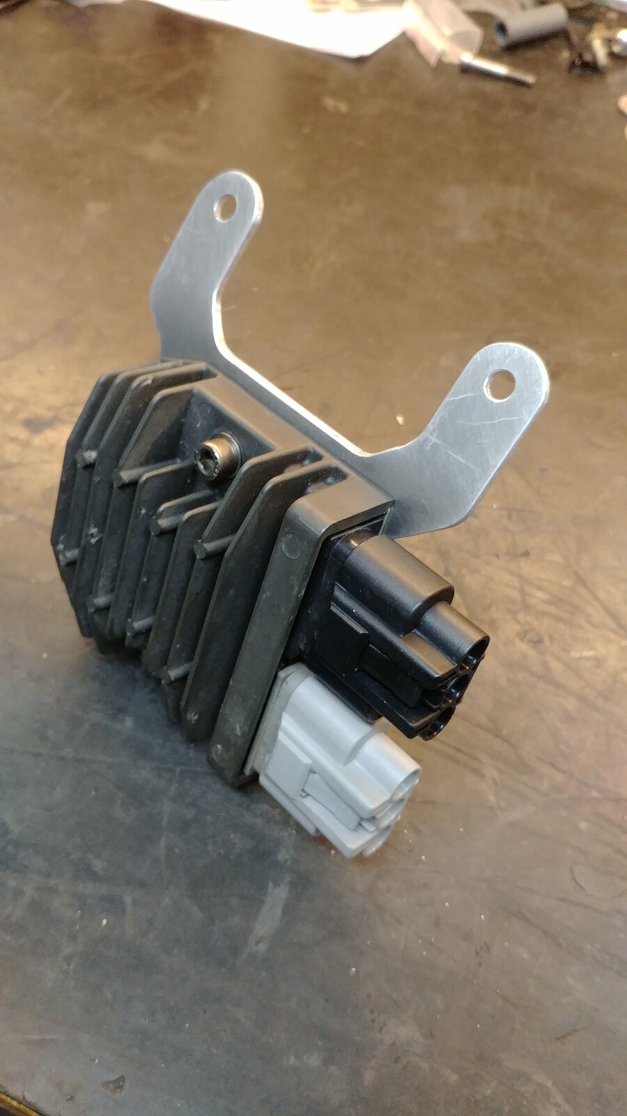

  3. So, a bit of an update. Lots of time spent on this conversion over the past weeks.
    1. Wiring was the biggest job, but is now done.
    2. New airbox mounting brackets fabricated, including mounts for the ignition coils.

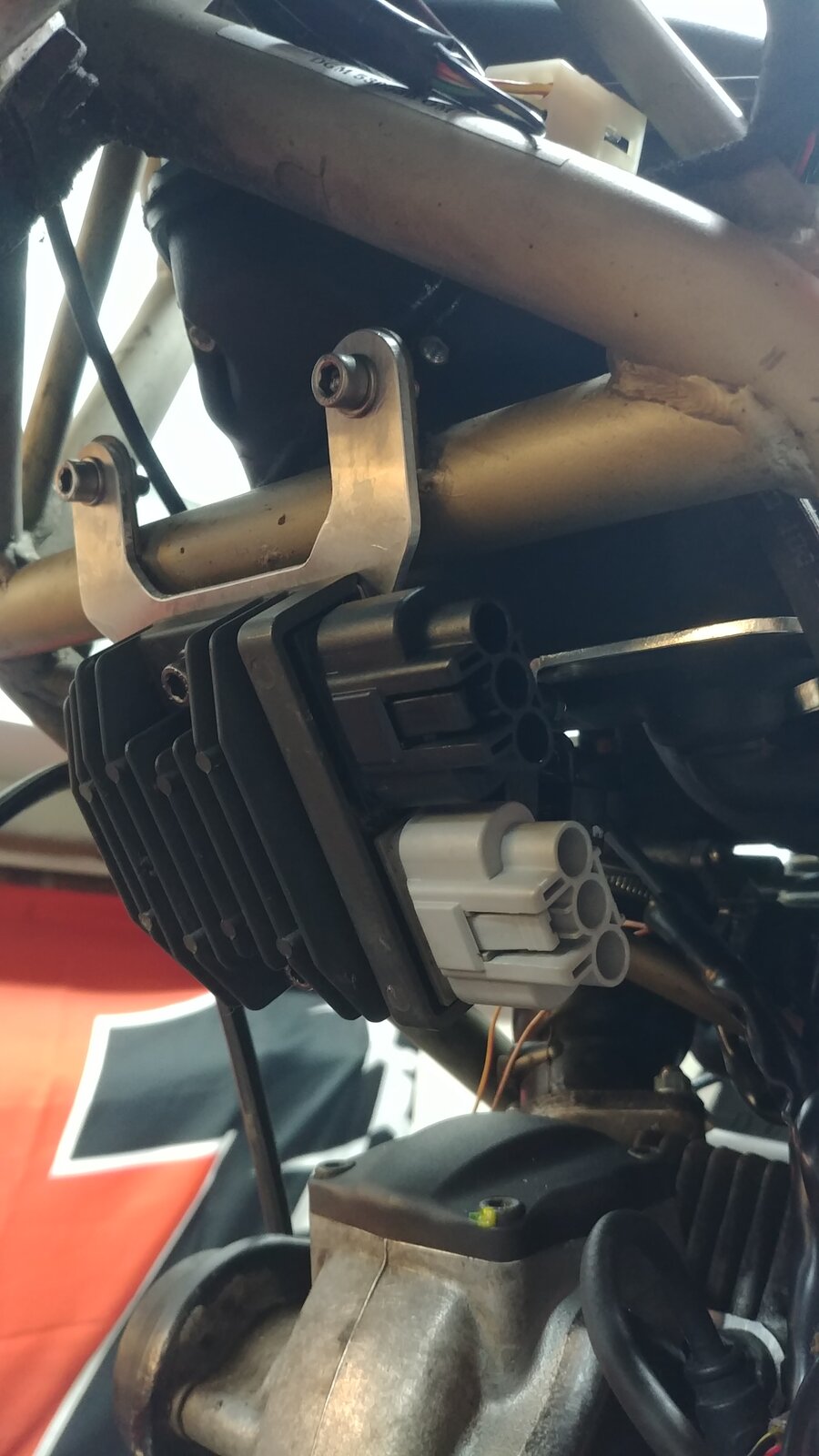

    3. New reg/rec wired in and bracket fabricated.
    4. 749 ECU reprogrammed to remove immobilizer, run without a dash, and to match the new loom (originally from a Streetfighter). 20191211_152955.jpg 20191211_153905_HDR.jpg 20191214_144100.jpg 20191214_145500.jpg It's now ready to get new header pipes made. 20191216_161708_HDR.jpg

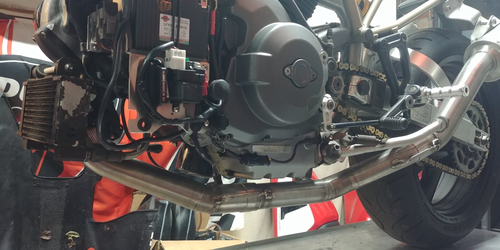

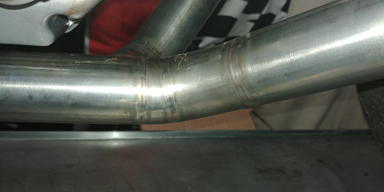

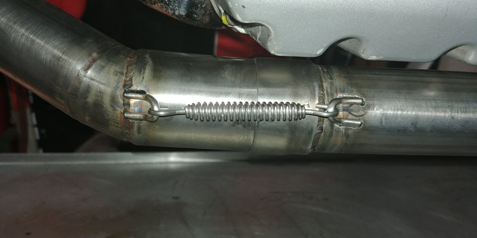

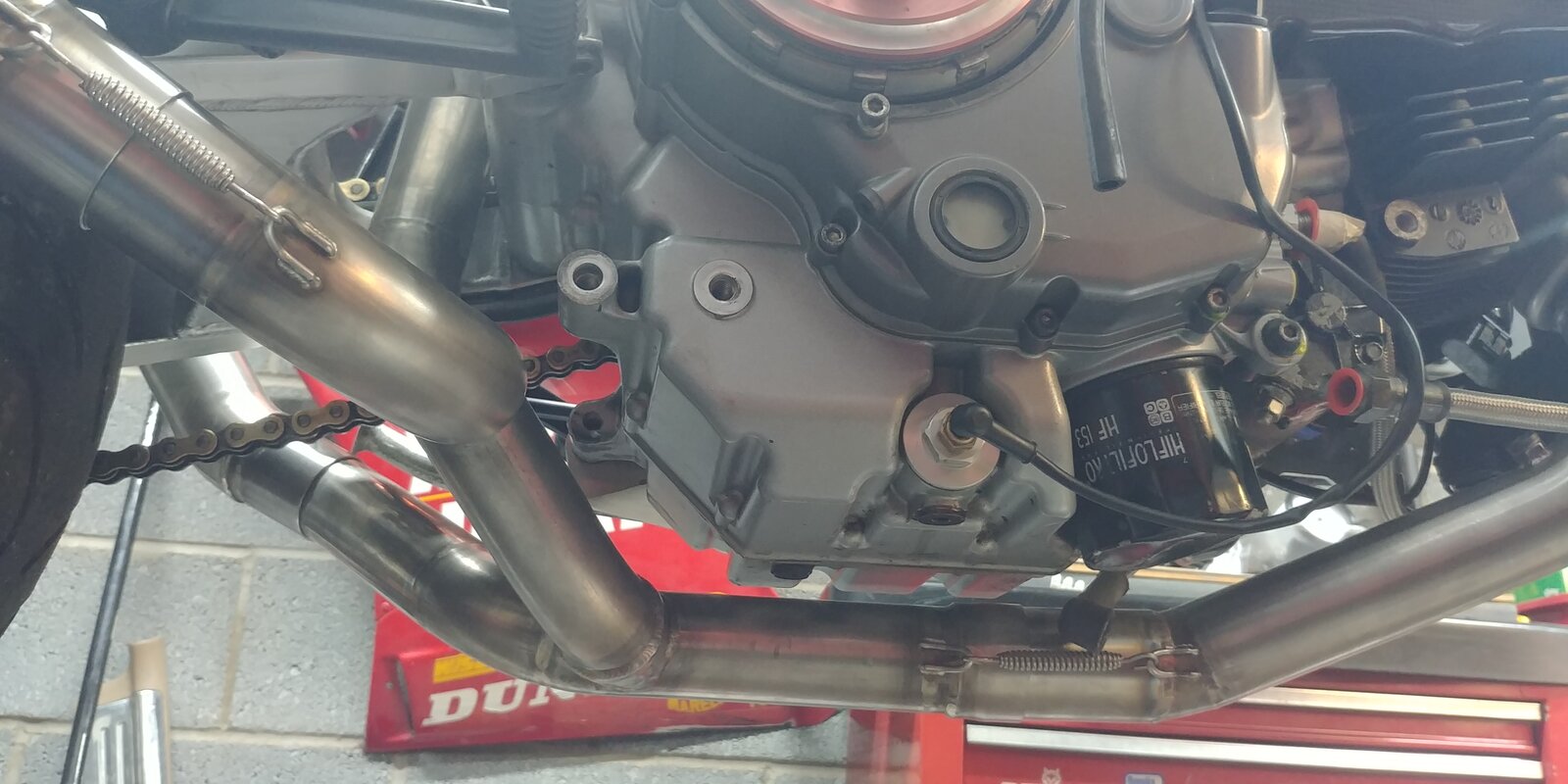

  4. After much thought and evaluating various quasi bolt-on exhaust headers, I decided to get a system made from scratch. Using stock 1100 header stubs, it runs equal length headers to the existing silencers with a balance pipe, all made from 1.2mm thick stainless steel. 20191230_205438.jpg

  5. That's tidy work felix, really nice.
    Hedstock Reg/rec mounting is just so right - why wouldn't you put something like that in an area of high airflow away from sources of heat.
    I'm glad you went to the extra effort of using proper springs on the exhausts rather than shitty clamps.
    Nice transitions as well. :)
  6. As a matter of interest, when the fabricator was making up the exhaust for you, did they have the complete bike with them? Just wondering how they know how much of a bend to put where so it all fits. Nice job they/you have done:upyeah:
  7. And Happy Birthday Felix :):upyeah:
  8. Yes, they had the complete bike including fairings to make sure it all fits. And, yes, the quality of the welding is superb. Can't take credit for that!
  9. Nice exhaust!
    I find it hard to find suitable pipe with 1.2mm thickness in stainless steel. May I ask for contact details for the fabricator?

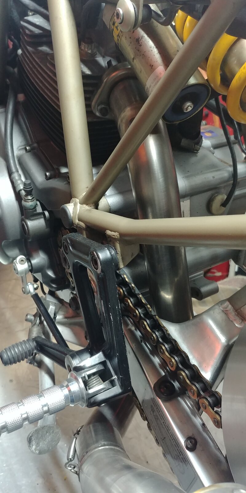

  10. Hi again, some comments to your 1100 engine transplante.
    * I would recommend you to remove 5mm from the spacer that sits inside the front sprocket in order to get better alignment between the front and rear sprocket.
    The 1000 SS had a special spacer 713.1.204.1A length 14,5mm instead of 713.1.157.1A/713.1.393.1A length 19,5mm found an all other 1000/1100 engines.

  12. The front sprocket spacing is all sorted.

  13. Yes, a bit more difficult to come by than the more common 1.5 wall tubes. Best place I've found is Goodfabs. I think the fabricator got it from there.
    Exhaust was done by CSK Race Exhaust in Pocklington. Very reasonably priced, too. Here are a couple close-ups:
