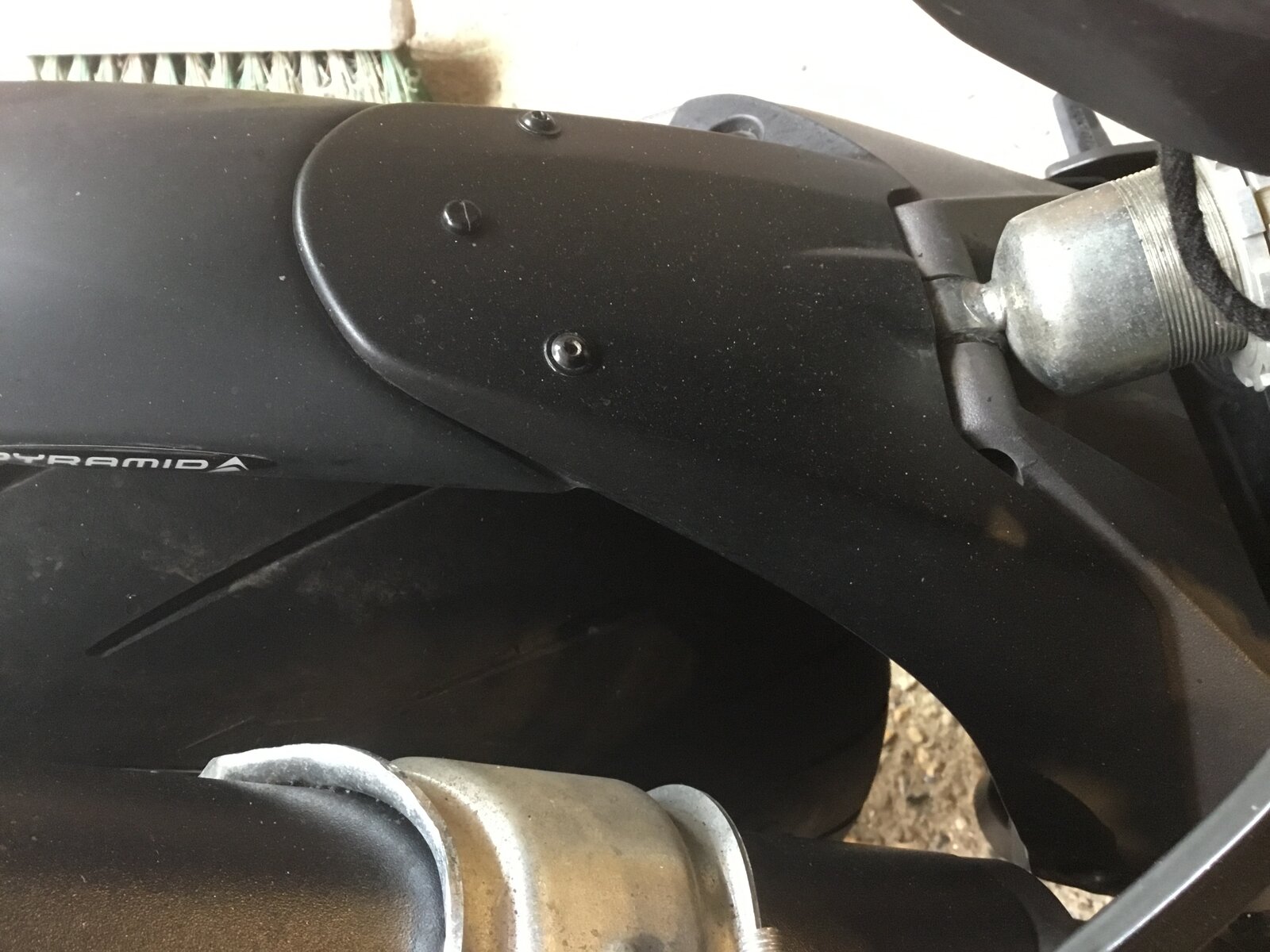

  3. I have a pyramid fitted to my M1200, it helps but is not 100%.
    You will need to remove the hugger if you want to fit it securely.
    Don’t risk drilling through the hugger into the tyre.
    I used 3 x m5 stainless button head screws with nylon nuts and washers, with a thin coat of silicone sealant.
    As much as they claim that the sticky pads work I do not trust them.
    If you want me to send a picture let me know.

    Is it much of a faff to get the hugger off to do this? I'm looking at the same extender and would look to fix it on securely.
    A picture would be useful.
    Thanks
  7. No just a few Allen screws, take the hugger off and give a good clean.
    I use isopropanol alcohol to get the mating surfaces grease free.
    Offer up the extender and drill 1 in hole in the centre, put a screw in to secure the extender.
    Then drill the other 2 holes, place a screw in the second hole to keep it all aligned.
    A light coat of silicon seal between the mating faces refit all screws and tighten up.
    Cut off any thread extending through the nuts. Replace the hugger put a dab of loctite on the screws.

  9. That's great, thanks for the pic and guidelines. A carbon fender extender arrive today that I will attach to the front this weekend. My last bike, an Aprilia Shiver, came with a full complement of R and G protectors, plus a hugger and fender extender. I now realise the time and money involved in making a bike more practical for daily use!
