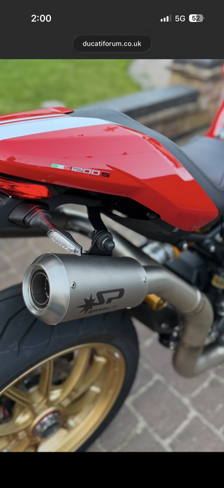

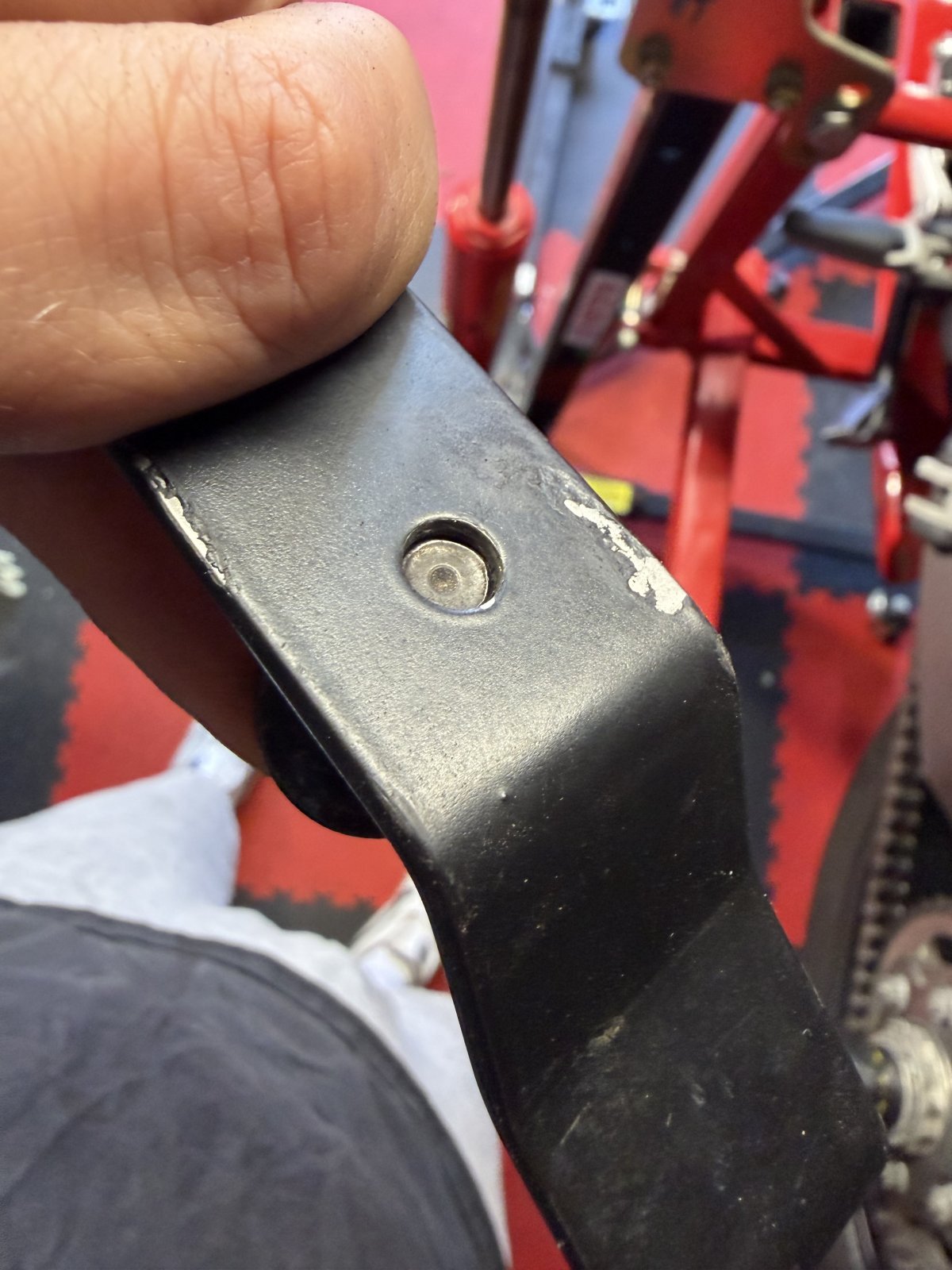

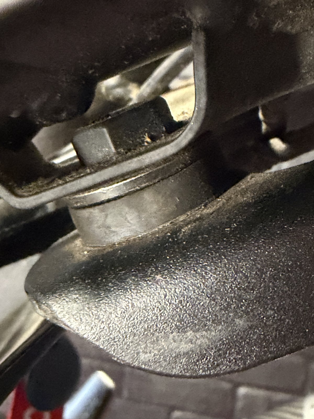

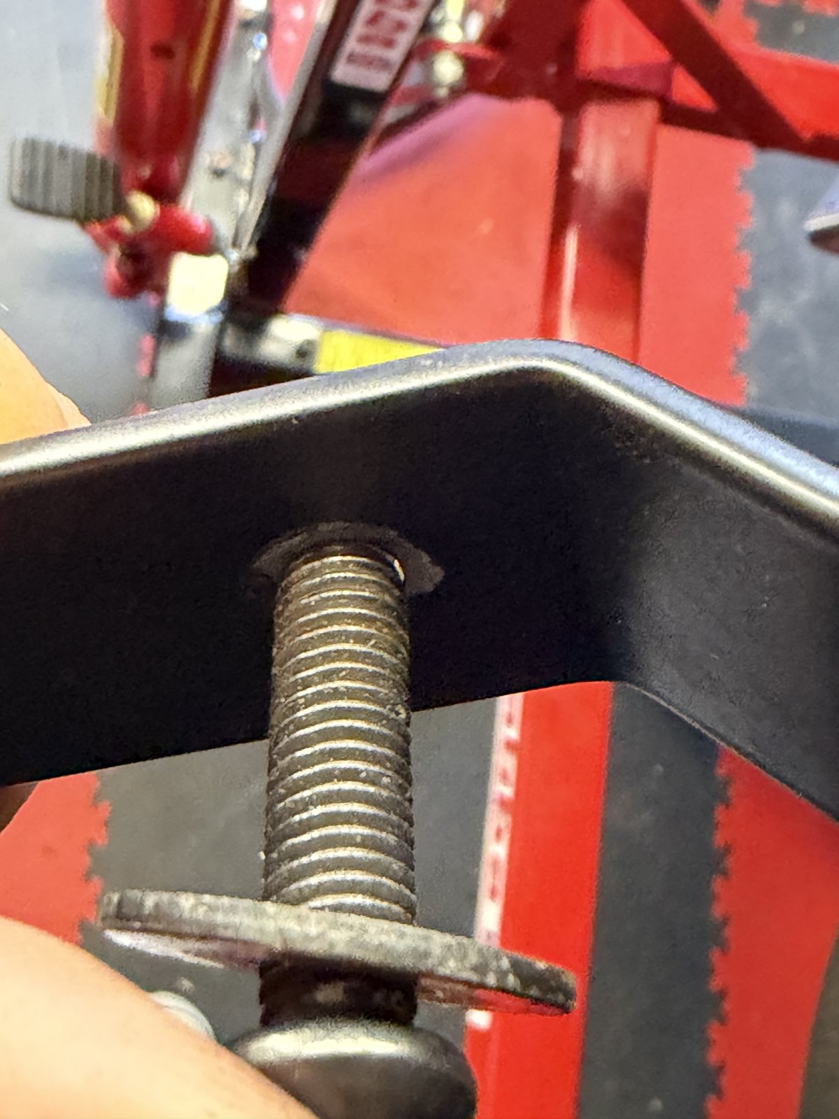

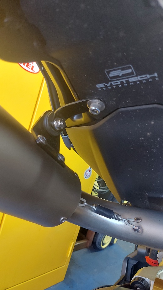

  1. IMG_2890.jpeg IMG_2891.jpeg IMG_2892.jpeg IMG_2893.png So I've seen a few people on here have fitted them with the evotech tail tidy. However the bolt that goes through the tail tidy and into the bolt in the frame is a m8. I would assume these bolts from factory would be m8 hence the m8 nuts in the frame being m8.
    However the bracket that holds the spark exhaust on has a hole way bigger than a m6 but ever so slightly smaller than a m8. Did people have to widen this hole slightly?
    any help is much appreciated

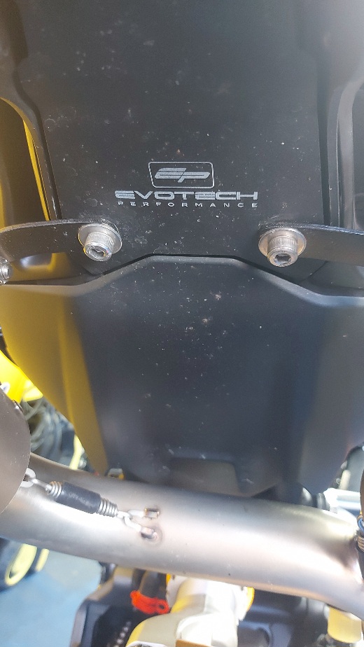

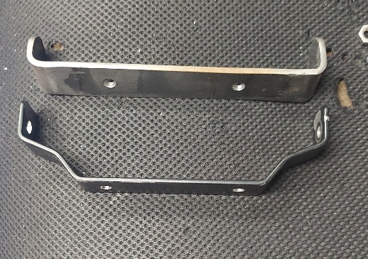

  2. I made a new bracket for mine which lifted the system up 20mm.
    Reason being cross over pipe broke my hugger

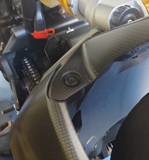

    Even with the 20mm it has touched my carbon hugger.
    I made the one piece one first then went to 2 individual brackets.
  5. I put the original back on after it broke the carbon one but then noticed a few marks on it but it's definitely got more flex than the carbon one I then ordered a good second hand one should I ever take the spark off.
