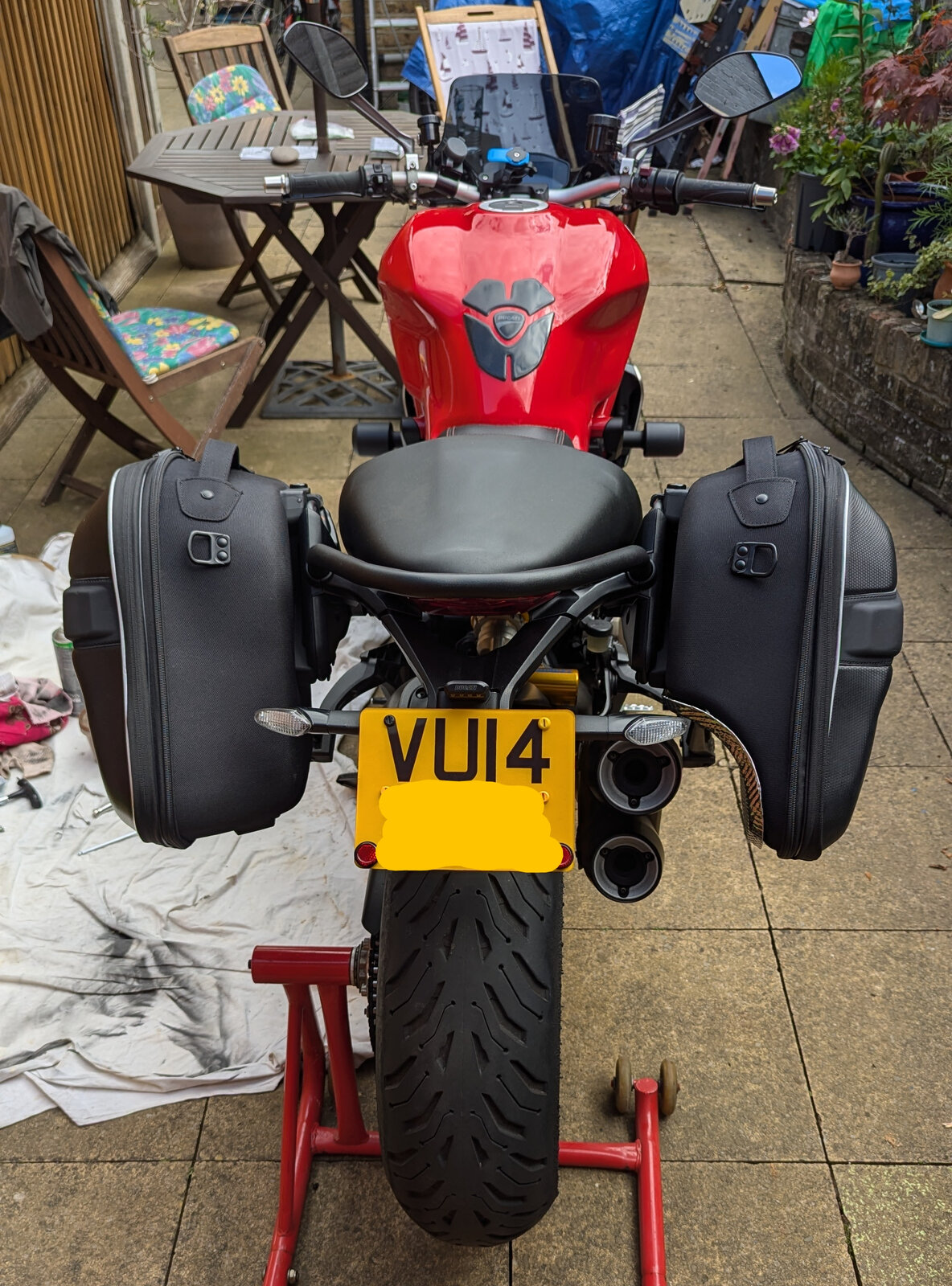

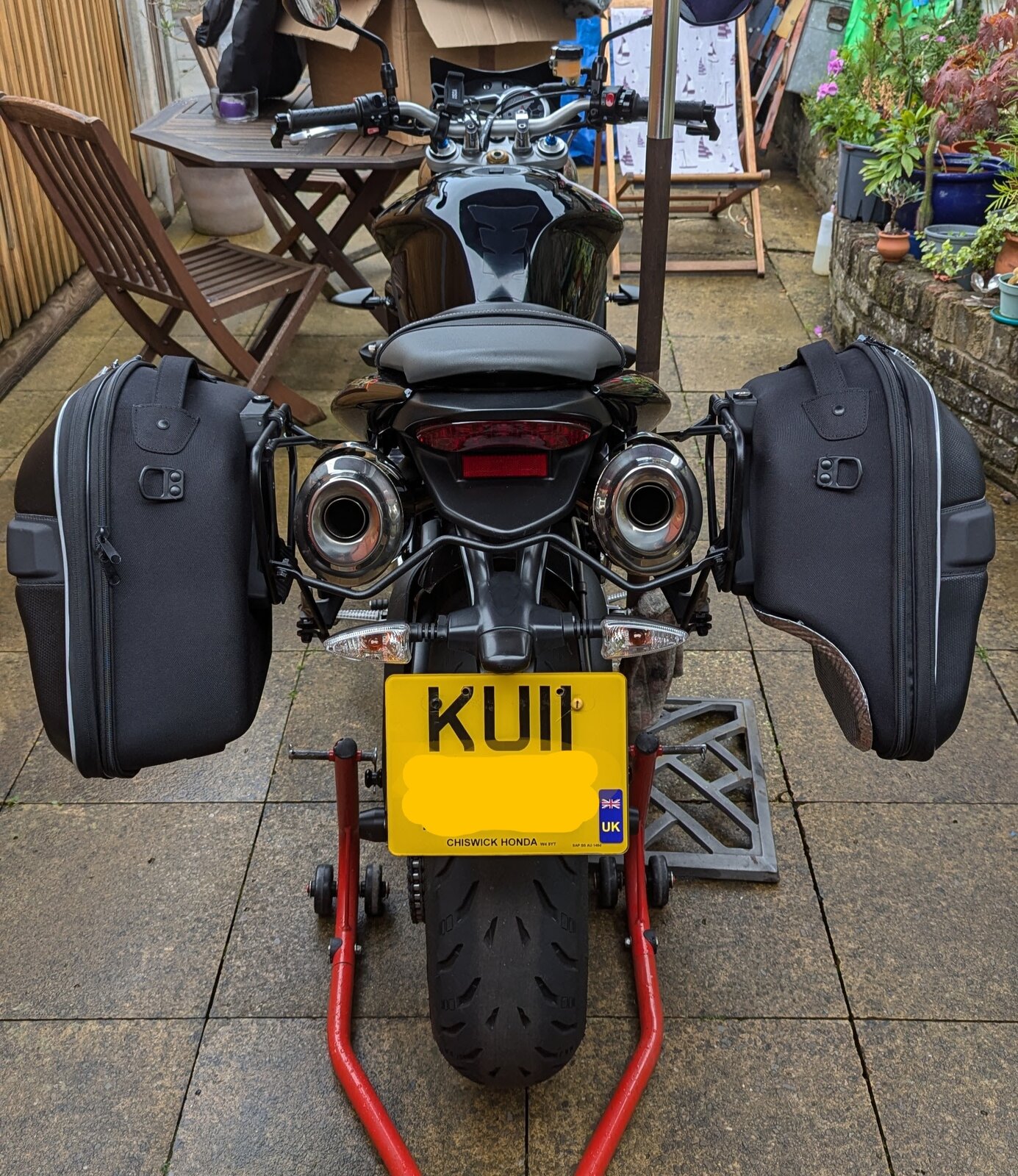

    I'm in a slight quandary (1st world problem); having just ridden to the MotoGP at Assen the Monster 1200s was great on the long sweeping roads but more of a handful in towns and requires slipping the clutch in traffic. I have the option of using this with Givi panniers or a first generation Triumph Street Triple 675R which can purr along in low revs in traffic but would be less ideal on the long route across to the ferry. In Ireland we plan a leisurely ride taking in the scenery and stopping off in small towns and villages so the speeds will be low, it will be all about the journey.
    So my question is, particularly to people who may have both bikes or something similar, which would you choose and why?

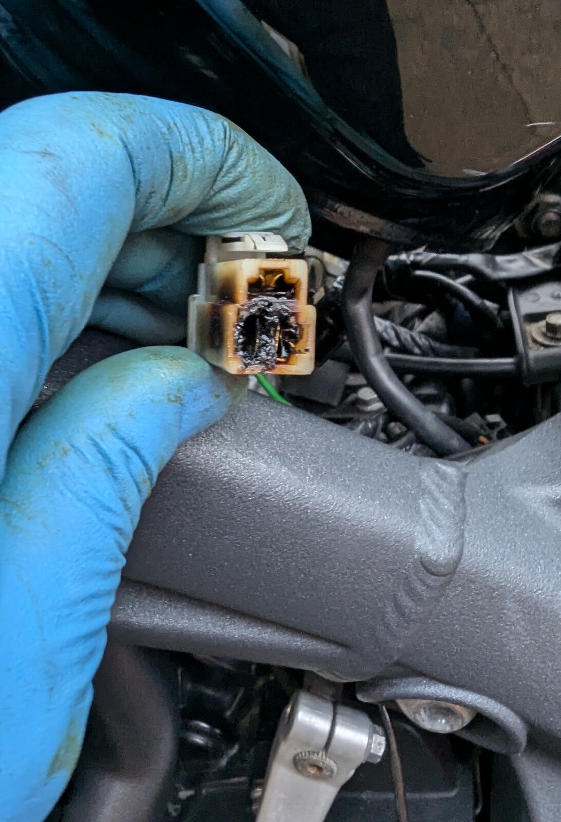

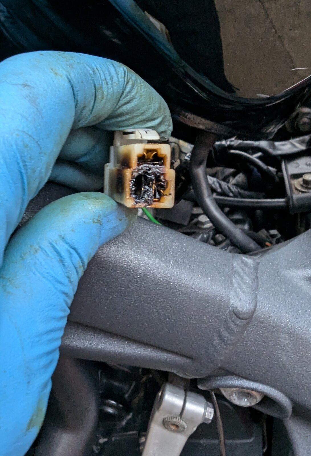

    The choice of bike has been made for me; looking to fit a USB socket I lifted the tank and checked the connection for the stator and regulator/rectifier I had fitted last year while I was there... PXL_20240710_183123747.jpg
    On the positive side (no pun intended!) I found this at home and not stranded at the side of a mountain pass.
    Much as I love the engine and handling of this bike, the whole charging system is a recurring problem on them.
    Monster it is then.

  7. It's funny isn't it, I know people who had them from new and never had a problem.
  8. It seems entirely the luck of the draw.
    It is the longest thread on the street triple.co.uk forum. This one was just too late for the recall to have it fitted by Triumph. I'm hoping I can fix this by hardwiring this connection and the stator isn't starting to fry again.
