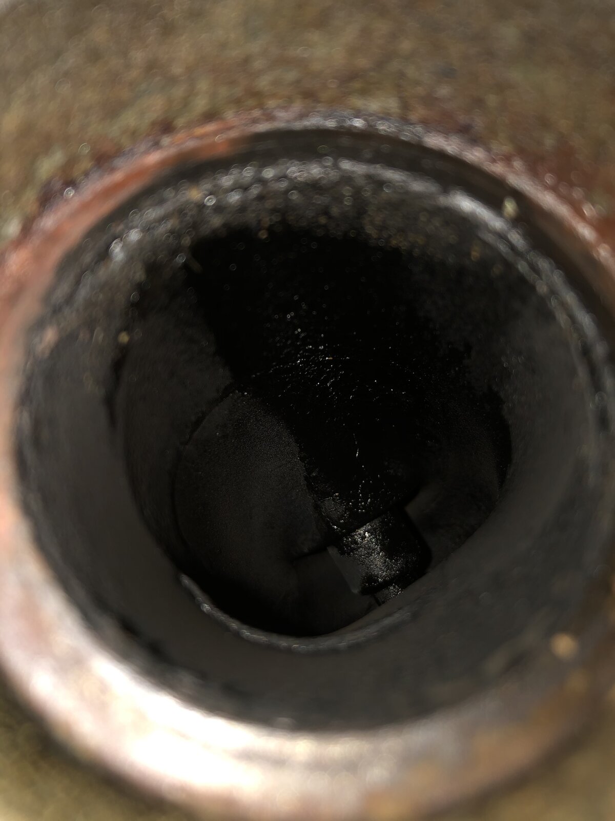

    Head is off. With the proper tool and a long bar, the nuts came off the studs with relative ease. Getting the head off the bike was a whole other story! That thing did not want to budge. Off now.
    here’s some pics. Very apparent that the piston and intake valve got intimate. I’ve cleaned the piston face with some carb cleaner and a toothbrush. The deposits came off easily but at only 1100 miles, not surprising I guess.
    Here’s the thing, I’ve popped el-valvo out and gently clamped it in a drill and hit go, and it seemed to spin fairly cleanly. Whilst it was in the head, it didn’t seem to bind anywhere as I rotated it however I did note that as I rotated the pulley and each valve went in and out, they both twisted ever so slightly as they travelled. Maybe that’s normal? The pic here is looking in the exhaust port and there’s clearly some sticky goop in there. Not wet, sticky. Should I be investigating the exhaust side then despite the contact clearly being on the intake side.
    Finally, the piston clearly has some marks from the valve and if I run my finger over them there is a ripple, but no obvious cracks or major gouges. I’m guessing therefore that replacing the piston would be a bit excessive. What should I do about this? I’ve heard that some emery cloth could be used but I wonder give the small amount of damage if it’s worth doing? Introducing scratches etc...

  18. Roll the valve stem along a flat surface with the head hanging over the edge. You will soon see if it bent.
  19. Put some grinding paste on the valve and try lapping it in, you should see any shiny and dull spots on the valve seat, should show whether it's seating correctly.
  20. as above, worth studying the shaft of the valve to see if worn unusually as could have damaged or cracked the valve guide. Looking at contact you will be lucky if valve not bent as a result. Could we have a pic of valve seat(s) in cylinder head also please?
    valve rotating during cam actuation is fine, it's even a good thing provided rotation is slow.
