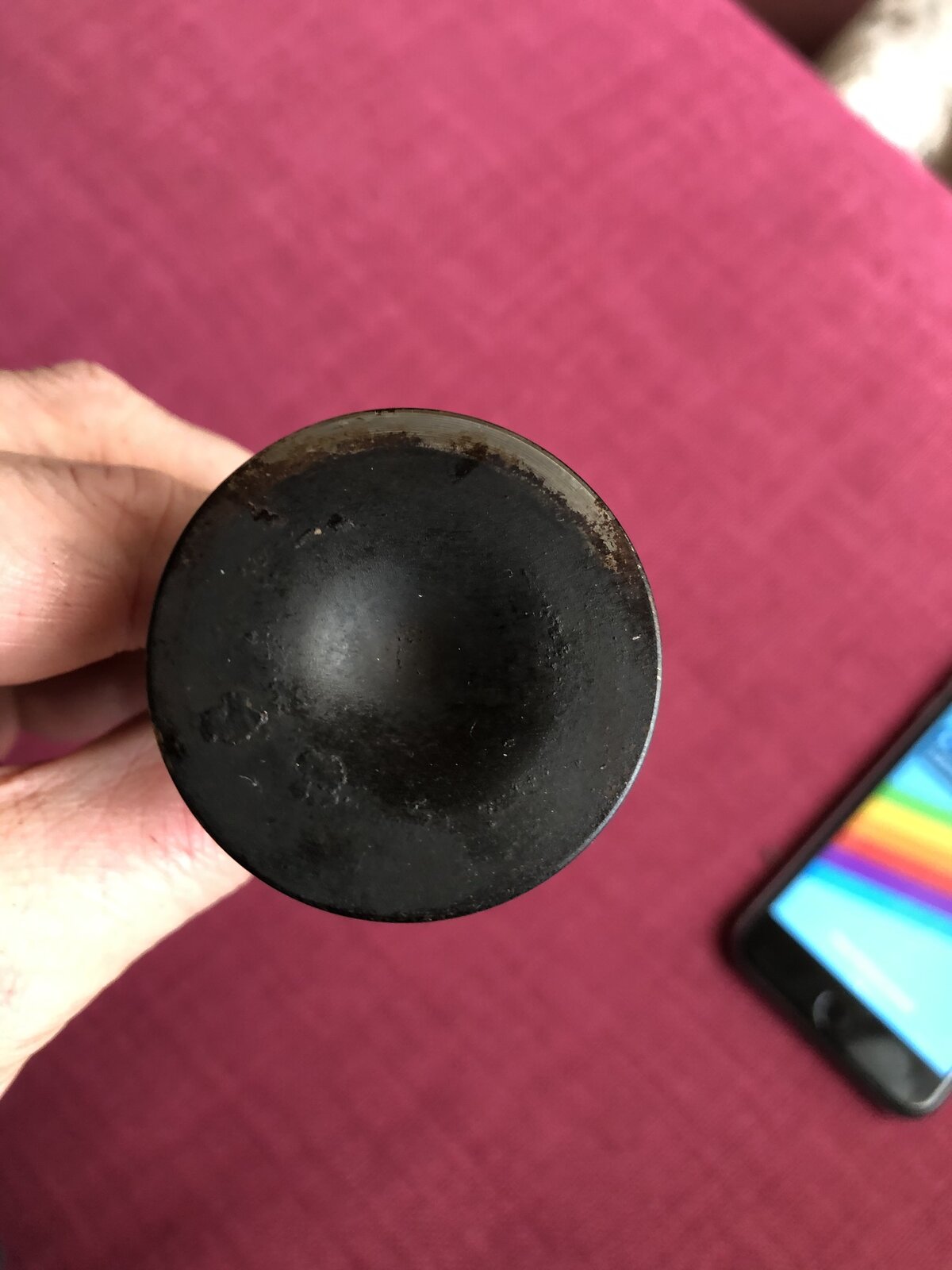

  1. thanks, am I looking for the stem to not be flush with the flat surface when doing so or looking for the valve end to wobble?

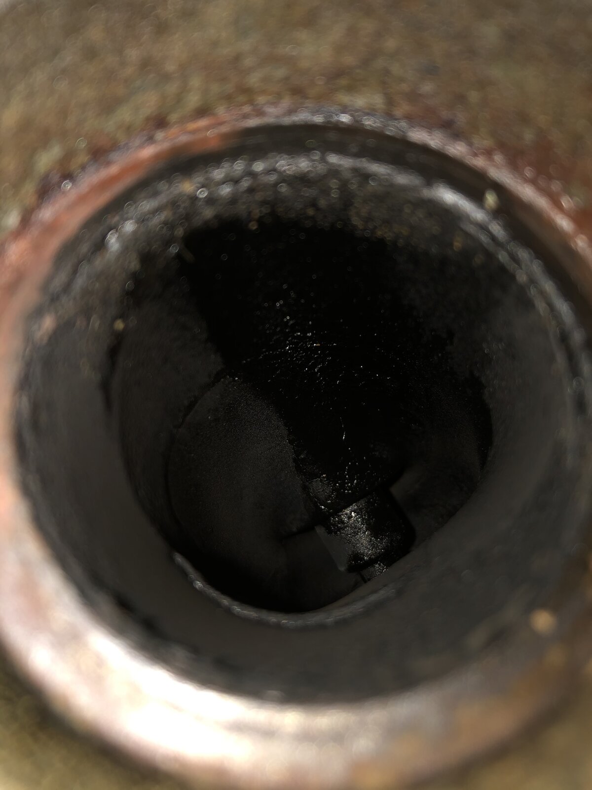

  3. can't rule out your last point but far more likely to be an inefficient valve stem seal/cracked valve guide due to valve touch on piston. If this was down to valve not sealing well you would see more carbon but the build up and black stain trailing visible from the end of the valve guide in your "through the port" picture is pretty conclusive.

  6. Keep the stem flush with the surface, if the valve is bent the head will wobble. Keep the shiny part of the stem (that runs in the guide) on the flat surface.

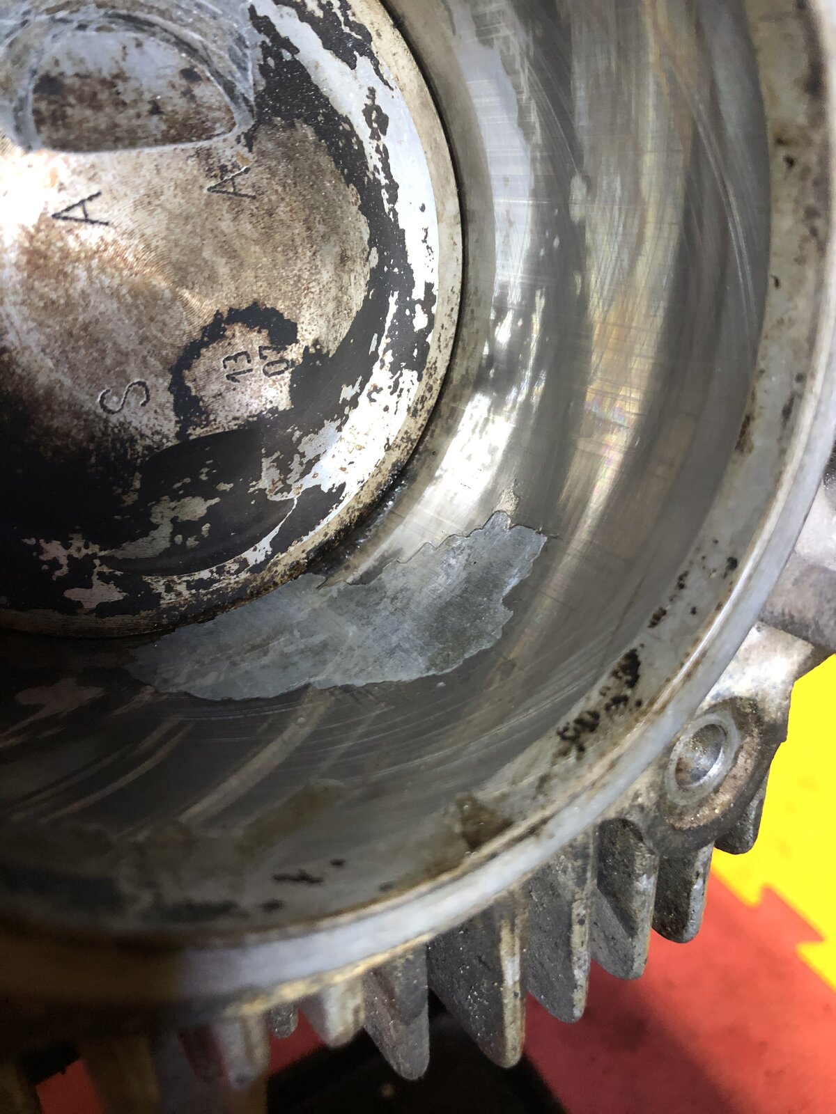

  7. Balls. I’m guessing this is the cylinder coating knackered. New barrels needed I guess??
  8. Well that's one of your problems anyway. That'll account for the burning oil, still the possible bent valve to sort.
  9. Presumably that little lip could be causing accelerated wear on the rings and allowing blowby??
  10. Totally fooked I'm afraid. You could send it to Langcourts and see if they can replate it. Good chance they can salvage it but won't be cheap. Think I'd be looking for a new barrel and piston/rings.
  11. There is a company that might be able to re coat the barrel, @Chris should know, Langcort or something similar.
  12. Damn, you are close Steve - I can't remember it, will search - @Pete1950 quoted it recently
    Found it:-
    http://www.langcourt.com/index.htm
    at Weston Super mare 01934 612226 - if they're still operating.
    sorry Hugh ^ overlapped with your post.
    #52 Chris, Mar 28, 2020

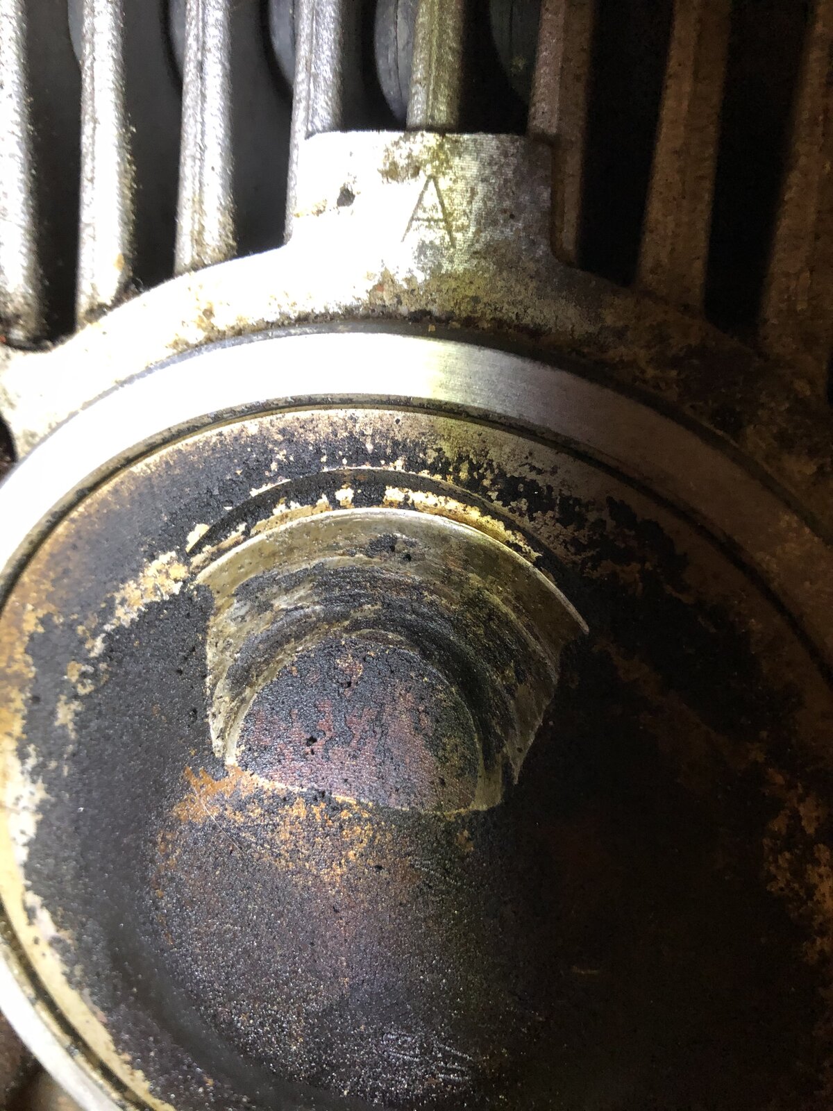

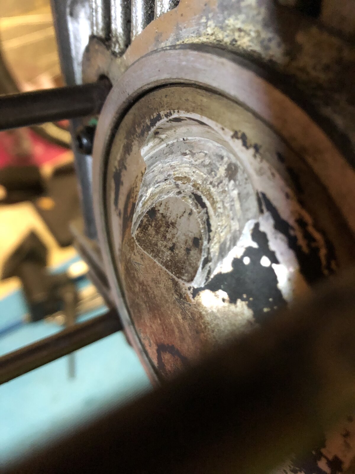

  13. I'm intrigued as to how that could have happened on an 1100 mile engine, even if it is a good few years old (2007?).
    I too am learning from this thread, these types of threads are always useful I find.
  14. That exhaust port photo makes it hard to believe your engine's only done 1100 miles! I guess that now you've shown the bore-plating damage that'd be a good reason so much oil gunk is in the exhaust. Shit barrel - a wrong-un since manufacture, or some other reason...?
  15. ahh.. as said by others, that changes everything sadly, but don't be put off as you could get all the bits good/second hand with patience and although prices may have changed, hopefully not too expensive.
  16. a good chance it's adhesion from corrosion/damp and moisture due to standing time. Is that on horizontal barrel on lower face by chance?
  17. It is, is that the most likely place for the problem you’ve described? Why would that be as I would have expected more oil in that area to protect it
