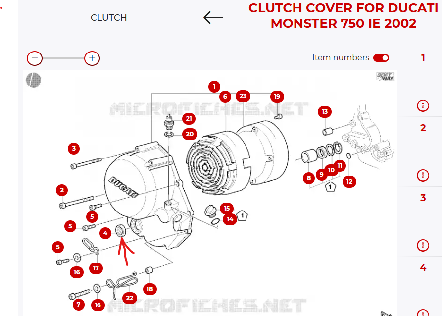

  6. I have a similar problem with creamy window, I notice people suggesting cleaning/replacing the window, can anuone suggest how this is done?

  7. This will almost certainly be due to condensation caused by temperature contrast*, and you don't need to clean or replace your oil-level "glass". Happens regularly in the UK when approaching winter. A nice long "spirited" ride bringing engine up to full temperature will banish this i feel sure**.
    *If your bike is water-cooled then check rad/header tank levels haven't dropped considerably, just as a precaution.
    **but worth noting that "creamy" window will probably be back when you look a week later if during cold periods.
    #8 Chris, Oct 24, 2025
  8. If you can trust yourself to remember to fit it before riding again you can take the oil cap off once it's hot to allow water vapour to escape.
    Or just go for a long ride.
    If you do want to replace the window you'll need to remove the side cover and either press it out or knock it out, installation is the reverse but with more care, no sealant needed just clean up where it seats.
