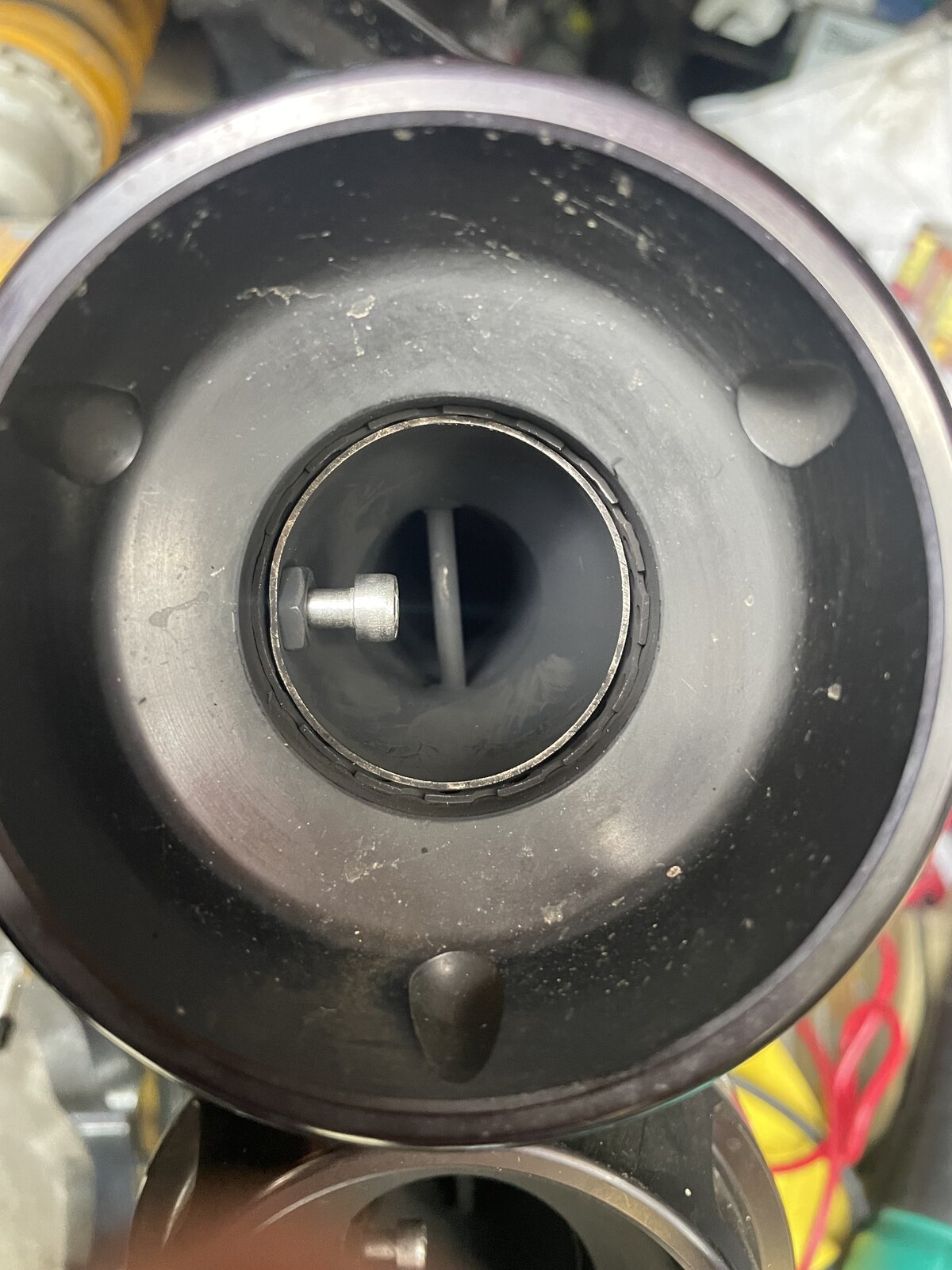

  1. I’m putting the baffles back in to my termis on my monster 1200r. How far in should the bolt go? Should I use some elbow grease to get them in further than how they are in the picture? They don’t seem to want to go further using fingers to tighten and I’m scared of damaging the pipes.
  2. Looks like there is no more thread to screw in, i.e. screw has a shank when one without may be needed
  3. This is the original - I just can’t remember how it looked when I got it.
  4. It’s unusual for the bolt to go in that way. Isn’t there a hole on the outside of the silencer straight through to fix the baffle in place?
