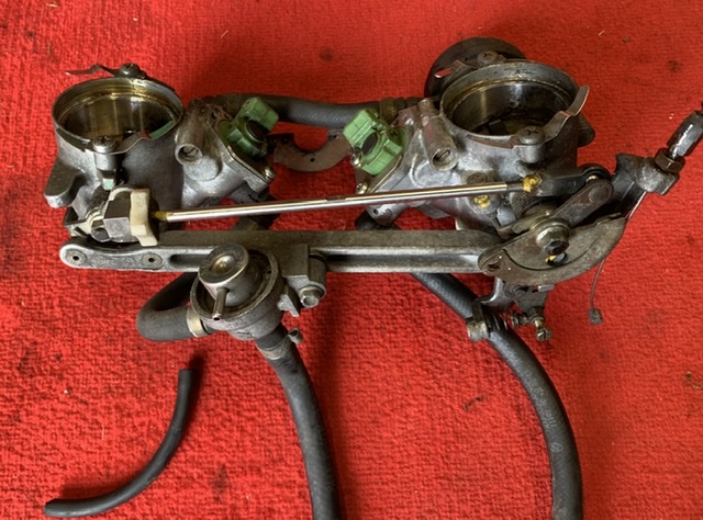

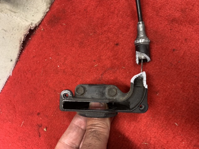

  11. 805821B0-AC42-4E4D-98D5-EBE32AF546AE.jpeg CD68B2E0-1B9A-4D51-9CCE-E10DFE1D8A09.jpeg Saturday morning update. I spoke to my Ducati Independent Specialist yesterday and he confirms the suggestions of still blocked injectors or a problem with the fuel pressure valve. Secondhand set of throttle bodies (with injectors) purchased from EBay and on their way to me. However I also had to source the throttle handlebar assembly as that snapped when trying to remove the throttle cable. Cable adjusters seized at both ends o_Oo_Oo_O

    One strange thing I found was a coil of wire inside the fuel hose going from the vertical cylinder injector to the fuel pressure valve :thinkingface: that gets pushed up the hose as the hose is attached to the fuel injector return outlet.
  15. The spring is 79911181B. No idea as to its purpose. Preventing pipe from kinking due to tight turn?
  16. Ah yes, that would explain it given the tight turn up to the fuel valve intake :upyeah:
  17. I second that.

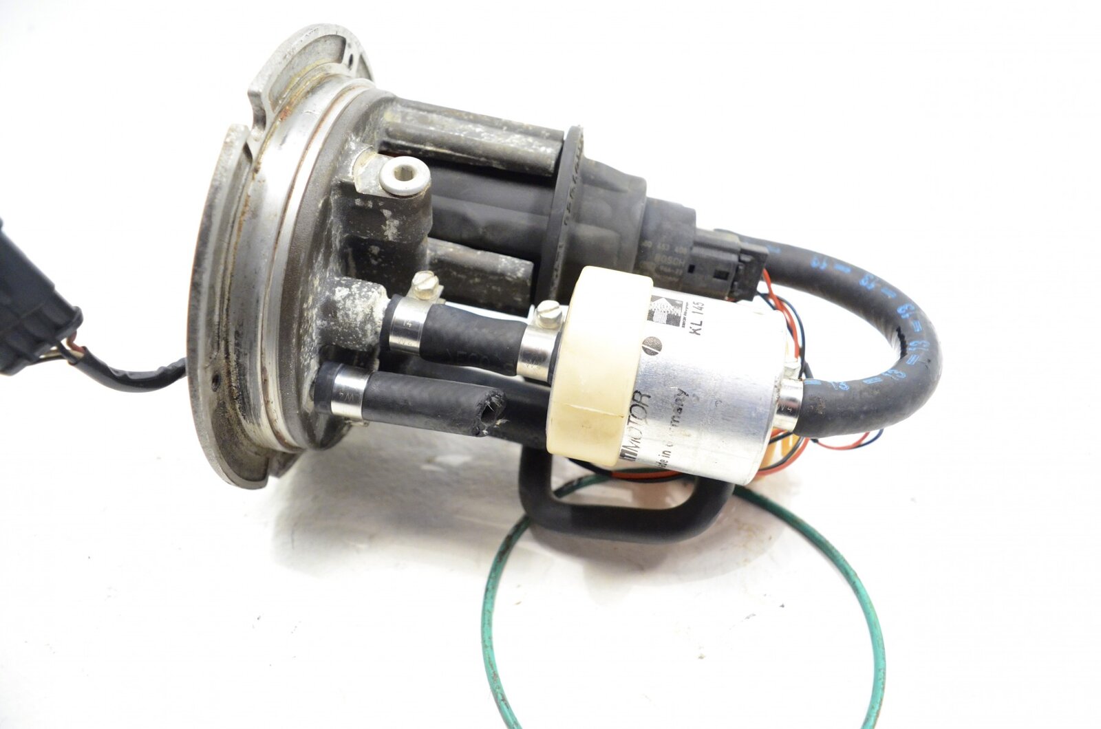

  18. I'm not sure I understand the difficulty? You do take the fuel pump assembly out from the bottom don't you? dsc_6010_13.jpg looks something like this.
  19. Unfortunately not on the Monster, it’s accessed via the fuel cap but I wish it was as simple as the 748/916 setup Where everything is easily accessed at the base of the petrol tank.
