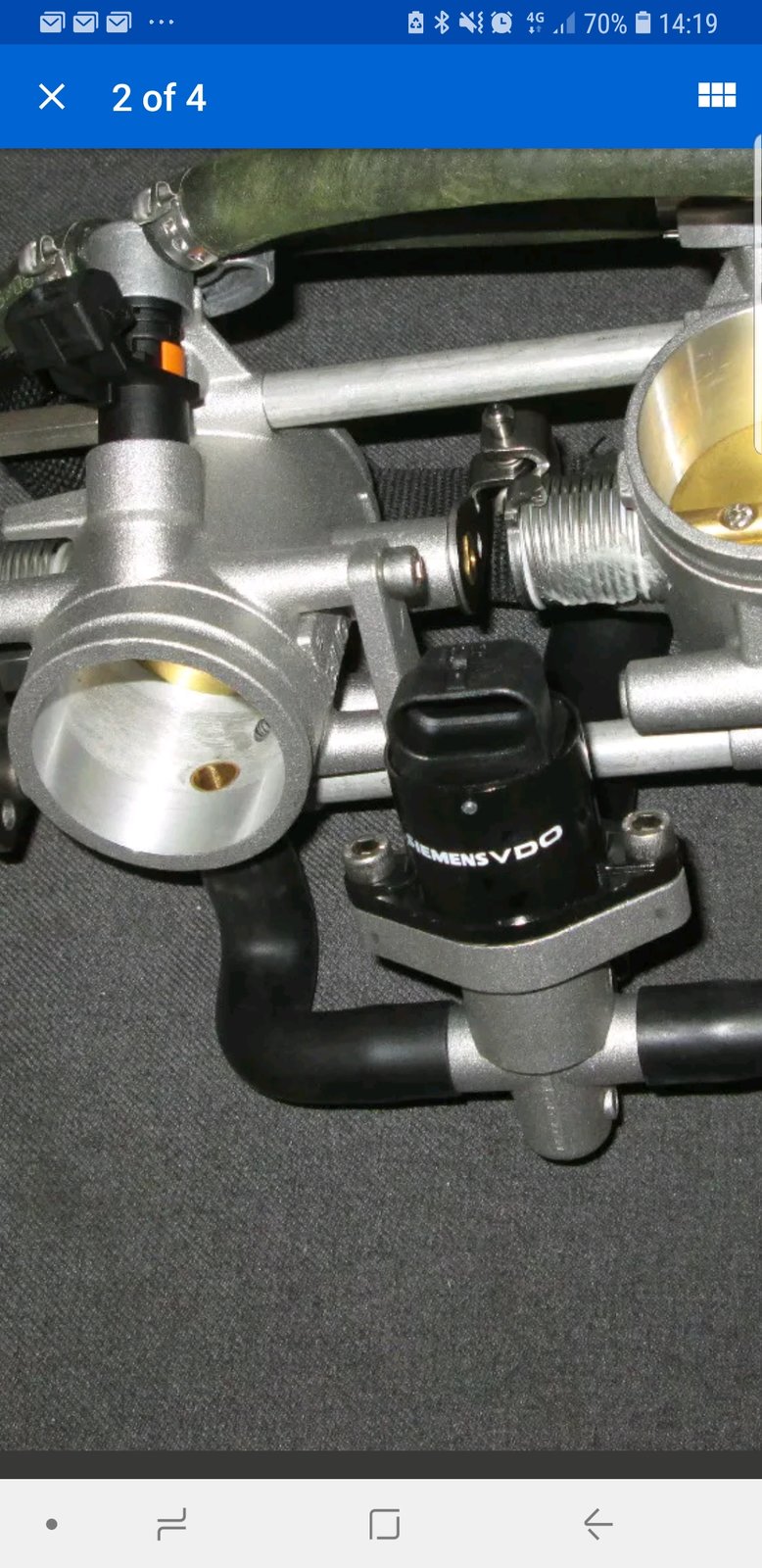

  6. Where is the icv,? I can't seem to locate it
  7. On the throttle body
  8. Is this is?
  9. Thanks Chris.
    Went to have a brief look and look like I'll need to remove the throttle bodies. Think its worth trying tho as it just a few hours of fun
