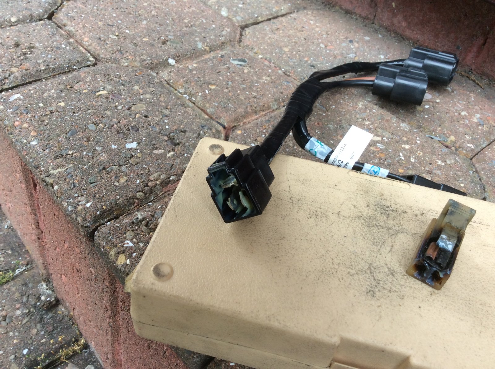

  1. IMG_0461.JPG Hi,
    I know this has been covered elsewhere but I thought some users contemplating upgrading to a mosfet regulator shindengen FH020AA might find it useful.
    Bike symptoms: Intermittent loss of idiot light and indicators. Switch off bike and all well for a variable period of time. Occasionally the eobd light comes on for a fraction of a second. Checking error codes using jpdiag shows voltage malfunction.
    Checks: console shows 14.2 volts so all looks fine.
    Rectifier diode check all okay and alternator checks look fine.
    Slight discolouration of 3 pin alternator connector so clean thoroughly.
    Put fairing on and all fine for around 600 miles. Smell burning and on inspection the 3 pin alternator connector fried. Rectifier check now shows one diode short.
    Decided to upgrade to mosfet device and thought I would give any user an idea of what's required.
    MOSFET FH020AA FROM USA AT AROUND £100
    Triumph cable harness mentioned in other posts £8
    Aluminium plate, spacers, high strength loctite and M6 screws.
    The loctite is for fixing the bolts that will secure the new rectifier with locking nuts without the bolt turning in the future if you try to remove.
    Please see pics for dimensions and bits required.
    Initial test : miles covered 100 at ambient 18 centigrade.
    Display shows 14.4 volts solid after several checks.
    Checked temperature by touching regulator through hole on fairing - Luke warm. To be honest more heat from ECU.
    NOTE: ECU SPACERS SHOULD MEASURE 12mm diameter by 6mm
    ECU FIXING SCREWS SHOULD BE M6 * 40mm.
    After fixing left hand fairing on the dimensions shown in the picture where to big causing fairing to rub off ECU and connector.
