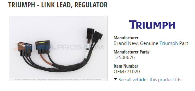

  2. Is thet just a plug and play type conversion?
  3. Pretty much. IIRC the new rec/reg had different mounting holes. Just drill two new ones, or use nutserts and all's good

  7. Mosfet regulator and Triumph conversion lead purchased today. :) Bikesport Developments bracket to be ordered tomorrow. :upyeah:
    Thanks to all for your help.
