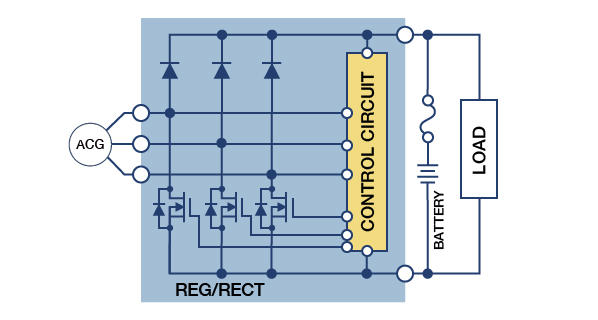

    The below is from Shingenden
    Three-Phase Short Regulator/Rectifier (FET)
    • [​IMG]
    These regulators/rectifiers use MOSFETs and Schottky barrier diodes for the ACG output control elements to produce a synchronous rectification and achieve low-loss and large current. These three-phase short regulators/rectifiers can control up to high generator frequencies.
