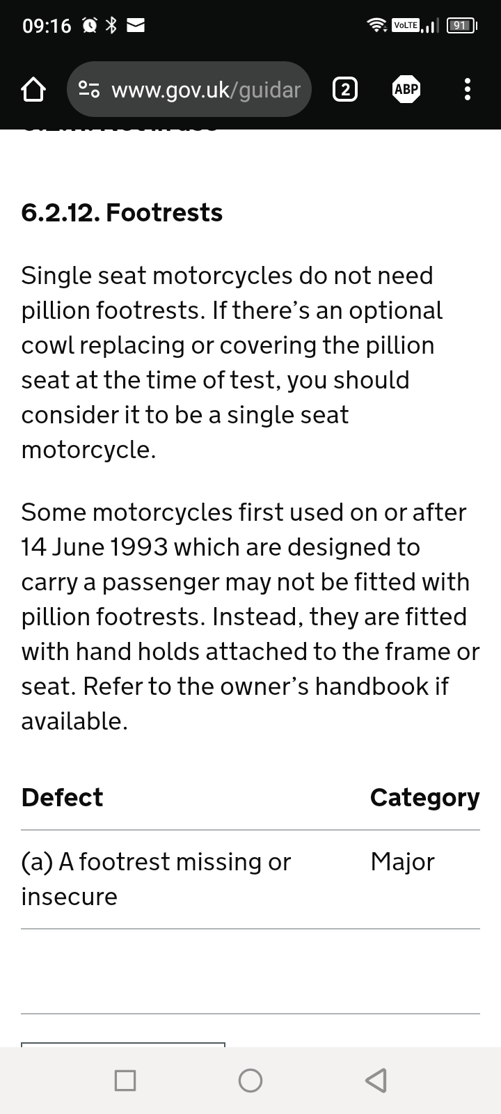

  6. It will pass. The rules are crystal clear. Here's a screen shot.
  7. It will pass. MOT’d my 1198 with footrests removed and the seat cowl fitted (single seat) with no problems.
  8. You need foot pegs for each seat. One seat means one set.
    I've Mot'd many bikes without pillion seats & pillion foot pegs and never had a problem.
  9. It’s fine. Pass.
  10. Mine passed fine.
  11. Yep it’s a pass, I don’t even have them for my 899, has a single seat cowl fitted.
