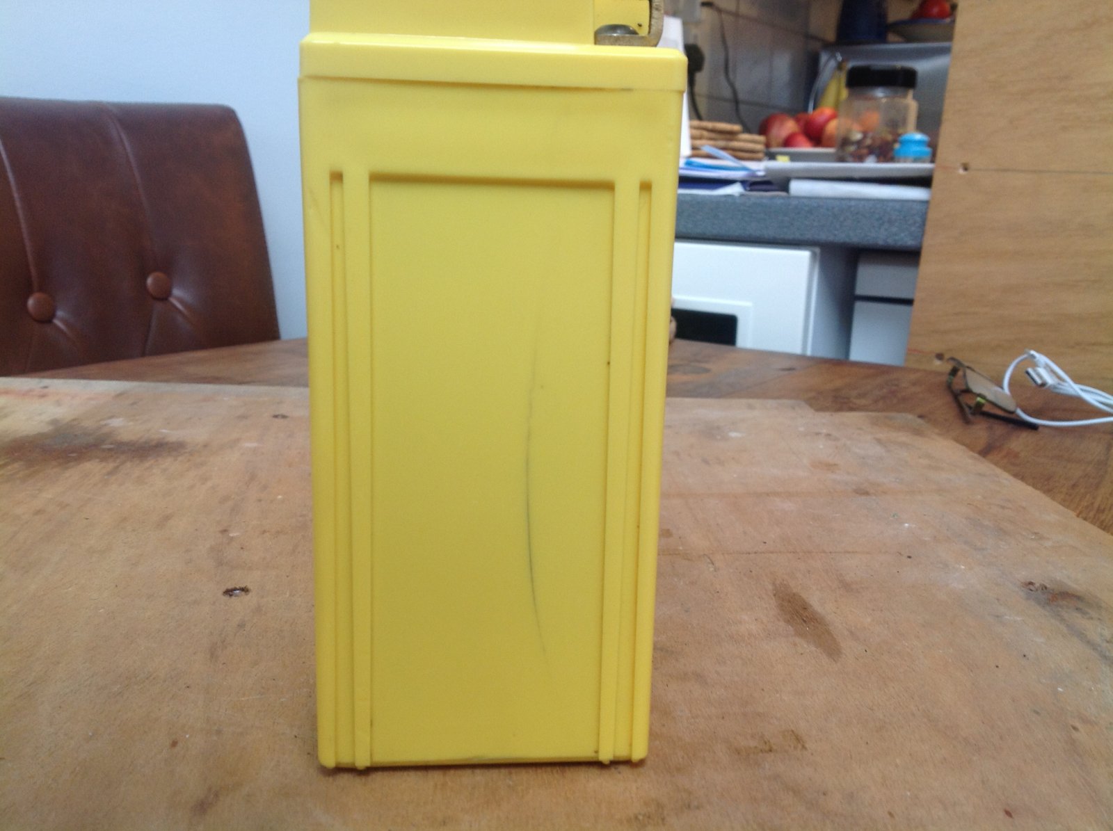

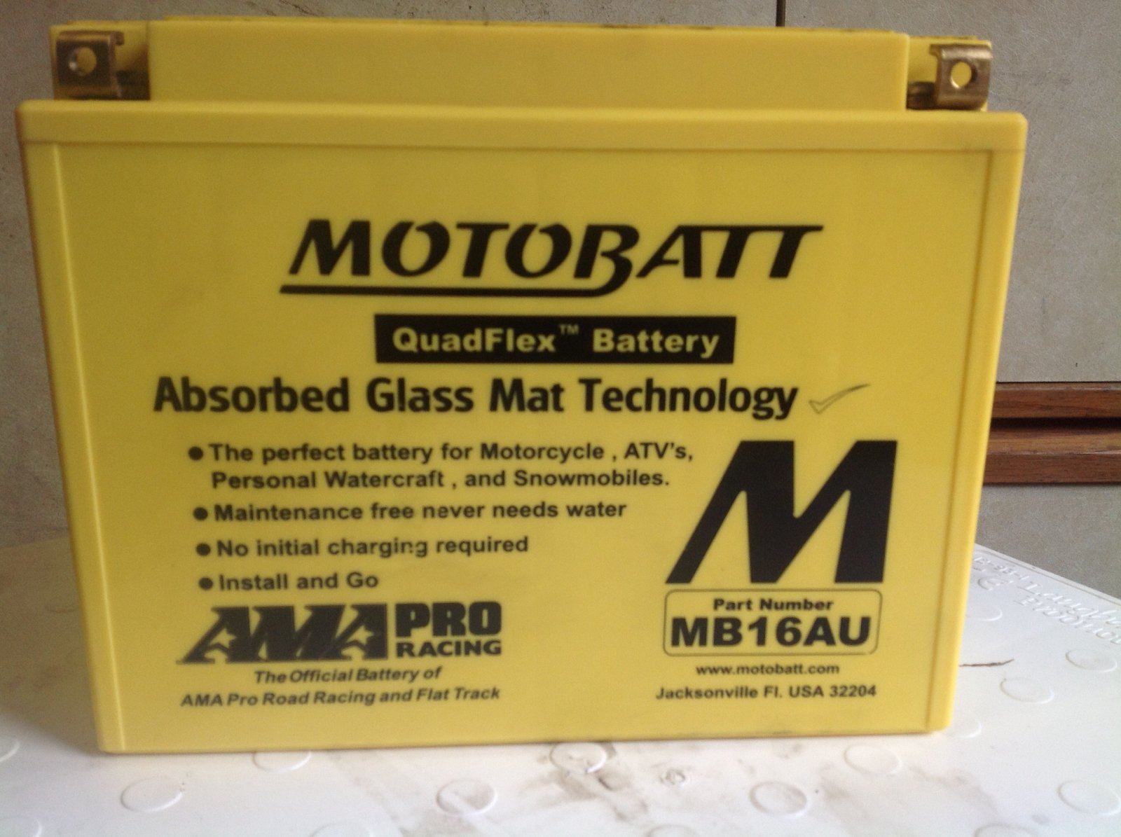

  1. Has anyone on the forum had any experience with motobatt batteries? I fitted one to my 748 at the same time has fitting a new mosfet reg/ rec plus the upgraded starter cables from Exige. Anyway I went out for a good ride,a couple of weeks ago, put the bike back in the garage. A few days later I went to look at the bike, as you do. I noticed some marks or stains on the rear wheel paint. The stains won't rub off so I took the right side fairing off and there was some marks on the crankcase cover paint, I rubbed these and it looked like acid corrosion ( only small marks but enough to piss me off) I took the battery off to inspect it closely and found an airline crack in the end of it. The battery is still under warranty so I rang the supplier, and he told me to message them through eBay,which is how I ordered it. I explained the situation to them plus some photos. I got the reply back that because these batteries are glass mat technology that there is no free liquid acid in to do this sort of damage. " you could cut one of these batteries in half and not get any acid from it " was one of the remarks. I bought this type of battery exactly for the fact they are sealed, but I think they are spinning me a yarn to get out of replacing the faulty battery. Anyone had any similar experiences.

  4. Hi Chris thanks for the quick reply, I did the same search, and there must be enough free acid in there to do damage. The staining on the rear wheel doesn't look like its eaten through the paint to the alloy because I use WD40 on most of the surfaces on the bike. But the small bits of corrosion on the crankcase cover have gone through to the metal.

  11. Dogrose, all agm batteries have to be filled with acid (either by you or supplied already filled) and not all of it sits inside the absorbent glass matt, you get a few ccs sitting in the bottom of the case as the battery has to be slightly over filled to ensure the plates are fully covered with the battery in vertical or horizontal positions. Having cooked a Yuasa agm battery on my 748 when the reg failed to 19v output it melted a hole in the case releasing a few ccs of acid over the frame and swinging arm. I have also have the little dark brown indelible spots staining the frame and some acid damage to the battery box as a result of the fluid leakage - just as well it was not a conventional battery. If you want I can send you a photo of the paint damage which is annoying but not significant. Only clue to its failure was a slight eggy smell when the case burst through at the bottom of the cell closest to the horizontal exhaust. BTW The reg failure is the reason why I would never fit a li ion battery on an old bike like the 748, that reg failure condition could have caused the battery to run away and explode in flames.
    "..... because these batteries are glass mat technology there is no free liquid acid in to do this sort of damage, you could cut one of these batteries in half and not get any acid from it " Is utter bollox, perhaps they should demonstrate it, they will claim it is a gel battery next. Pretty sure Motobat will not be so silly with their after sales response. FWIW I just replaced my 999 one with a Yuasa, the Motobat was 4 years old and had done 2,000 miles so not that bad for age but for the last 12 months since I bought the bike the battery was on its last legs and I could not leave the bike without charging it for more than 4-5days. The Yuasa on the 748 died at 7 years with no discernible decay until the reg failed, if maintained properly the Yuasa will outlast pretty much all the others. The reason Halfords sell them for cars as their premium battery is not an accident.

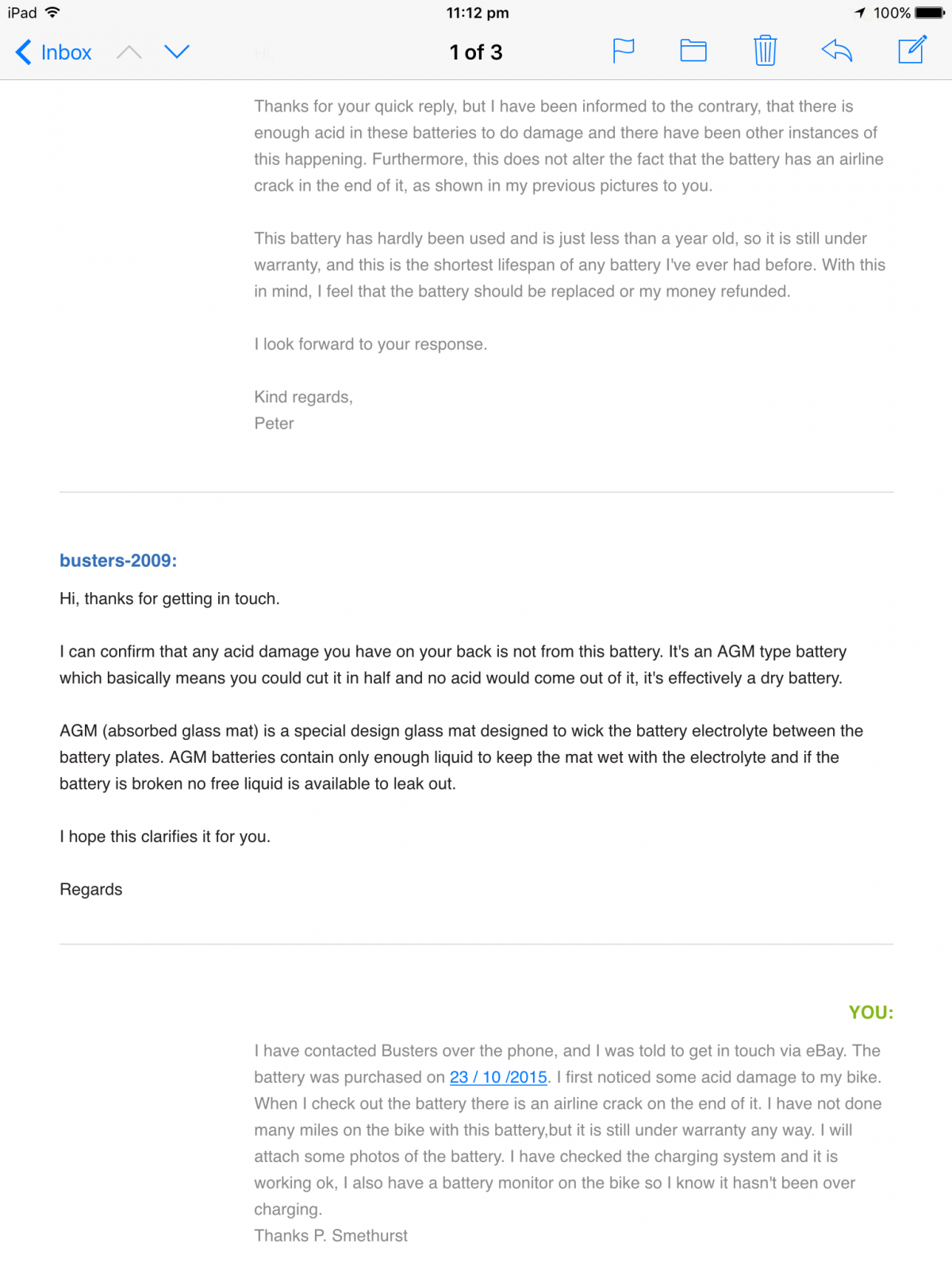

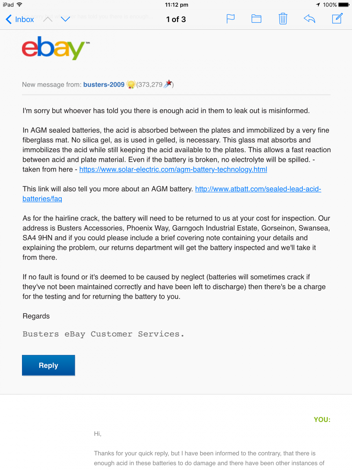

  19. image.png image.png This is some of the correspondence between me an busters.Sorry don't know how else to post this,so I just took a screenshot.
