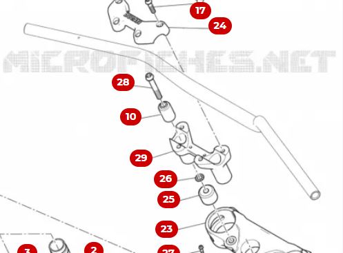

  1. Next job was to investigate why the Handlebars felt loose, and why I could feel a knock when moving the bike around.
    I realised that the Handlebar mount bolted down to the top yoke was moving about, and knocking as the slack in whatever was worn or loose was taken up.
    Looking at the parts diagrams online there appears to be a difference between the Enduro and other 1200/1260 Multistradas.
    The Enduro has a spacer under the mount to raise the bars a little.
    Interestingly the Bolt, parts 15 and 28 in the images below is listed as the same part number for both.
    That must be a mistake, as the bolt would need to be longer for the Enduro:
    I was thinking perhaps the Rubber vibration dampers, 10 or 25 above, had worn out so decided to take the clamp off the top yoke.

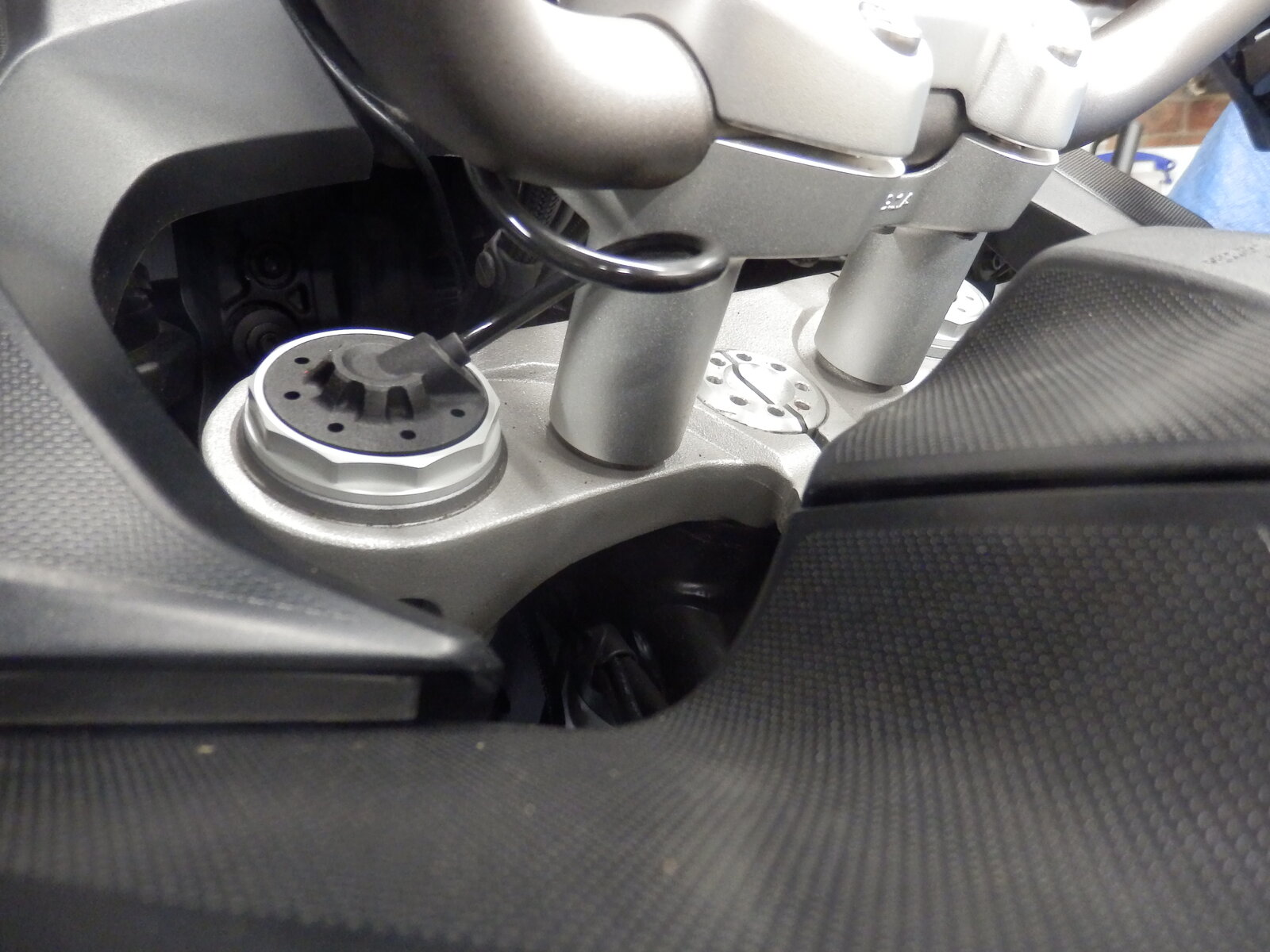

  2. The first thing I realised was that either my bike came out of the factory with no spacers, or more likely somebody has removed them to lower the handlebars a little:

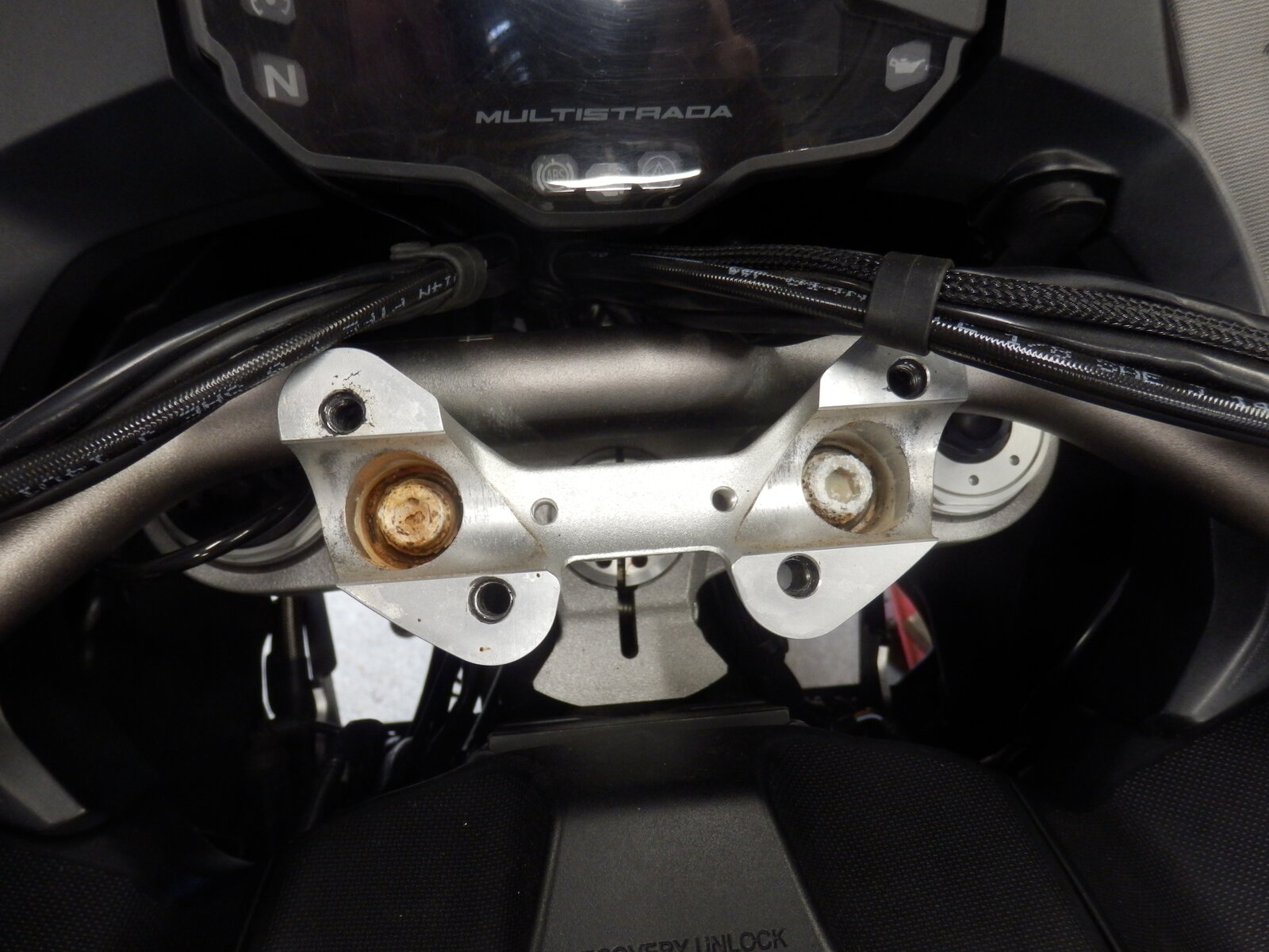

    With the top clamp and Handlebars out of the way I was a little shocked to find this:
    At this point I thought I was going to have a hell of a job getting those out, so filled the holes with my favorite mixture of Diesel and Brake cleaner and went off to brew up.
    When I came back I thought "well here goes" and tried both with an Allen key.
    To my delight both were actually completely loose, very loose, not tight at all, which explained why the Handlebars felt loose, but one was bent as it wobbled about as it was wound out.
    Unfortunately they have an M10 fine pitch thread and I didn't have replacements available, so I cleaned everything up, straightened the bent bolt as best I could and put it all back together.
    I'm pleased to say all the looseness has gone, but it will all need to come apart again as I'll order some replacement bolts in Stainless.
  3. The Enduro had a spacer underneath as I bought some to raise the bars on my 1260. I think there are a couple of versions, one was the standard one (15mm?) and there was a lower version (10mm?). They were pretty cheap to buy from Ducati.
  4. Thanks @Twin4me, I assume you had to have new longer bolts too.
    I'm happy with the bars at the height they are, so won't be reinstating the spacers that should be there.
  5. Pretty sure they came with the new bolts in the kit.
    Now I think about it I’m sure one type were to lower the Enduro bars from standard (or the alternative I used them for was to raise the 1260 bars)

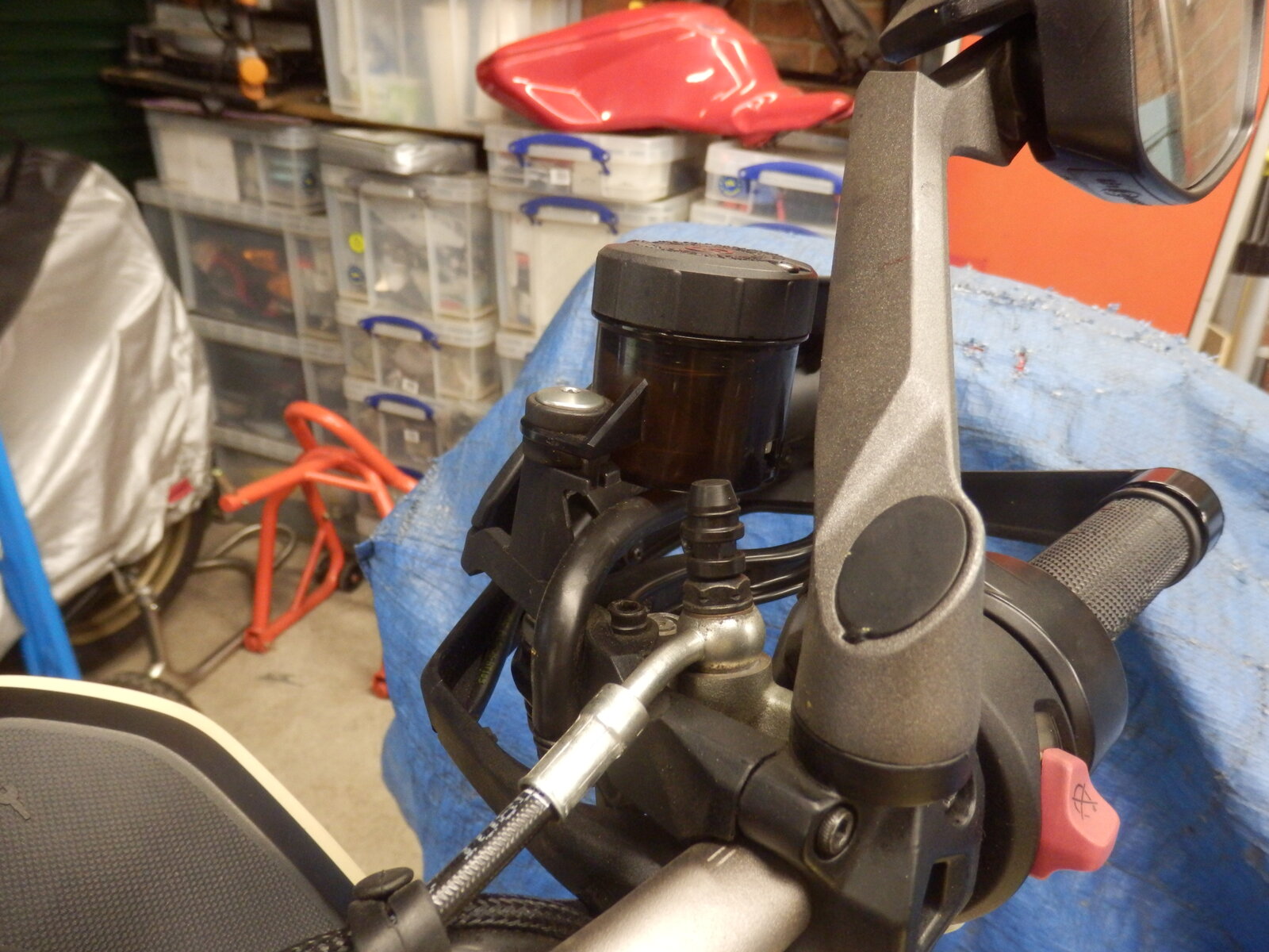

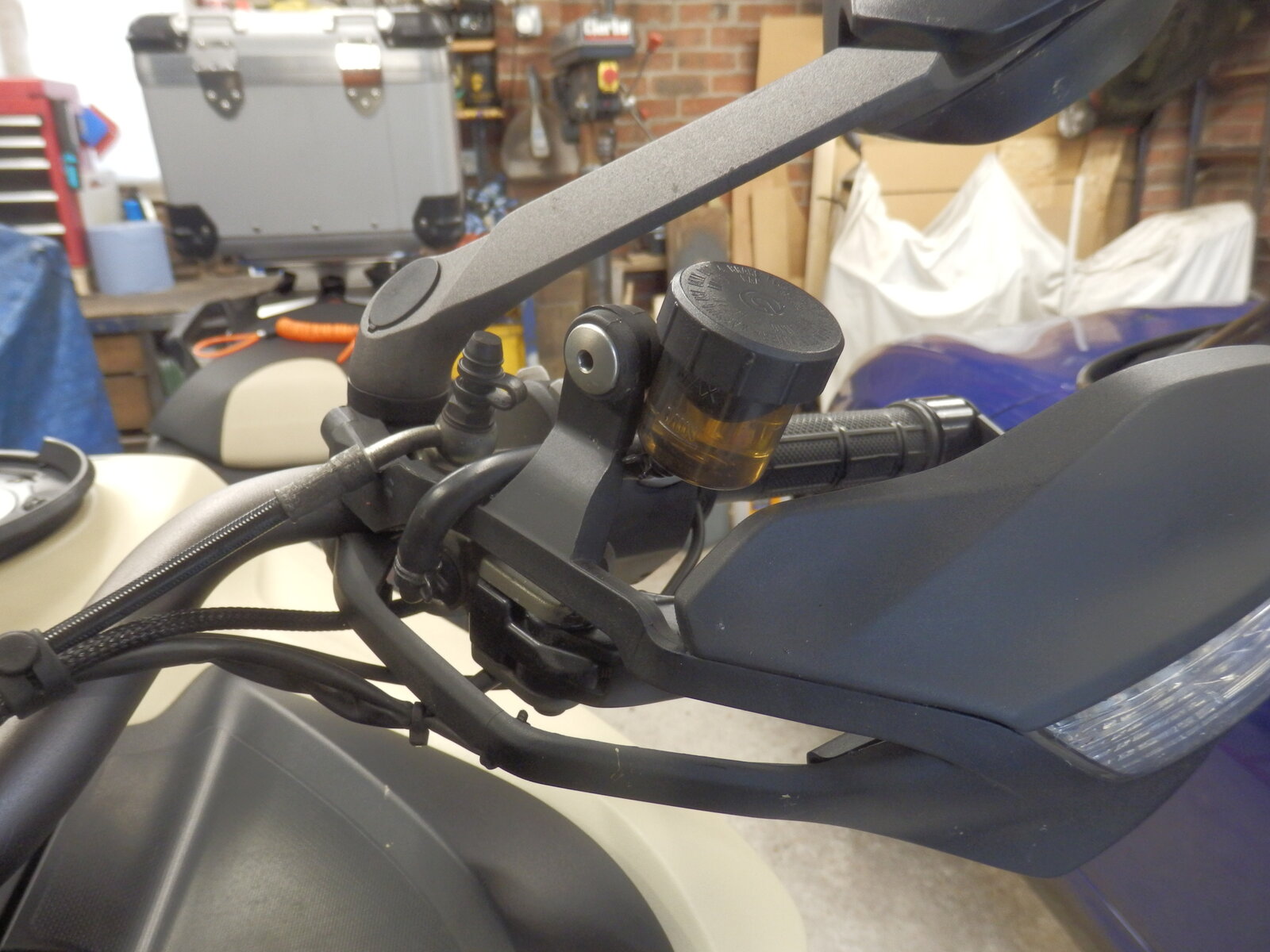

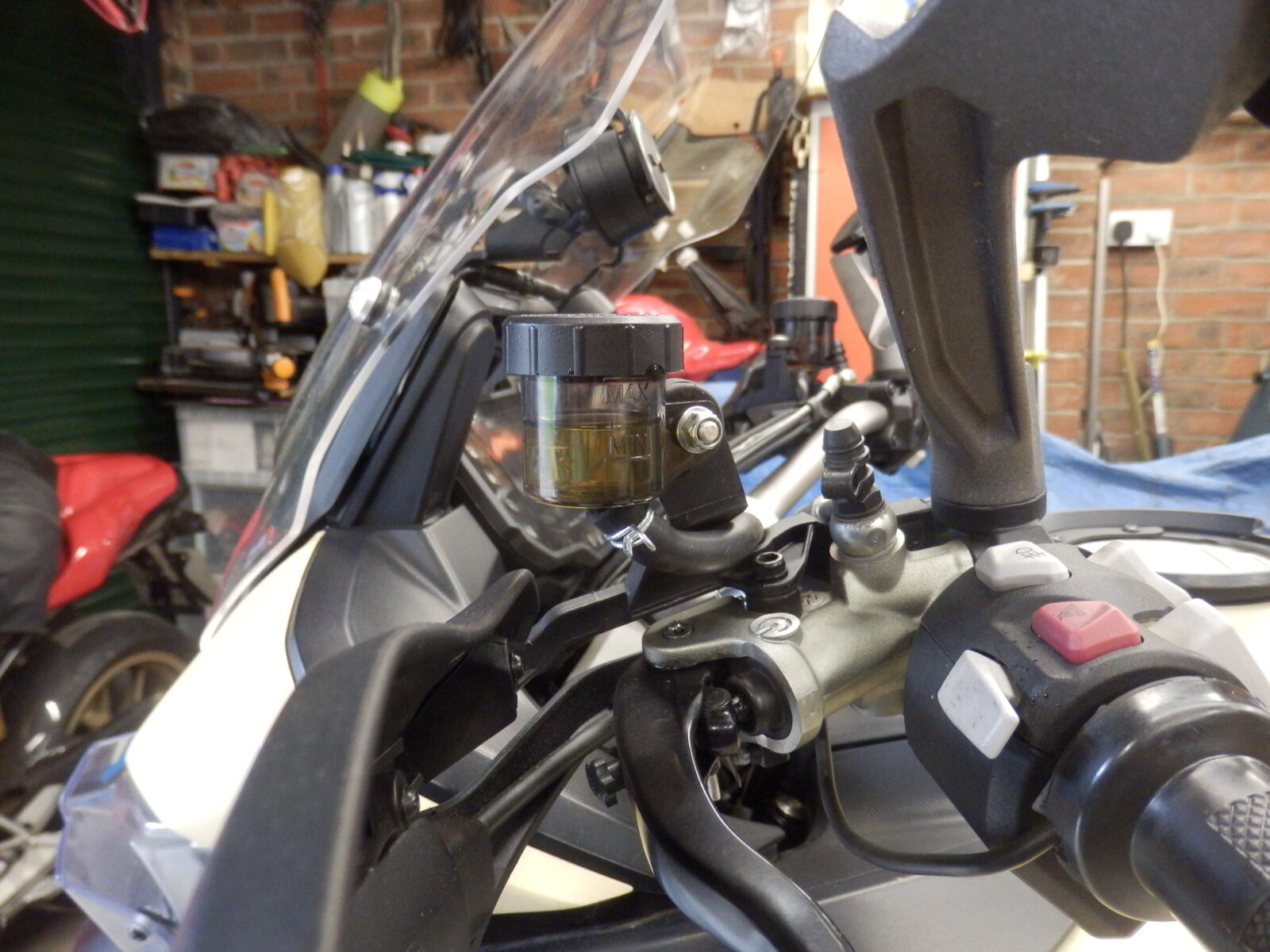

  9. Do 'we' think these are aftermarket reservoirs:
    They look like it to me.
    The Clutch one was really bothering me, it was at that angle because the tube to it was too short.
    I really can't understand the mentality of somebody who fits an aftermarket part and is happy to accept it fitting like that.
    It obviously effects the level of fluid in there, and just looks so wrong.
    I fitted a longer bit of hose today and am much happier with it:
  10. Nope, those are OEM. I found the angled clutch reservoir annoying too, for an easy life I've learnt to live with it though.
