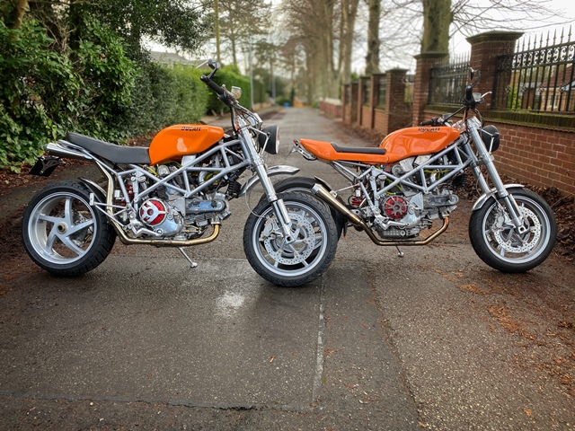

  4. Well here are both bikes... ready for spring...

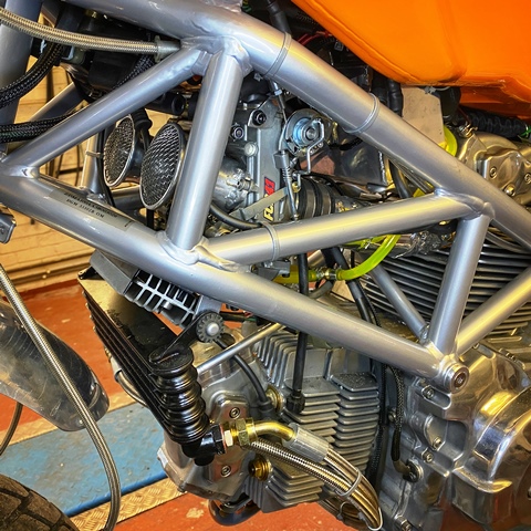

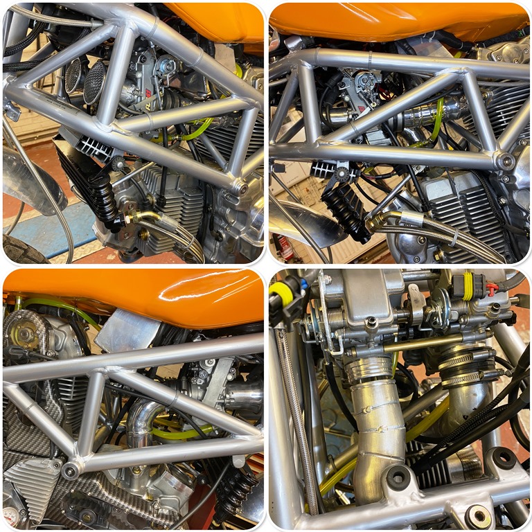

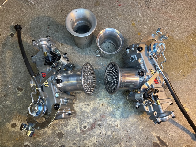

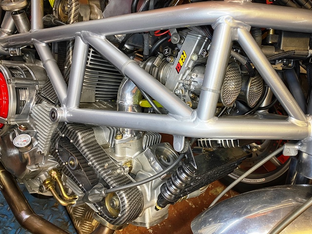

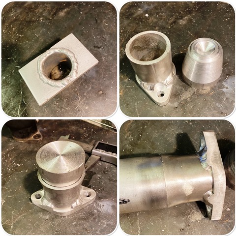

  10. A couple of things were bugging me about this build… one was the inlet manifold where I had used the original rubber manifolds, they looked out of place, and gave to much movement on the carbs. I decided to re-make the manifolds. they are a bit difficult as the carbs are bigger than the port, so I had to expand some alloy tube a bit with a tapered mandrel.

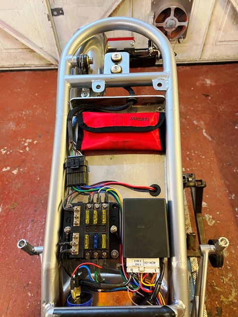

    The other thing was the foam filters… I really wanted bell mouths, but as the carbs were forward facing it was to risky to have big open, sucking carbs… So I decided to make some bell mouths with mesh… they came out well! I have also tidied up the under seat area.

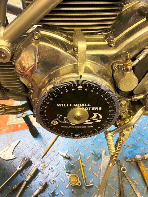

    Finally, I set the timing accurately it was out by 2 degrees cylinder to cylinder, probably do to me getting the positioning of the hall sensors slightly out. Its easy to correct for that in the ignitech software though.

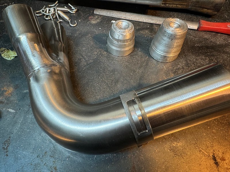

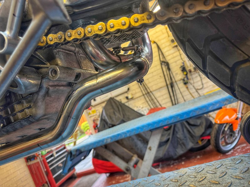

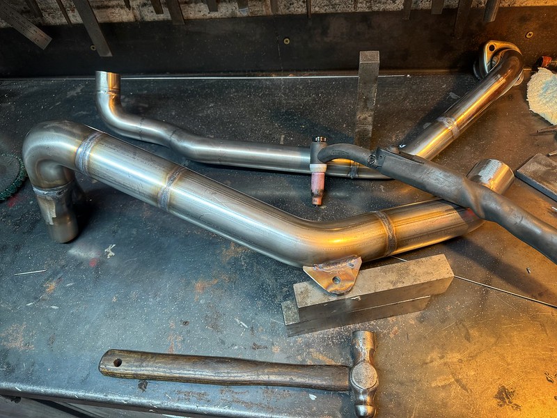

    However, I never liked the way the exhaust looked... so out came the welder and I made another... I am not keen on lobster cut bends so I have used some stainless mandrel bends, which are quite cheap and come in many angles. A tip when making exhausts is to temporarily hold things together with Jubilee clips, and if you slot a couple, you can tack through the slot which keeps things nicely aligned :D
