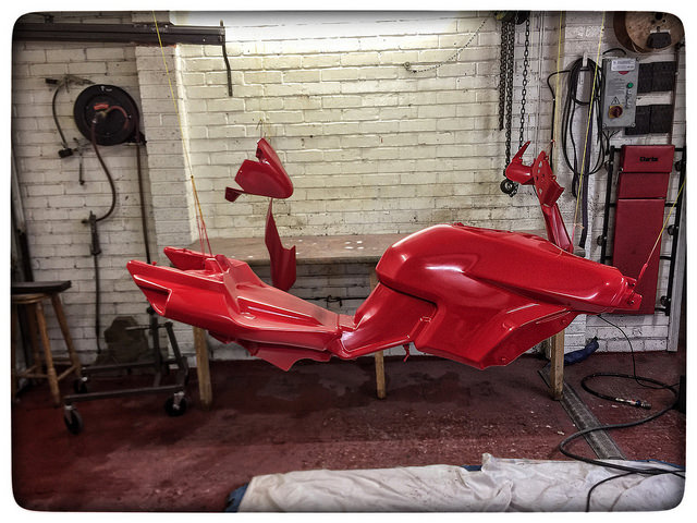

  9. Well I decided on red and carbon... started the paintwork, and finished the hydrographic dipping of the parts I want the carbon look on.
    I pondered a long time how to finish the ends of the tank where the fairing used to connect. I sat down with some cardboard and tried to cut and fabricate a shape that I could transfer to aluminium so I could weld it up. the shape I wanted was just too complicated. Then I hit on the idea of using body filler… I made a brass bush to sit in the filler, then covered the end of the tank in aluminium foil, and slapped the filler on! once sanded to shape I hydrographic dipped them in carbon fibre film. They came out rather well!

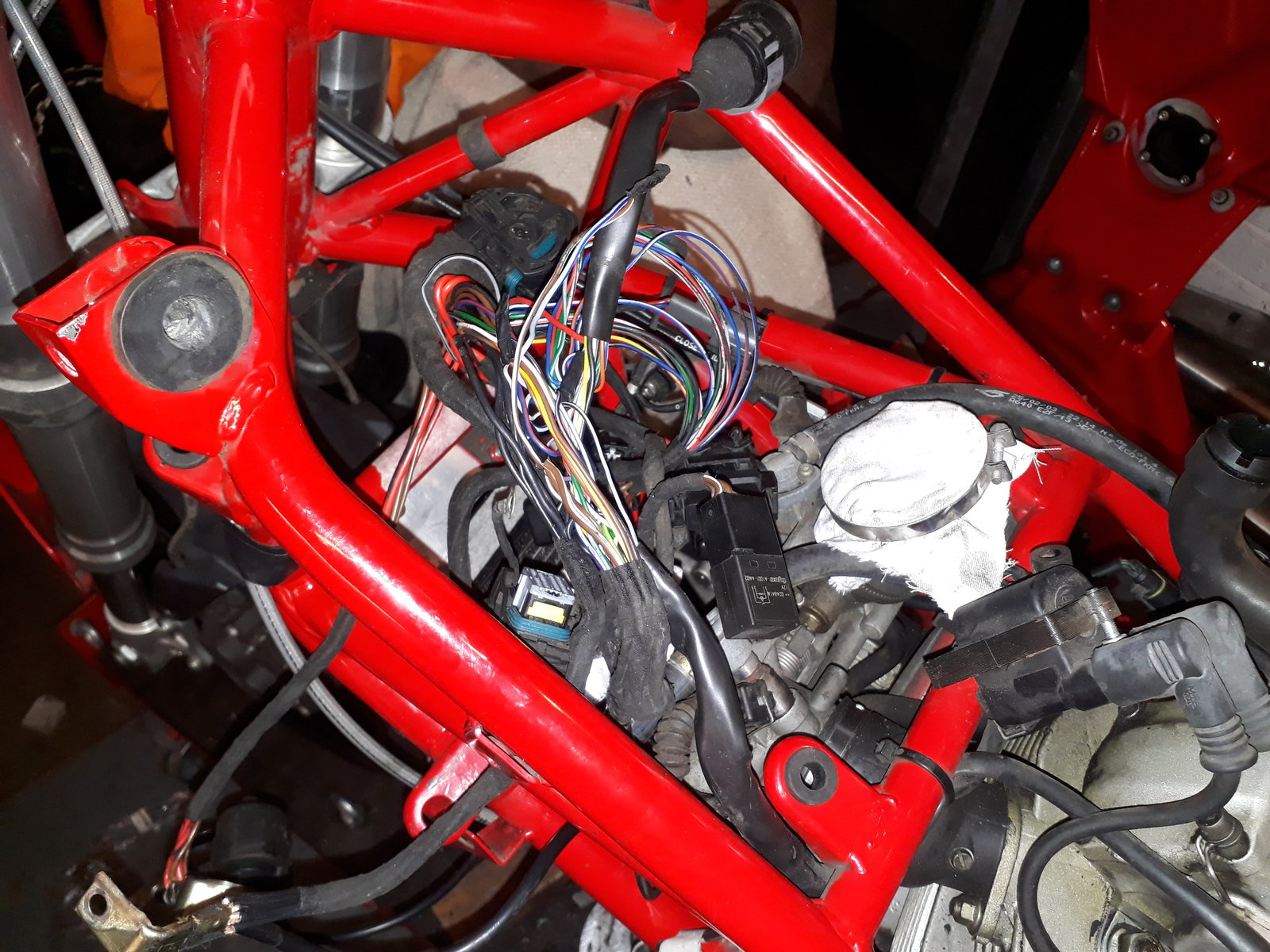

  10. Some impressive work there Buzzer... I'm in the early stages of a similar de-uglification project with my 03 1000ds... You are clearly a talented mechanical engineer I'm OK with mechanicals but in the multi electrical system, I've opened myself up a massive can of worms that I know nowt about. I had hoped to relocate some major components, ECU etc into the airbox and make room by removing the filter and fitting pods... Now that I've actually got to this stage, I think it would be easier to wrestle a bucket full of eels into it!

  12. Hi Colin. I looked long and hard about getting all the electrics in the air box area, and decided that doing that would still require a lot of rewire work so i made the decision to put everything under the seat area. Re the wiring... many years ago i helped a guy who repaired alarm systems... we went to a factory where there was a 36 zone system. That was probably 40 odd wires each with 6 coloured strands! The box was like a rats nest! He taught me to break it down and look at each zone at a time. It then actually becomes much more simple.
    Its a bit like that on a bike... if you look at the wiring diagram its just components connected with wires. If you break it down, component at a time, its not so daunting.
    What i did was blow the diagram up to A1 size which makes it much easier to follow. I then mounted the components like the fuse box, Ecu, battery, relays, on a plate under the seat. I then extended the wires to reach them! I acually used the same pink wire, rather than buy all the different colours in the loom. If you cut the wires, be sure to step the joins so they dont fret together, and also you dont end up with a thick section in the loom.
    To join wires i use heat shrink and solder. Be sure to use a quality fluxed solder which is for electronic use, this is important as you dont want to use a corrosive flux. Solder the join, slide over the heat shrink, and apply a little heat and you have a good join. I like the heat shrink with glue in it, it makes a nice water tight joint. Tick off each wire on the diagram as you do it. Its time consuming though!

    I've also removed the under-seat exhaust and managed to fit a big bore shorty Delkevic can using the cut down original link pipe, so it would make sense for me to do the same as you and use the space for the sparks. There's two bling upward facing M8 lugs on the frame here, did you drill &tap through these to mount the box? I had planned to at least put the battery here, but now the whole lot will be going in! Also, did you use the stock battery? I was looking at lithium ion types but whilst these are much lighter the one I found was the same size as the original.
